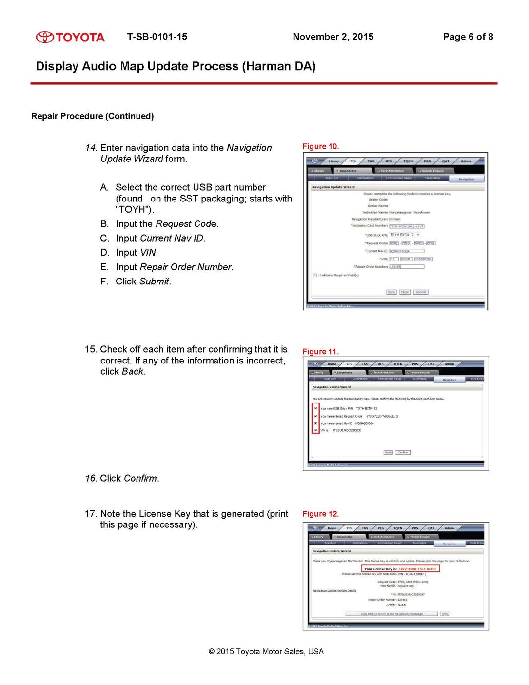

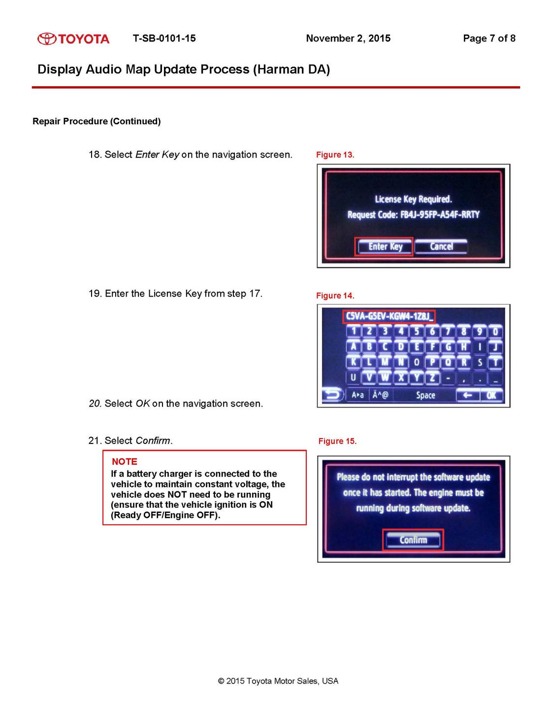

My system (Entune 8 speaker non JBL) can't be updated via DVD, nor does it have a micro SD card slot. Maps can only be updated via USB........ [MENTION=83083]rigtec[/MENTION] I think we're in the same boat.
Toyota installation instructions;
