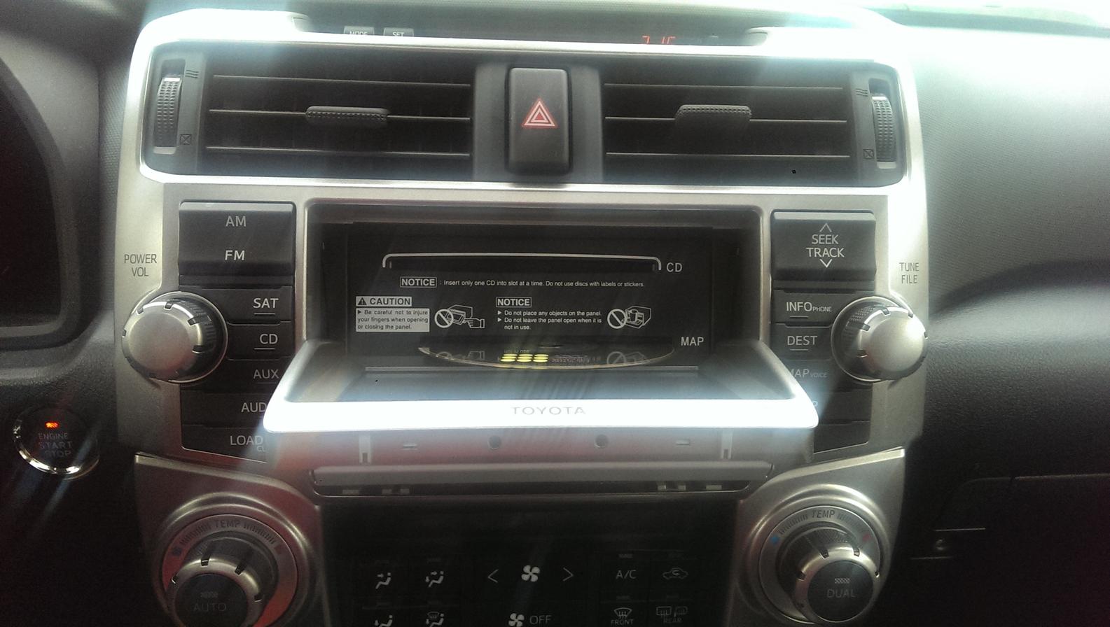

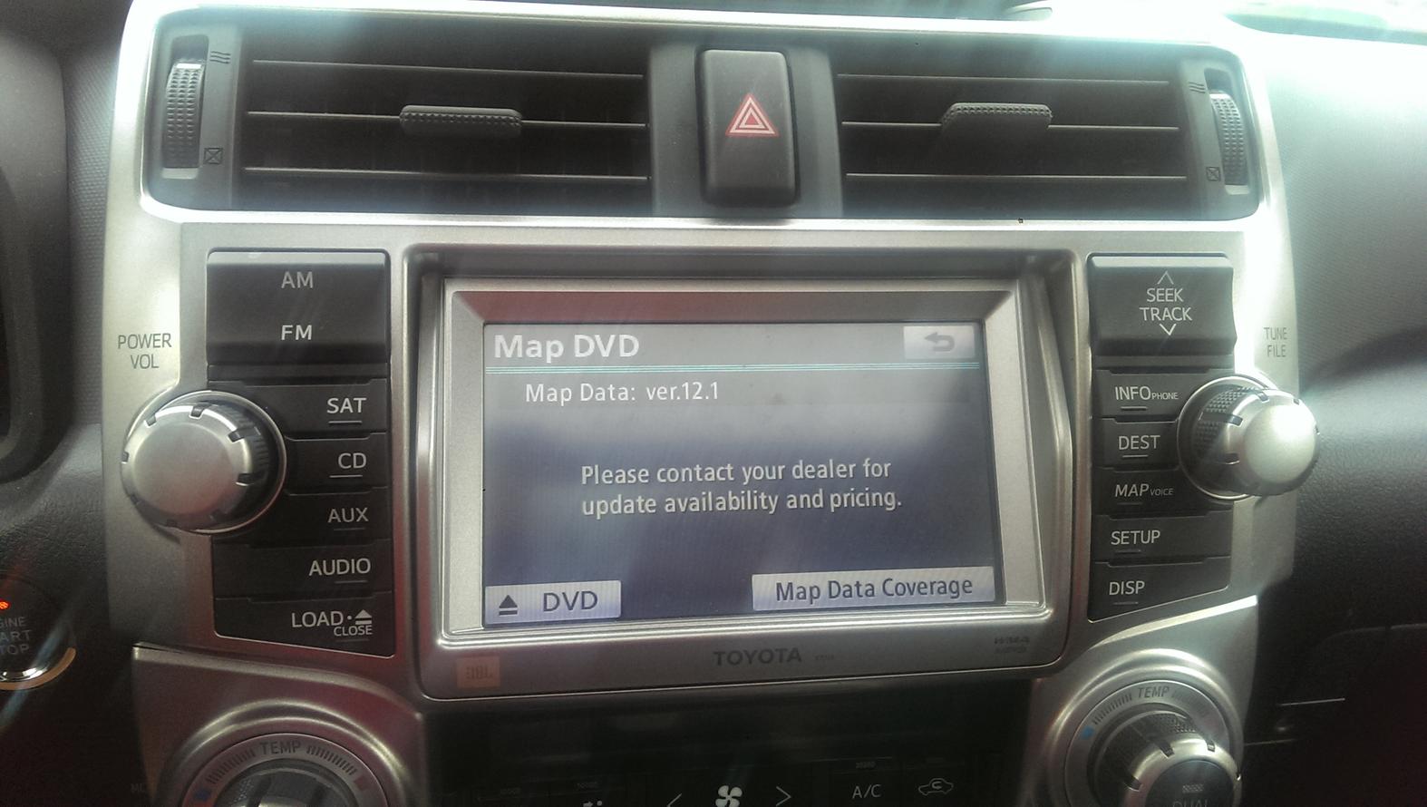

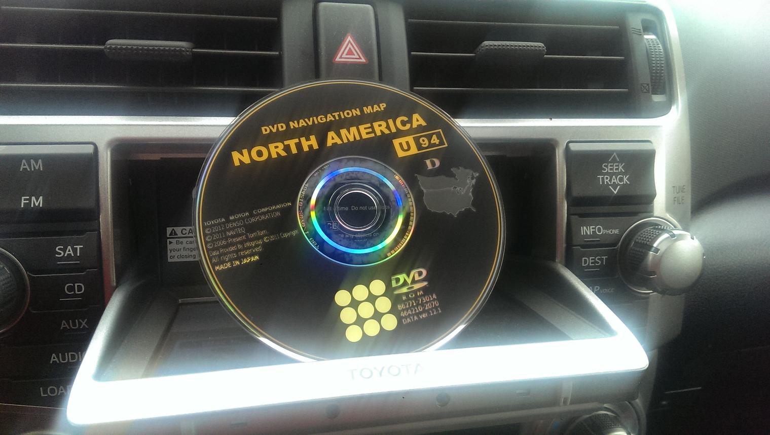

2013 Limited with Gen 6 nav disc
Alright I don't know if this has been covered but I am just going to put it here anyways. According to JA's website my 2013 is Gen 7 (uses micro SD card) 12.1. However, I don't have a slot for a microSD anywhere. So, I think it is safe for me to say that my truck is an exception on JA's website as it is not Entune and is part of the JBL package. Also, my 2013 currently has a map DVD inserted version 12.1.
I am about to buy the latest Gen 6 disc off of JA's website but I wanted to be certain that I am purchasing the correct disc.
It should be noted that I have a Limited edition from Canada, if that makes any difference.
Also please don't roast me too hard for the crappy cell phone pics below, i have dropped my phone too many times that i have ruined the lens.
