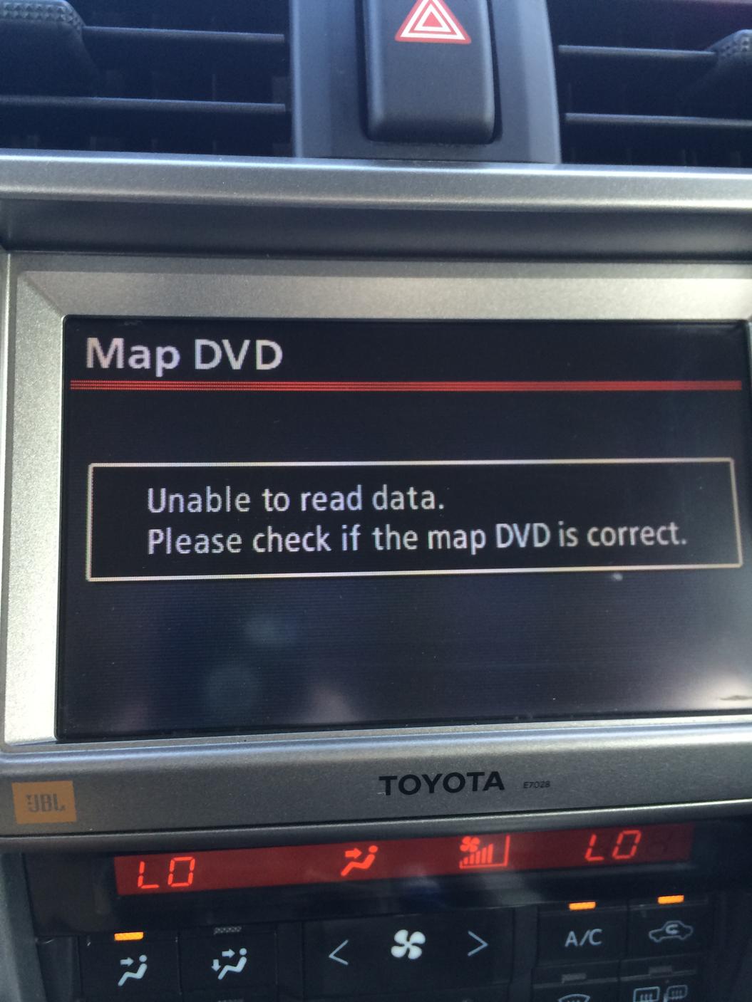

Morning all. My nav started saying, "unable to read data. Please check if the map DVD is correct".Has anyone else experienced this? Disc is perfectly clean and only has been ejected once I saw this warning.
Error
Here is the error that it is reading. It will not allow me to go into the setup screen or anything.

That same messages flashes on my unit but goes away after a few seconds and the GPS DVD begins to load...it has done it with both the original GPS DVD and the pirated GEN 6 disc i currently have loaded.
Sorry, have had my 2010 Limited since it came out and have never received that error. I did upgrade my nav dvd last year though.
Unfortunately this is a quirk of Toyota's Navigation system. Not entirely sure why they designed it like this, but they did.
When the Navigation Head Unit loads up, if is unable to read the disc (be it the disc being bad or the head unit being bad) it will not load into any other function until the disc read error is corrected; which in my opinion was a poor programming choice on Toyota's part.
Unfortunately the bad new doesn't stop there, a lot of times we've seen that it's either the disc or the head unit. I would see if you can make a DvD from your current gen map software (for diagnostic purposes I would try not to use an updated disc as they overwrite the data on the head unit and won't want to use older discs in a lot of our systems) this way you can rule out the DvD being the issue.
If you can't get one or make one, you can try sticking a plain music CD in the map slot and starting the vehicle up. The error should change to something along the lines of "incorrect format," this way you can see whether or not the head unit is even looking at the disc. I've had a few dead units that didn't even bother responding with a different disc or CD and we had to replace the entire unit.

It is at the dealer now. Hopefully it is just the disc or something. Now I have lost all controls, no audio, no maps, no phone, and the screen is blank. Can't wait to find out the bill on this one.
Bump
Just heard back. Dealer said unit went bad, $3,100 to replace. Another dealer quoted me $2,300.
