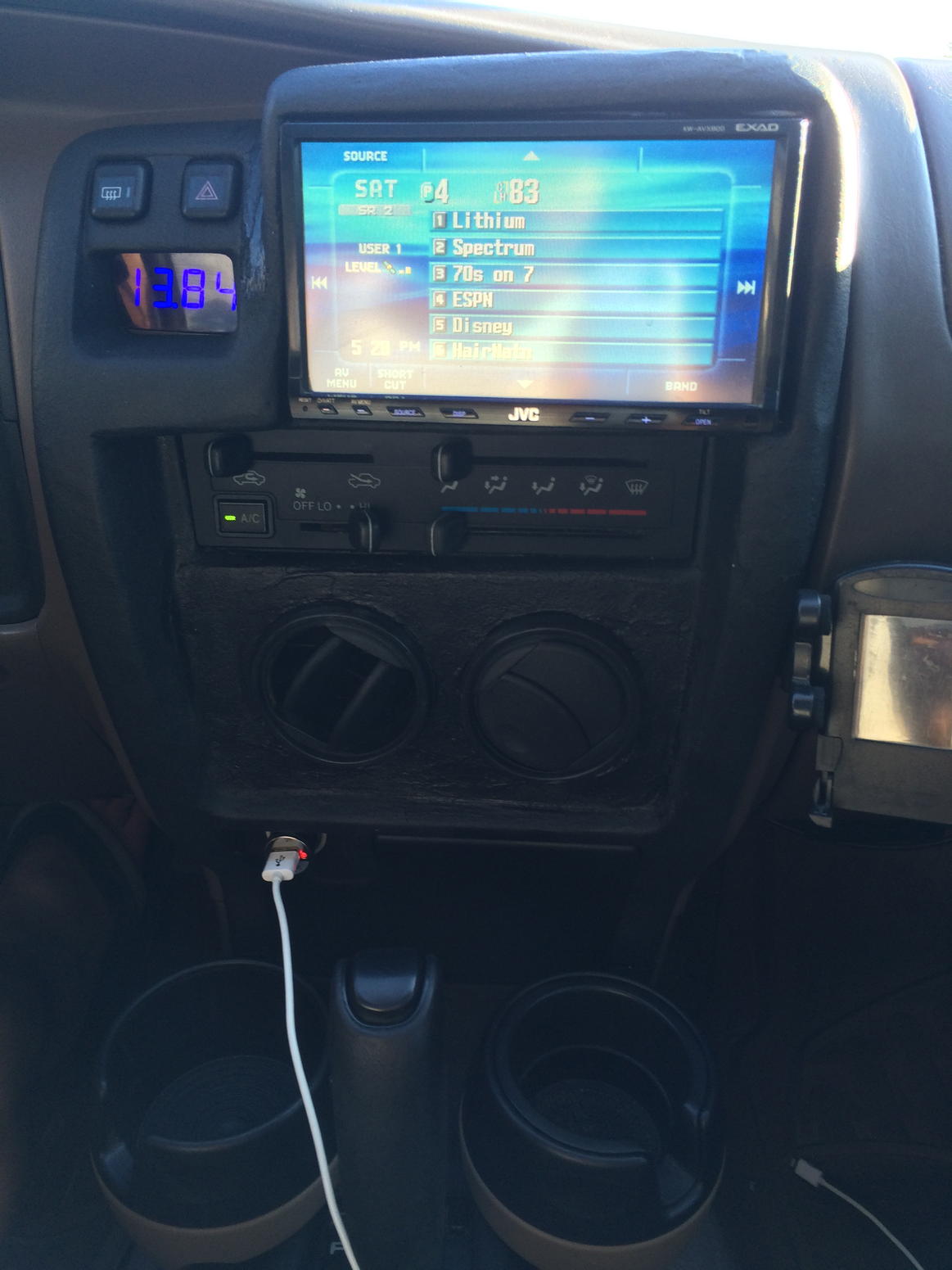

I too am interested how you held the head unit securely? One of the biggest reason I never did this.

Ahh, I used a small "L" bracket from the side of the radio down to the bottom plate of plastic that lines the place where the cup holder used to be just under the hazard ad defrost buttons. Had to trim the plastic plate a bit with my Dremel to make it nice and flat. Also rested the sheet metal radio box I made on the plastic piece too. Even if the "L' bracket was not there I don't think it would slide out. I made the hole pretty snug with the bondo.
EDIT: I am not really sure how the guy did it with the 99 and up bezel. There is a metal bar that the old A/C duct mounts to just behind where the "new" radio spot is. He must have utilized that some how to hold it in place.

Finally had some time to get the Toyota Matrix vents installed. Done for now. I will eventually do one more coat of bed liner spray just to even out the top finish around the vents. Made a bit of a mess touching up the paint after trimming the holes. Its not quite as pretty as the other one in this thread, but I am very happy with my results. And so much more user friendly.

Dgoll75 I think you did a great job! Yeah you could work on your finish work, but the actual mod is awesome!! Gets the radio/GPS up where you can see it and actually use it. Congrats my friend! I have to try this this winter! I've been a big scarty cat!!
How is your head-unit held in? The other guy I talked to used bolts to hold it in. My goal was to make it where it still clipped in, so if I needed to remove the panel...I can still do it as easy as OEM.

Thanks Russ! I firmly believe it is totally worth it. I used an "L" bracket to the side of the head unit down to the plastic former cup holder. But there is a metal bar that has a screw hole already for the a/c duct you will remove that may be easier to utilize, well its in the 97. I imagine its in the 99 and up too. I will do a bit more finish work when I have some more time for sure.
