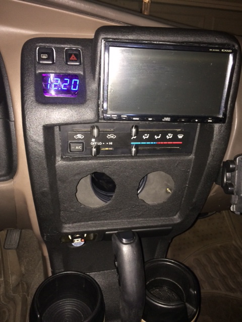

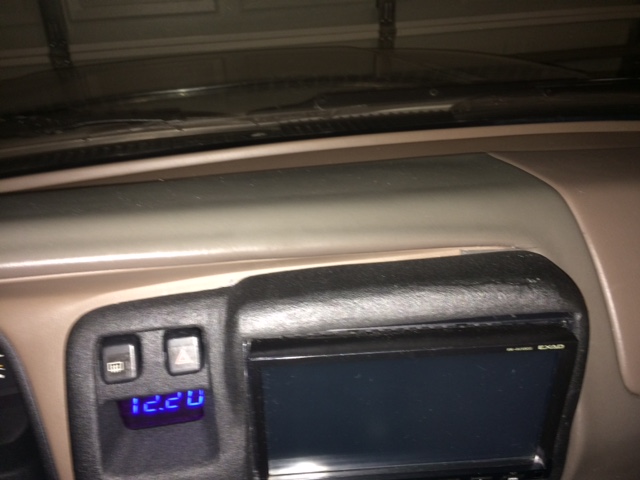

So I had to try the custom radio bezel.... and I am stoked with the results. I aimed it slightly toward the drivers seat. Its not perfect by any means because I have never done fiber glass. Also I finished it with a top coat of bondo. My sanding skills and patience for it being sub-par at best I decided to paint all the components of the center console and speedo bezel with 2 coats of black bed liner spray which looks pretty cool and hid all the imperfections. I have driven for about 10 hours with it and having the screen high is such an improvement, mostly for using my back-up camera and navigation. All I am waiting for is 2 Toyota Matrix round A/C vents to be delivered tomorrow. The behind the dash stuff was pretty easy too. Wires were plenty long enough to reroute for the radio. As for the A/C venting, just removed the curved top piece and capped it. Then cut a new hole in the old radio spot and added some new soft plastic 4 inch round tubing I picked up from Home Depot, made a plate to hold it in place aimed at the vents. 6 hours of work and it will likely become my favorite mod done to this truck.

So I had to try the custom radio bezel.... and I am stoked with the results. I aimed it slightly toward the drivers seat. As for the A/C venting, just removed the curved top piece and capped it. Then cut a new hole in the old radio spot and added some new soft plastic 4 inch round tubing I picked up from Home Depot, made a plate to hold it in place aimed at the vents. 6 hours of work and it will likely become my favorite mod done to this truck.
What did you do to hold the head unit? I like the concept very much. I'm really curious to see what the display looks like on a sunny day though. Seems to me there is a lot of glare on the dash in mine.
I thought about glare as well but its actually less than the factory spot down low. Maybe due to having a straighter line of sight, not sure. I started with a small piece of sheet metal (old beer sign ;) ) cut just a bit bigger than the radio size, and one small piece to cover the remainder of the cup holder slot. I then used a few pieces of sticky drywall tape to hold it all where I wanted it and then started to layer 2 layers of fiber glass over top, finished with a heavy coat of regular bondo. Then sanded, and sanded, and sanded.... Then 2 coats of bed liner spray paint. Fun project for sure, well except for the damn sanding. :ybrick:
Not sure if you answered what I meant to ask, is the Head Unit bolted to something behind your custom bezel?
