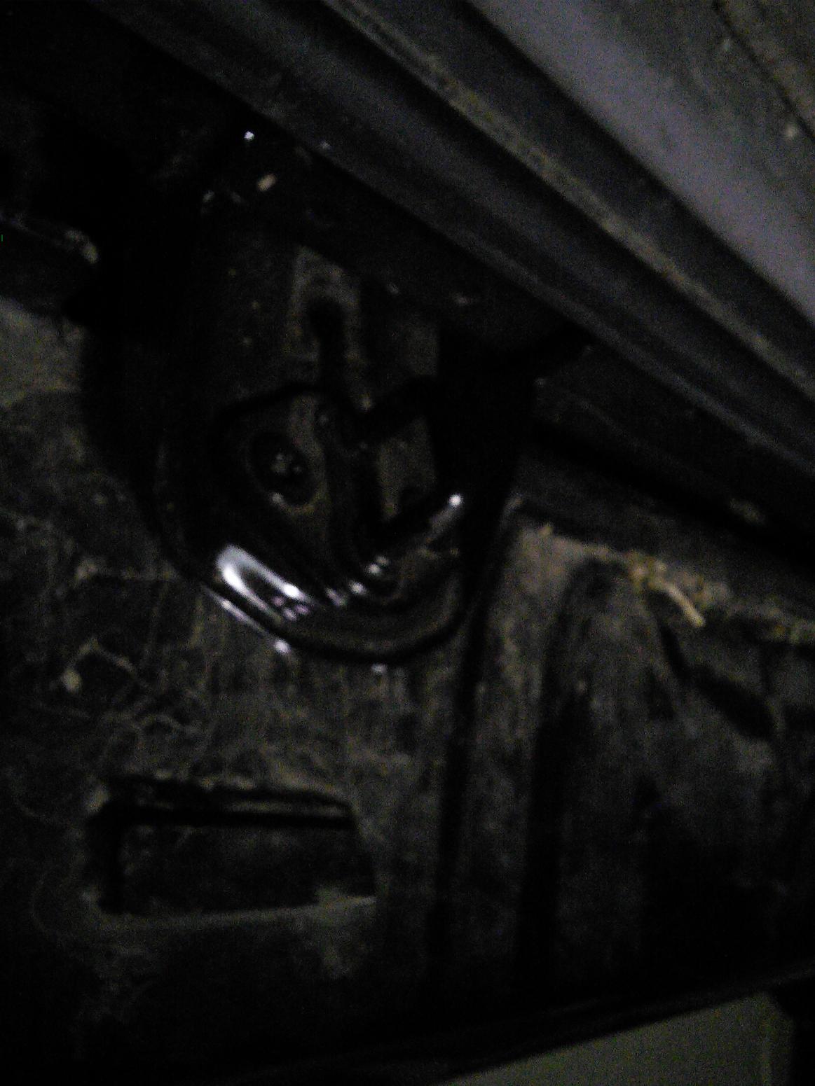

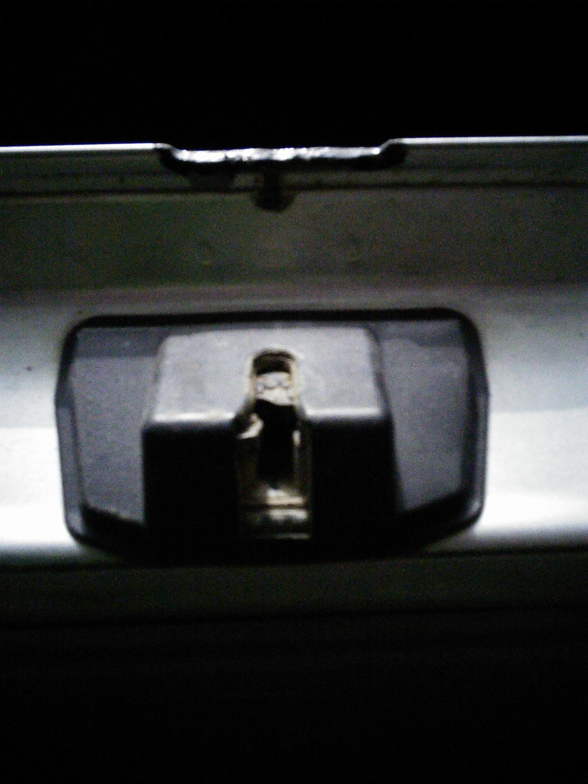

So, my rear hatch is stuck closed. I have taken off the back panel, and completely ripped apart the locking/actuating mechanism because I believe the latch is seized.
I've looked all over the forums to no avail.
All I need is a picture of the bottom of the rear gate where the mechanism protrudes from the bottom, and a picture of the latch on the floor.
I have literally never had mine open, so I have no idea what it looks like. This will probably aid me in getting it open.
I was able to find this. Now I just need a picture of what it latches onto. Another picture of above, maybe from a different angle would help!!

I just did this last week. The little compartment on the left side of the mechanism comes off and you can get at a lever that will open it.
This little guy right here:

Yup, unfortunately mine is completely seized and no matter what I did, that lever did not open the hatch. I resorted to completely cutting mine apart, trying to get it free. I've spent 4 hours on it tonight. It's soaking in Pb blast + ATF/Acetone right now.

I had the same type of problem with my '03. What i finally did, was to use a flat pry bar (like a wonder bar) to pry (from the inside) against the bottom of the hatch while lifting up on the manual release lever. Once I got it to move a bit, it finally let go and I got the hatch open. Then I was able to remove the rusted latch assy., and replace it.
You put the pry bar between the hatch and the floor?
Wooooooohooooo! I couldn't believe it when it finally opened. It took a 24" pry bar, a spare wrench and a whole lot of cutting away at the mechanism.
