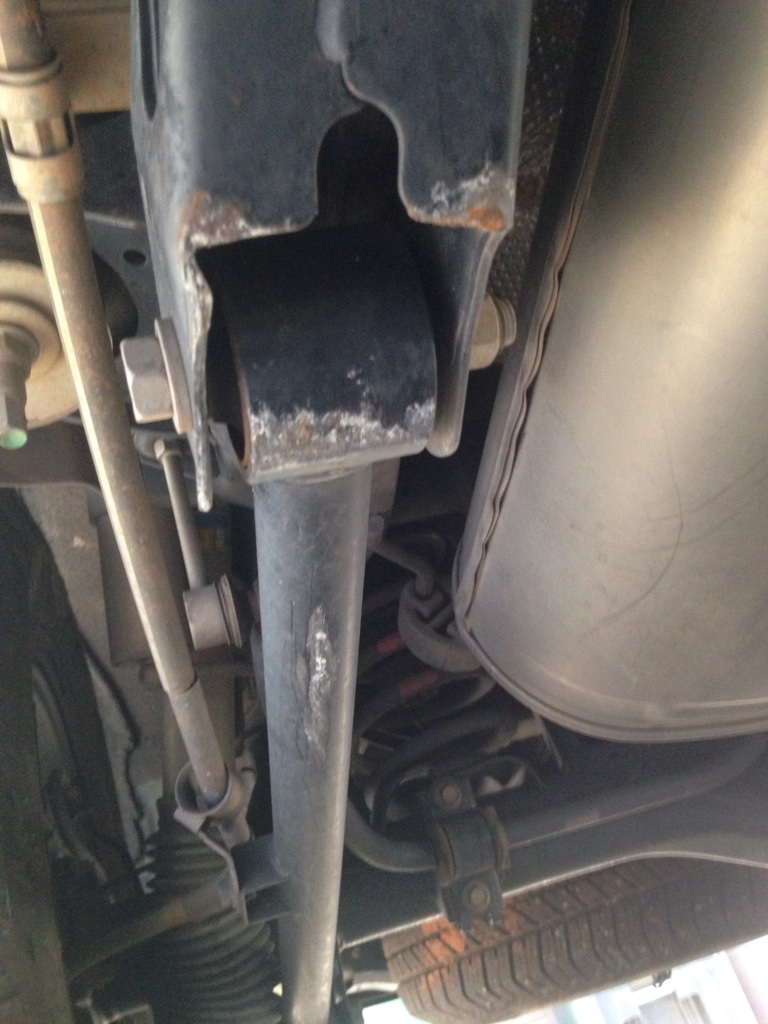

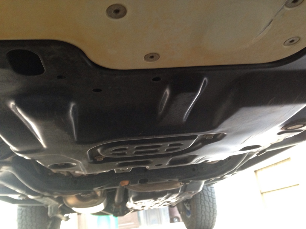

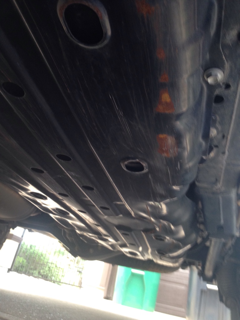

After few trip off-roading you can see in the picture that the cross member, lower link support and tank skid are taking all the damage.
