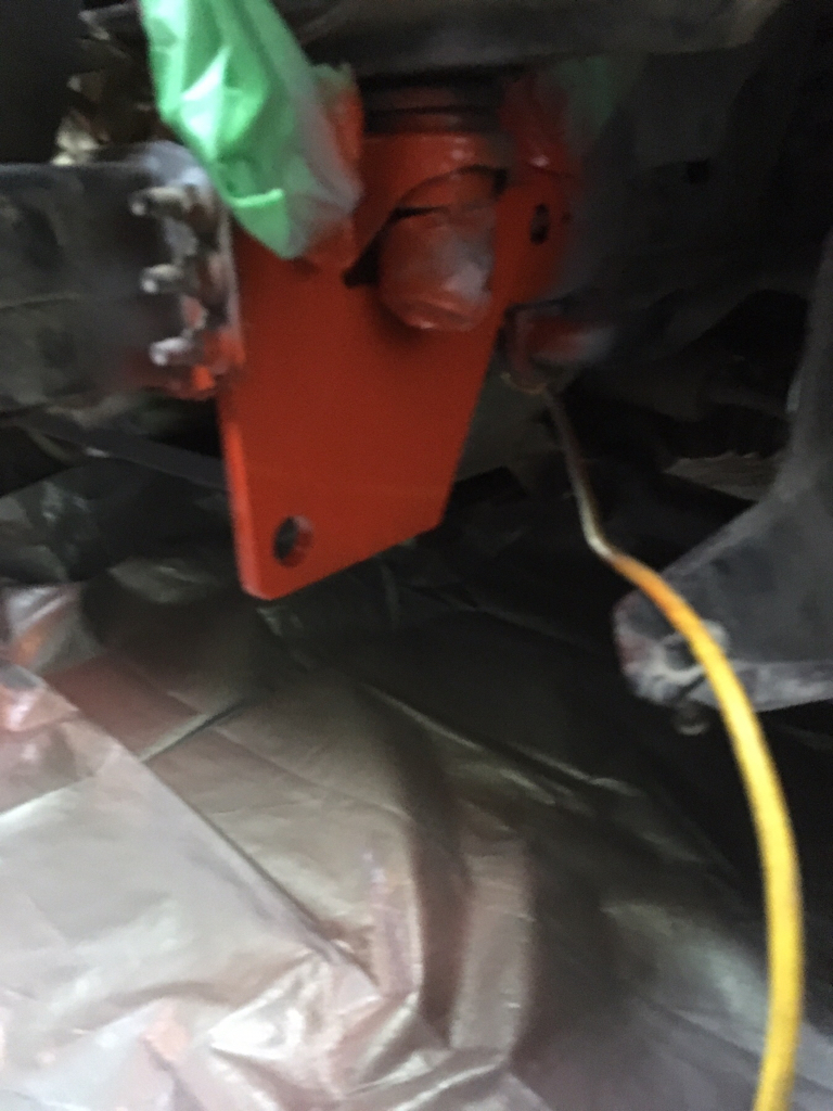

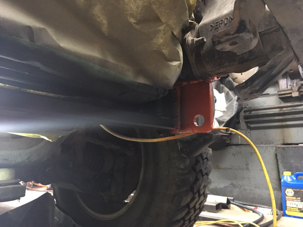

I had a local fab shop make a new cross member out of 5/16 steel and then had 1/2 thick plate steel welded to the frame for extra support. It was less than new part from Toyota and many many times stronger and resistant to rust.

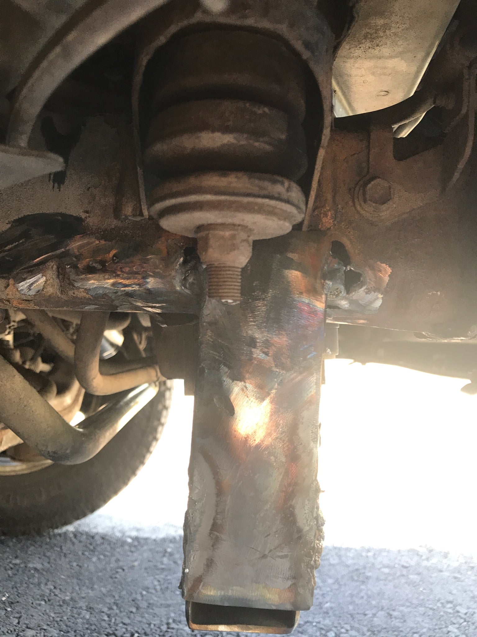

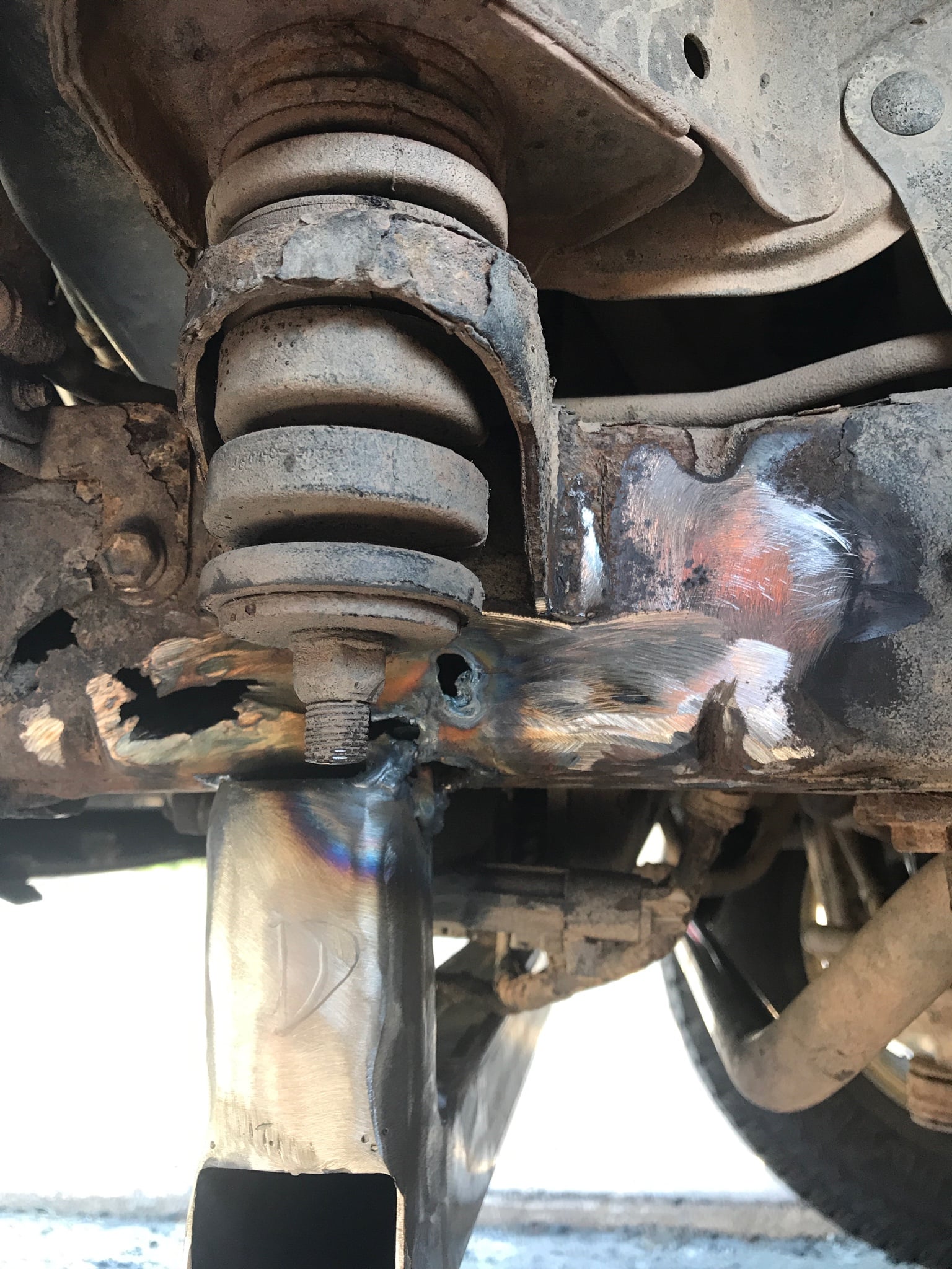

We’re cutting line off tomorrow and welding on new 2” square tubing for the ‘legs’ and horizontal bar. Then welding 1/4” plate on either end, prior to bolting up the 1/4” plate armor we just finished building
This is as far as we were able to get yesterday.
We really don’t feel like cutting off that crumple zone and welding a new piece in. Open to other creative fixes
