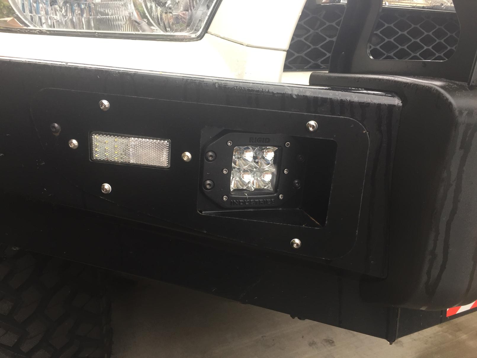

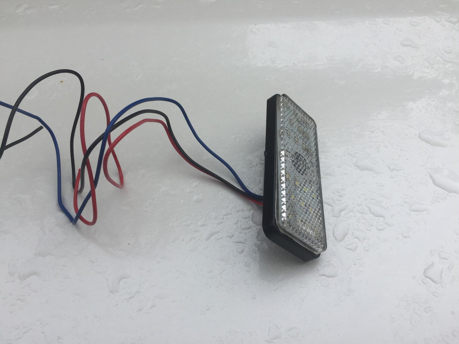

Last year I purchased the LED assembly from Labrak that fits in in ARB bumper. DRL/Turn signal light broke recently and Labrak won't return my repeated requests for a replacement. I don't know if they are even still in business. The light is a Resun A077530, but searching around Web can't find it. So, at this point I need a plan B. The light is only 3 3/8" by 1 3/8", so the standard 6 inch turn signal lights won't fit in the spot. I'm considering buying a pair of the Rigid A series lights with amber LED and coming up with a way to mount them. They will fit in the space and I can make some sort of back plate to attach them. I assume that when I wire them they will blink, I'm not worried about the DRL function.
Anybody have any other ideas or suggestions?
Thanks!

This should be super easy.. Get a piece of aluminum and basically create a block off plate with matching holes. Paint it black. Drill some 3/4" holes in it and throw a couple of these in it...
http://a.co/8iBVpfu
Should look really good.
Might need a resistor, to stop it from fast blinking.
