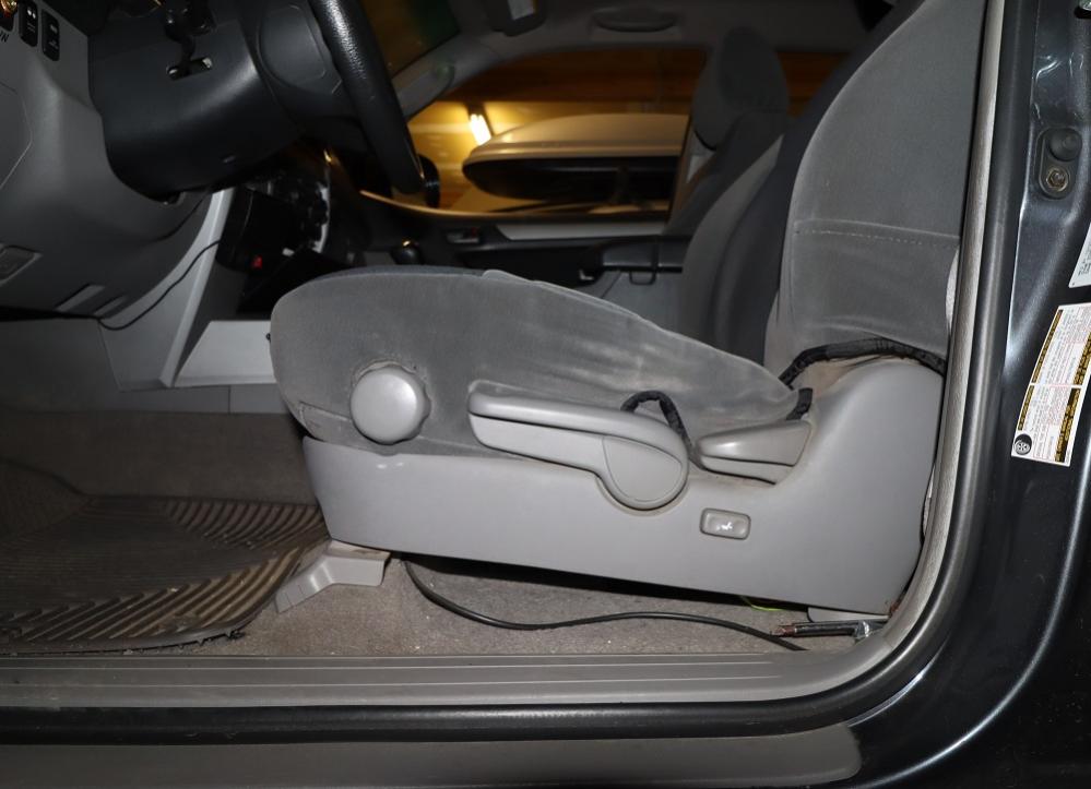

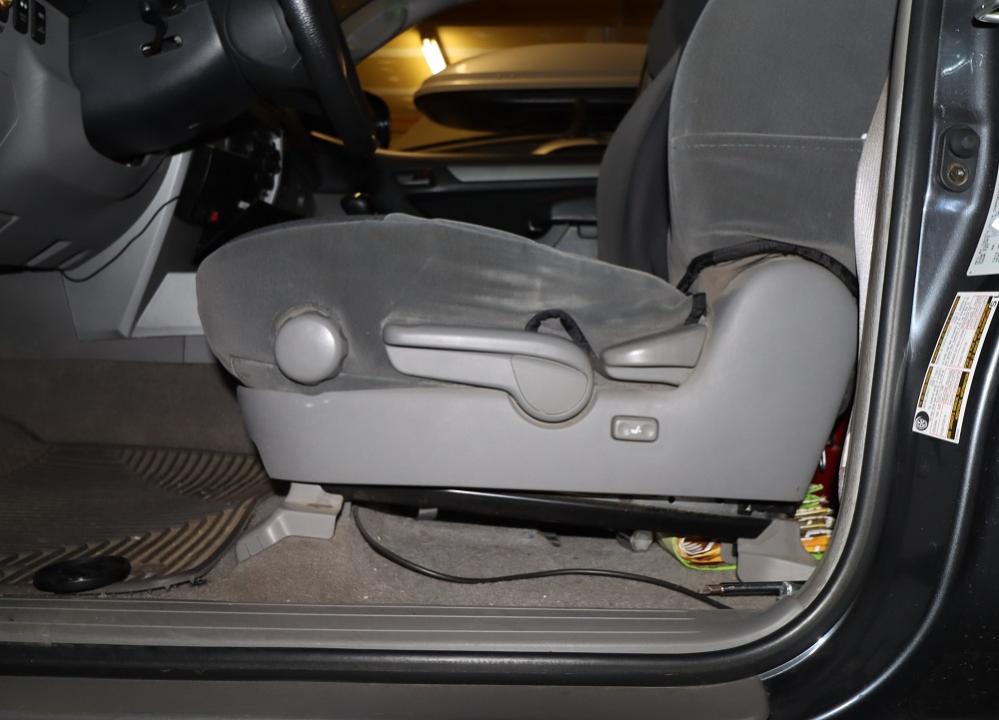

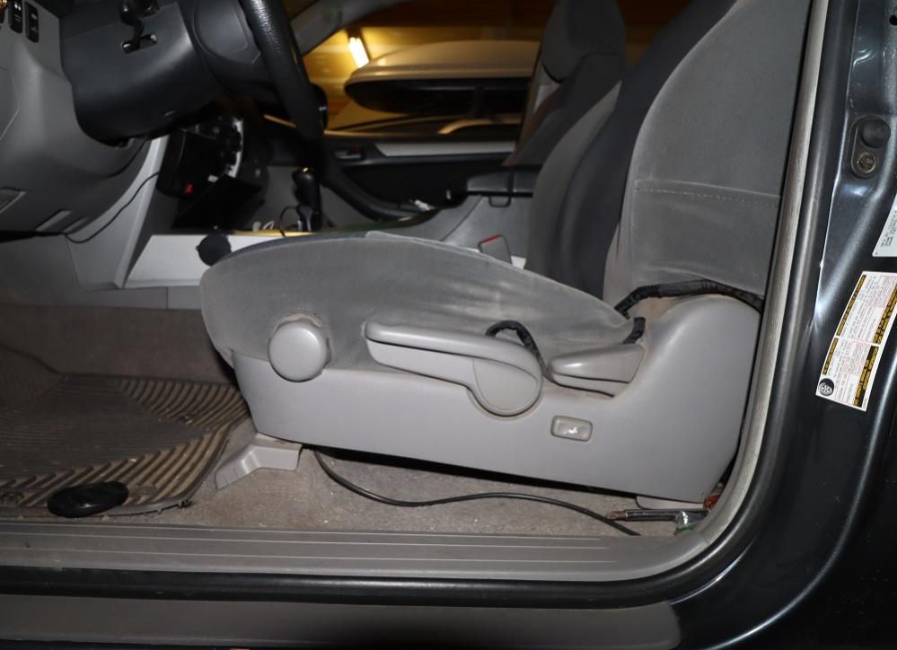

Mine have a front and rear height adj.
The 'dial' is the up down in the front of the seat.
The 'lever' adjusts the height of the back lower part of the seat.
