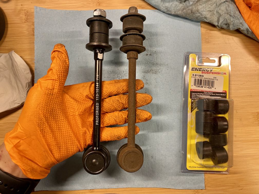

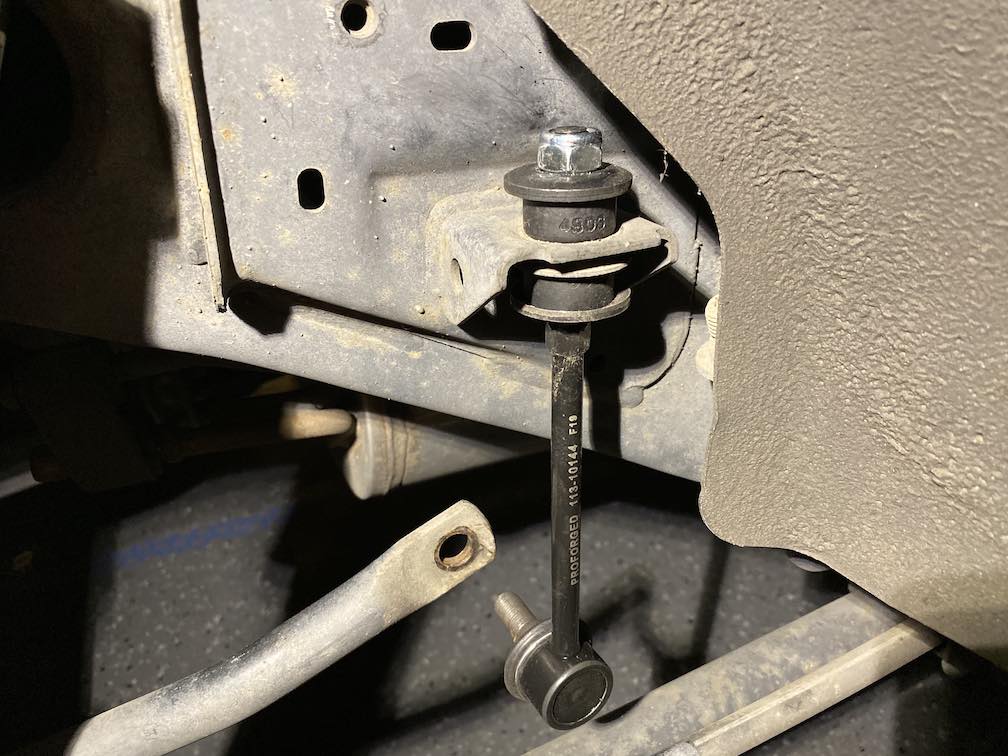

I just installed Proforged end links (LEFT) and took out my old Moogs (RIGHT). The Proforged looks well constructed and I hope they do not rust like the Moogs do. I also picked up the Energy Suspension bushings that someone previously recommended. Side by side comparison picture attached.
By the way, if anyone local to me (check my profile) wants my used set of Moogs for free, PM me. I think they worked fine, the length was correct for a 2" lift. They just develop surface rust almost instantly. I didn't know this prior to installing them. You would probably want to sand them down and paint them.
