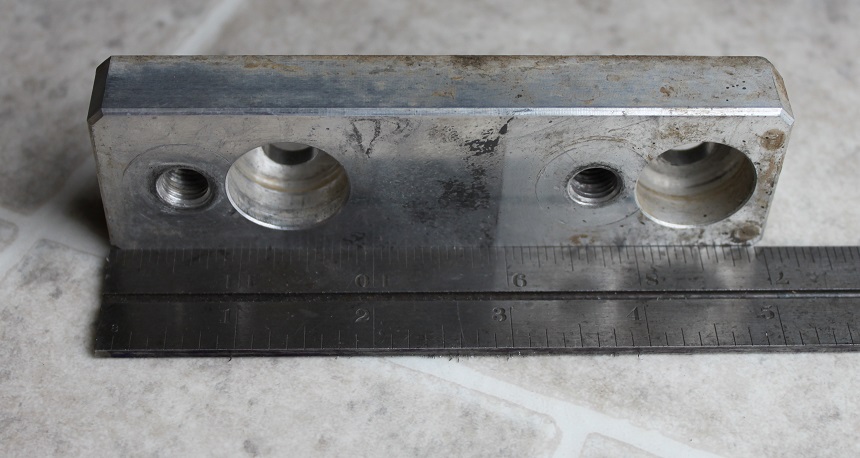

Thanks for the help, and great explanation! Do you know if there is any sketches with dimensions for those relocation brackets? They seem pretty simple to make, but I’d prefer to make them up and have them ready to go before pulling things apart if possible. I’m sure I could design them once it’s apart, but no sense re-inventing the wheel if the info is already out there. I hear you about ditching them altogether which makes perfect sense for off roading, but mine is almost entirely street driven so for now I’d like to just set the geometry to work correctly for that purpose.
Front sway bar relocate.
Probably cost less to just buy it for $35...with bolts.
5"Lx1.5"Wx5/8"T
The distance between holes is 3/4" moving sway-bar forward.
5"Lx1.5"Wx5/8"T
Thank you for the pic and dimensions! I am just seeing it now because I forgot to check back in this thread again after posting that.

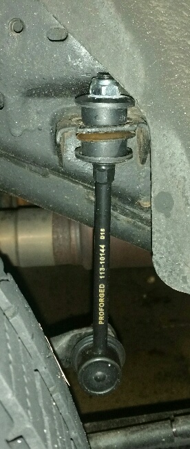

I am going with the 2nd Gen rear end links for the 06 V8, 3 / 2".
Sourced from Proforged.
Proforged - Severe Duty Chassis Parts
https://www.amazon.com/Proforged-11...533227985&sr=1-1&keywords=Proforged+113-10144
As other folks have said, the 2nd gen end link is long enough to level out the sway bar on a 4Gen.
It comes in what appears to be powder coating, and is engraved with the markings. (not a shiny chrome piece, as depicted in Amazon)
I swapped out the rubber grommets for Energy Suspension stuff.
