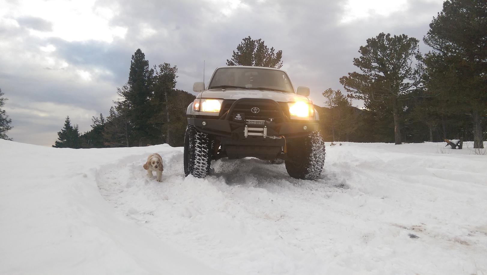

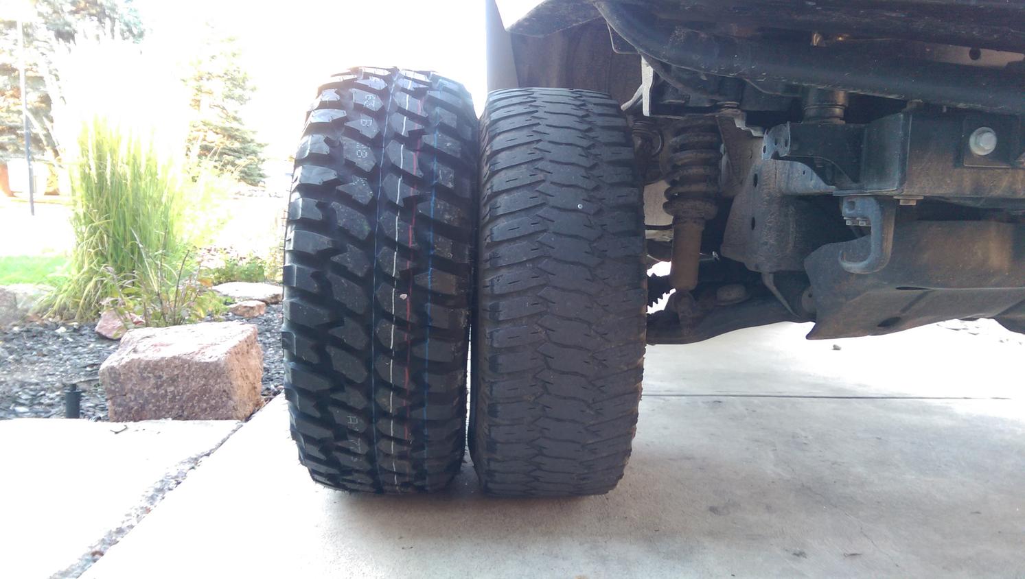

So many tire threads out there. With my lift I went with 305/70r16. Sits 33" tall and pretty much as wide as a 315 or 35" tire. I love how it looks and sits and always get compliments on my truck. Way more now than I did with 285's. Get a little tire rub here and there mainly when offroad. Just got her aligned they they added way to much caster so now it rubs in front of the tire when backing out in reverse and turning but I am going to have the shop fix that. Here is a pic of me in the snow with my wifes dog and another comparing a worn out 285 vs my new 305's.
