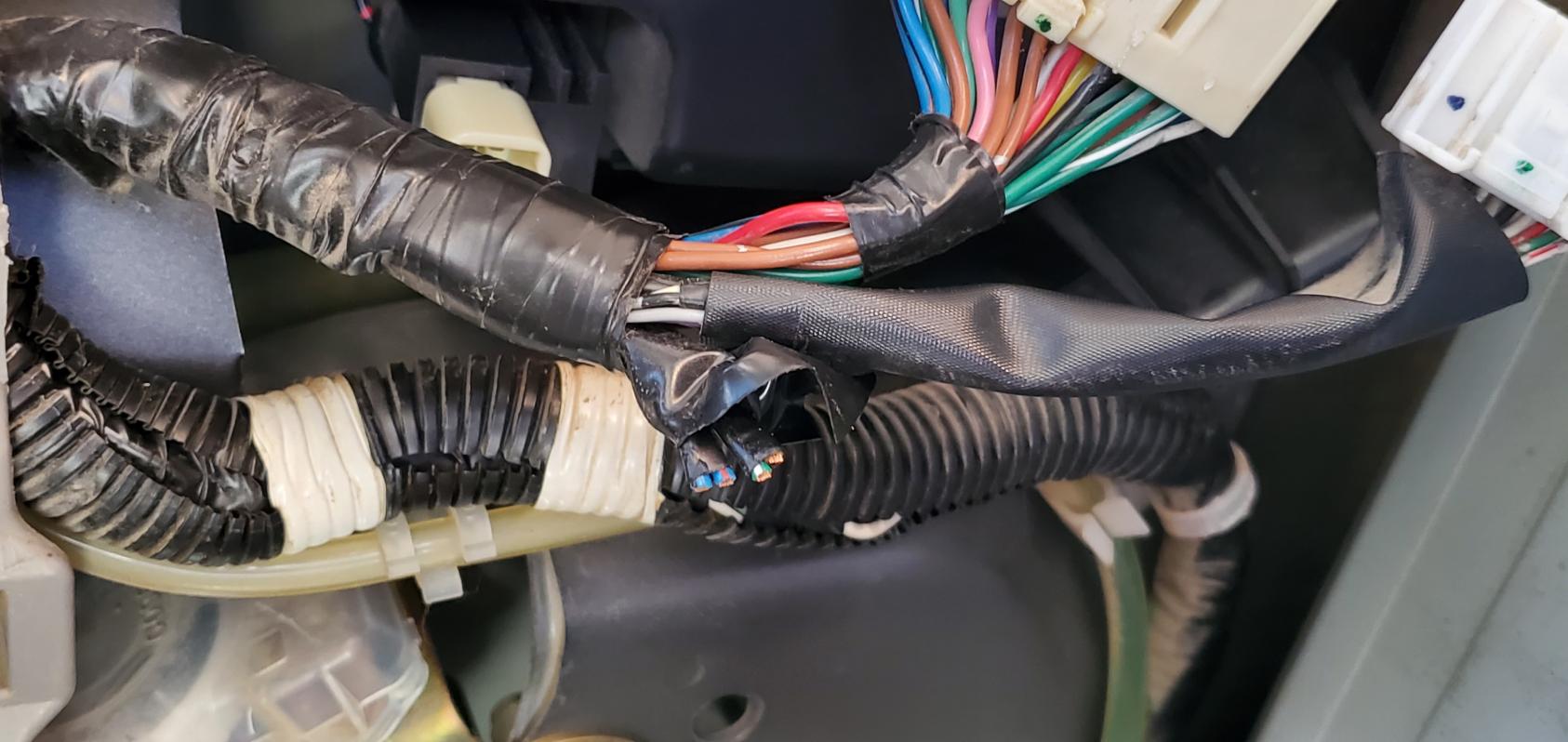

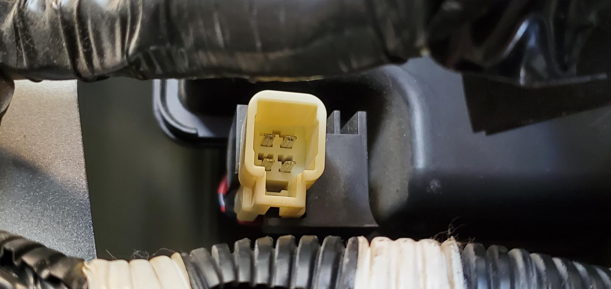

thanks guys, i managed to finally get ahold of a 86150-0W040 subwoofer with an amplifier. audio works,but unfortunately the last owner thought it would be a good idea to snip the harness to the subwoofer speaker. so the subwoofer speaker doesnt work.
Does anyone know where i could find a diagram or image for the harness that attaches to the subwoofer box connector. i believe its a 4 pin wire for the subwoofer speaker.

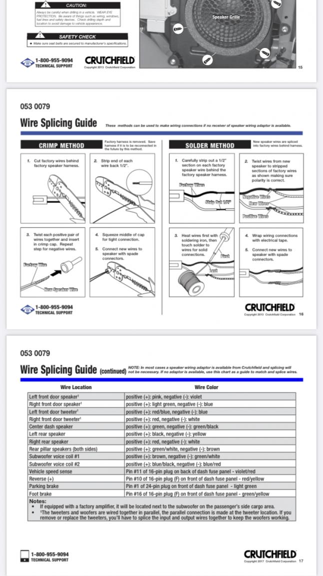

From crutchfield
