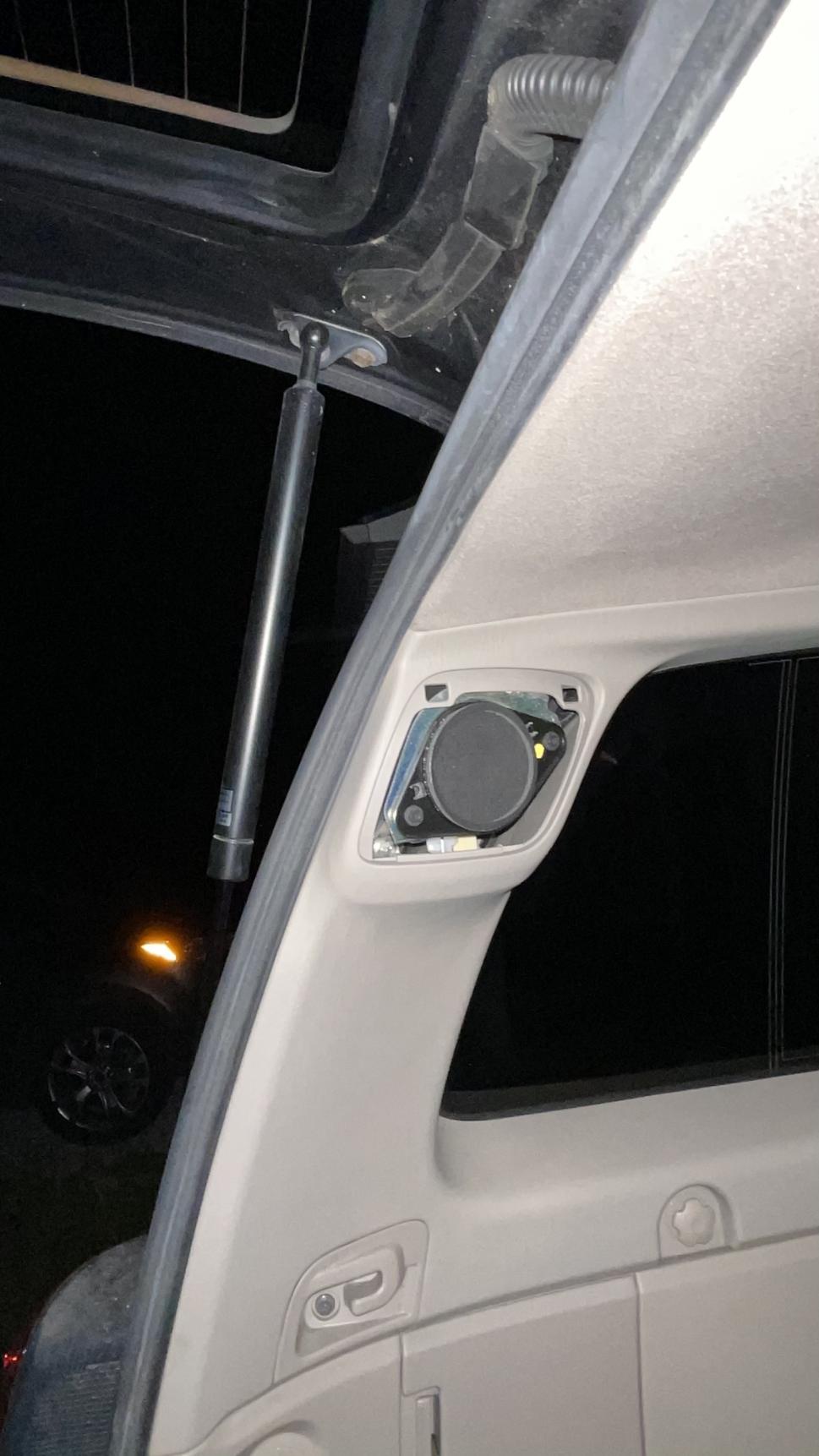

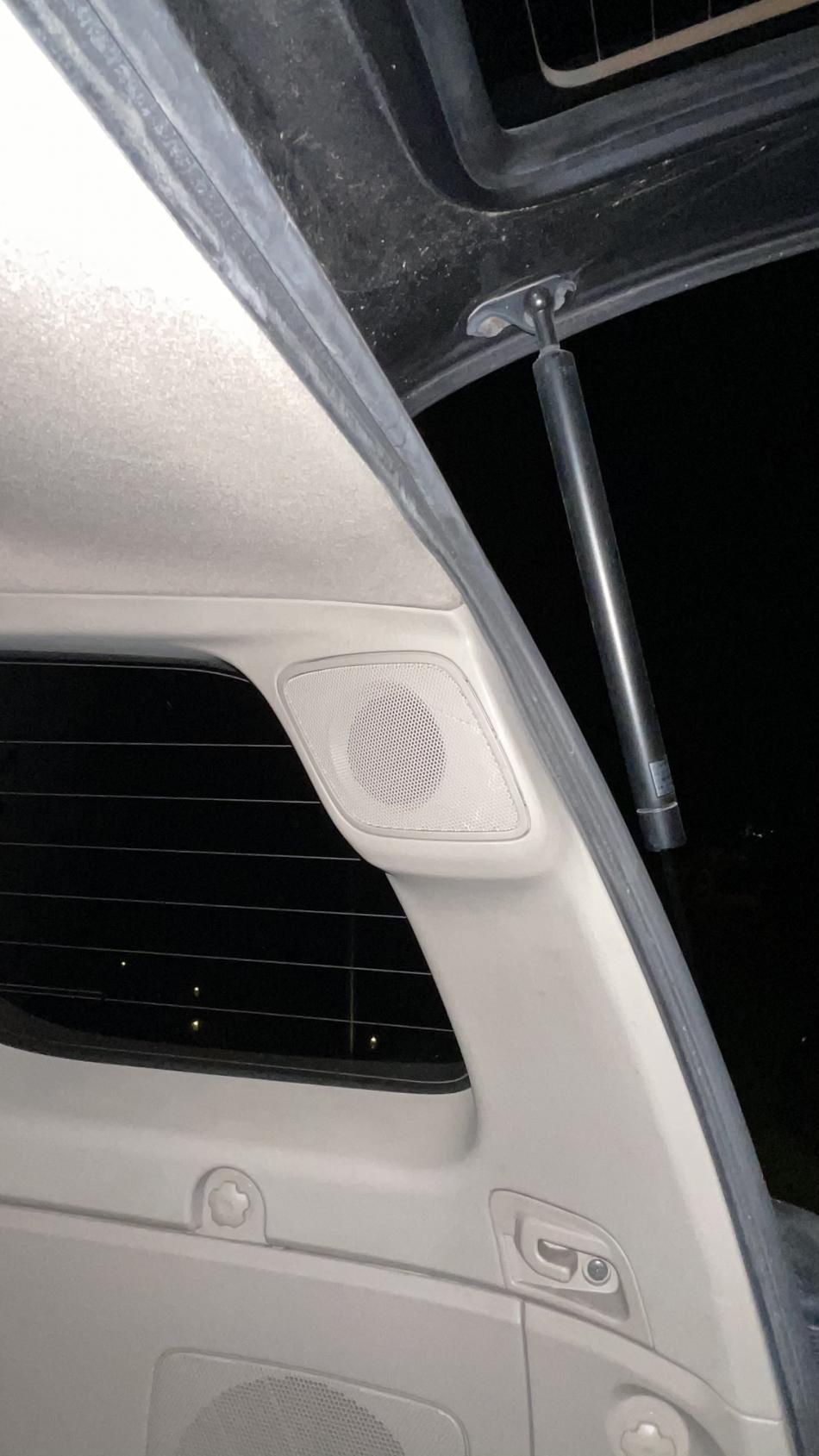

I have a 2007 limited with the JBL synthesis sound system. I am missing one of the rear pillar speaker grilles and I’m hoping someone can help me find a part number or at least the actual name of the part so I can find a replacement online (hopefully). It’s hard to find 4runners in the junk yard because they’re built so well... any help is appreciated. I attached a photo of the grille that is missing, as well as the other side for reference. I think on the non JBL equipped vehicles, there is a mirror in place of these speakers/grilles. Thanks

The part numbers on my speaker grilles (in stone gray) are:
86269-35010 (RH)
86279-35010 (LH)
There is also an “A1” on each grille. That might be the color code, but I’m not positive about that. From your photos, it looks like you have a beige interior. I have a stone gray interior. If A1 is my color code, yours might be A0 or A2.

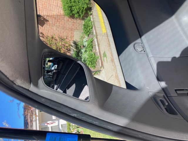

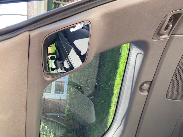

When I upgraded my stereo, I didn’t retain the tweeters in the rear pillars. I bought a pair of mirrors on eBay to go where the tweeters were. I think I paid $20 shipped for both mirrors. They had minor scratches all over that came out easily with scratch remover. Now they look good as new. After removing the tweeters and grilles, the mirrors popped right into place. The mirrors come in handy on occasion, and when I remember that I have them. I sometimes forget about them because I didn’t have them for ~12 years.

Here are pics of my mirrors. I forgot about the deep scratch on the right mirror, but I can’t see it when I’m driving.
