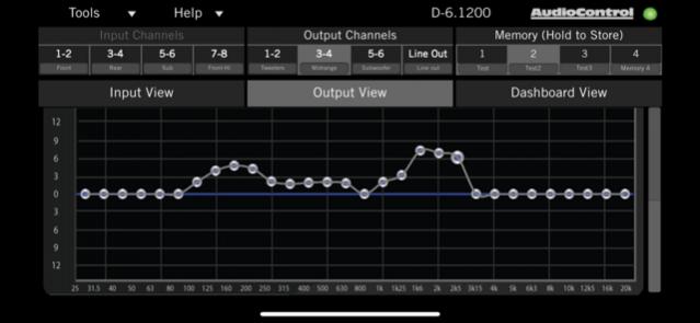

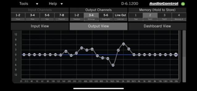

First is right midrange, then left
Again still refining

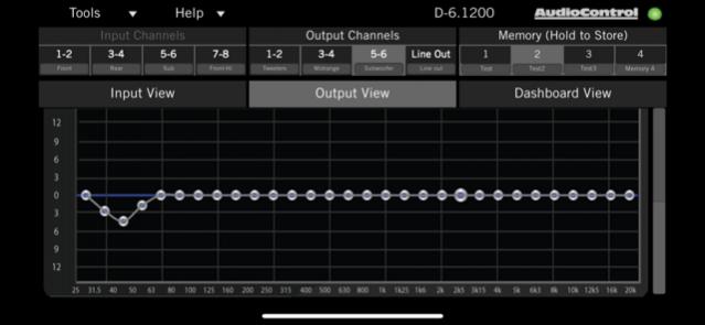

Subwoofer EQ which is simple, I had to dip the 45hz range due to the response.
I pretty much need to readjust everything since fixing time delay

The eq in your midrange and bass is very similar to the eq I'm running. I'm sure with the new head unit you'll get better overall output.
