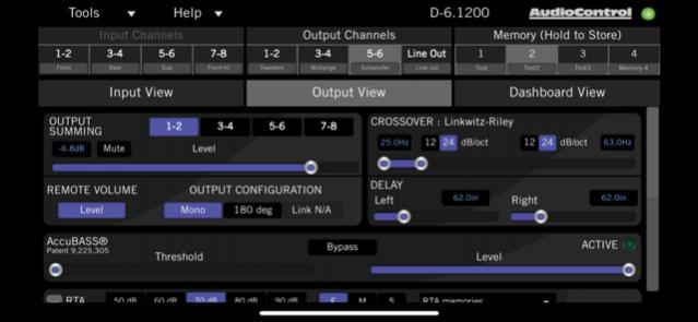

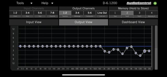

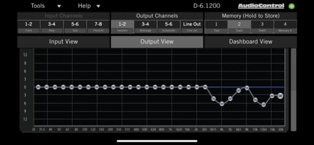

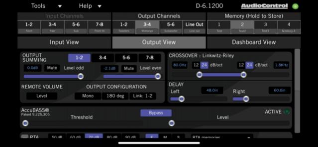

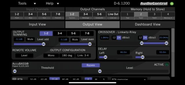

Here are the time delay and level settings I have so far, this is close to being dialed in, still could be better, the image is pretty well centered, but I still need to check my EQ settings since fixing my time delay. For reference I used a stereo pink noise track available free on the JL Audio site.
Now I’m 6’4” so my seat pretty far back, my subwoofer is on the passenger side facing rear of vehicle, I simply used a tape measure from my right ear to each speaker while sitting in the vehicle to obtain these measurements, I did add 3” to each door speaker to account for the depth of the door panel and 2” to each tweeter to account for the grille, for the subwoofer just measured in a straight line to the face of the box

First is right tweeter EQ setting, then left.
Still refining, but need a good chunk of time without my kids crawling up my legs
