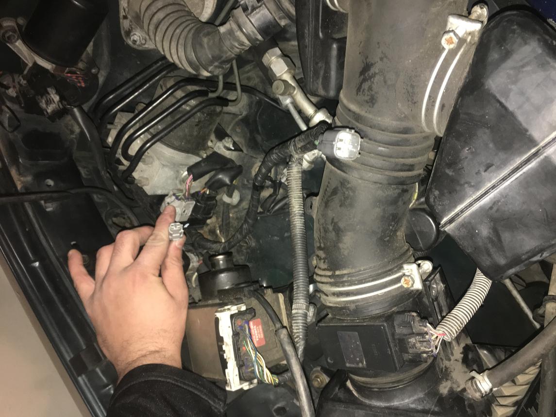

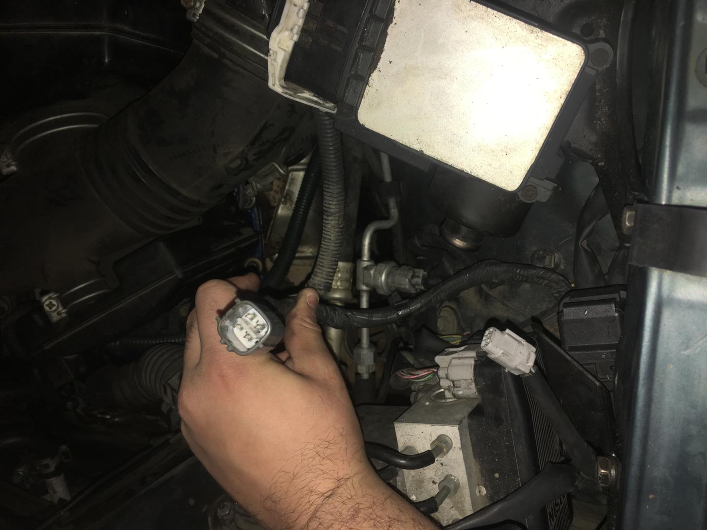

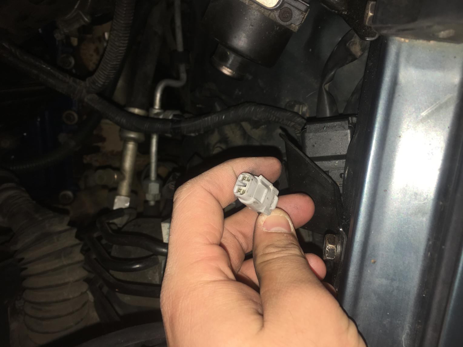

Once again I’m here to ask for help. I can’t figure out where these two plugs go. They are on the 2wd auto harness I pulled out so I know they went somewhere.
The 4Runner runs fine except for a CEL for camshaft position sensor, no speedometer or temperature sensor. Any help is greatly appreciated

That one 4 pin plug has to be the one that runs right behind the camshaft cover on the passenger side that does go to the camshaft sensor. The other one I'm not sure.

The small 2 pin looks like an ABS wheel speed sensor plug, would explain the no speedometer.
Looks like my abs plugs are plugged in. Still not sure where it goes. Hoping someone can cross reference to theirs. Anybody? I’ll send you a pizza if you can figure out my speedo issue and this plug.
How would I go about diagnosing the speed sensor?
The 2 pin looks like it goes to the connection right behind the timing cover next to the Pcv valve on the passenger side valve cover, can’t remember exactly what it goes to right now. Possibly temp sensor?
There is an identical looking one where you said but it’s plugged up
I tested both of my front ABS sensors with my multimeter and they both stayed at about 1650 which is good ive read. Couldn't check the back i was having trouble getting the wires down. I have a feeling it is something to do with that one plug but i can't find anything on it anywhere.
