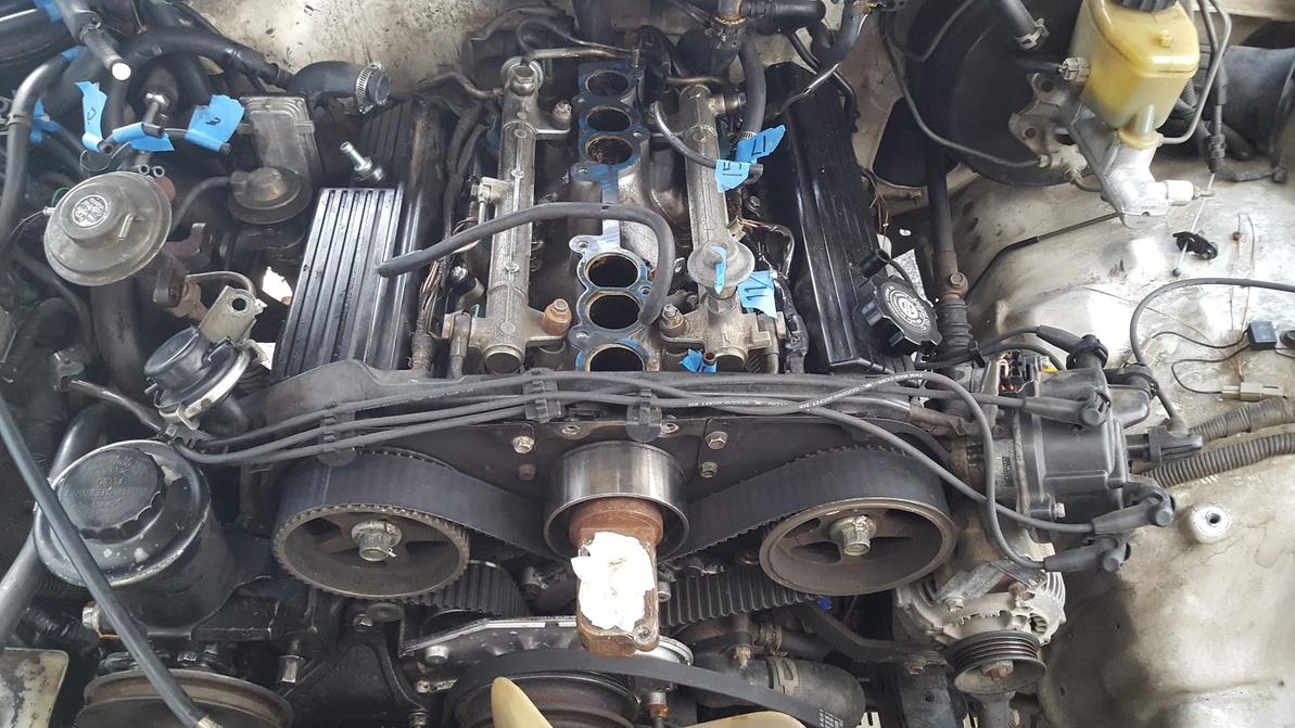

1994 4Runner, 225k, 3.0VZE, auto, 4x4 - I've had it a few months and basically no history on it. I can see some work has been done but no records
I don't have a FSM; I've basically been doing this via YouTube videos...
I'm replacing my knock sensor/harness and have the plenum off but am not sure how to proceed with the fuel rail... any tips?
I'm going to do my timing belt/water pump/tensioner while I've got it torn down. Also working on an intermittent cold start issue so the coolant sensor is getting replaced ($20) as well as troubleshooting the cold start injector.
Anything else I should do while it's down? Am I going to shoot myself later if I don't do something (replace/have tested/cleaned) to the injectors?? It was running great before, just a knock sensor CEL and intermittent cold start issue...
Just flip the rail off to the passenger side of the engine. You don’t need to remove the lines.
Here’s an online manual you can follow. https://www.ether3al.com/runner90-95fsm/
You may want to do injector cleaning, orings or even have them sent out for service.
You can delete the EGR system if you want, but removing components is a hack, not a repair, any way you slice it. Don’t be surprised if you create more problems.

Since you are that deep into the engine, I would consider adjusting the valves. Due to wear of the exhaust valve seats and faces, the valve clearance at the lifter continues to decrease until the valves eventually won't fully close. At that point the valves burn very rapidly and you'll be needing a full valve job.
The valves adjust with shims, and the process is a bit fussy. Do some internet searching on the procedure. They are adjusted cold.
If it was me. I would go ahead and pull your heads and do a valve job.
All you will have left to do is exhaust manifold bolts and head bolts and your heads will be free.
If I remember right, the worst part of that job is removing the exhaust crossover pipe and only because the bolts are hard to get to.
I would spray all the exhaust bolts with wd-40 and let them soak for 24 hours before removing them because they tend to bind due to the extra heat from the exhaust.
The only reason I am suggesting this is because you almost have the heads off now and with the mileage thats on the motor it wont be long before you are going to need it anyway.
I started working on 4runners about 6 years ago because a friend of mine bought a used runner and he blew a head gasket. He was not a mechanic so I offered to lend a hand. Since then I have worked or helped work on three more runners and they all had head gasket problems. For some reason the 3.0 motors seem to have a design problem that causes the #3 cyl (if I remember right) have a gasket failure.
Anyway, when I read your post and saw how many miles you had on the motor I thought I should put my two cents in and let you know what I would do. Good luck to you. Just take your time and have fun.
