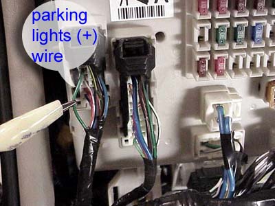

Ok, so which wire is the parking light wire?, kinda of new to car electronics so a little help is going to be needed.
here is a picture...
