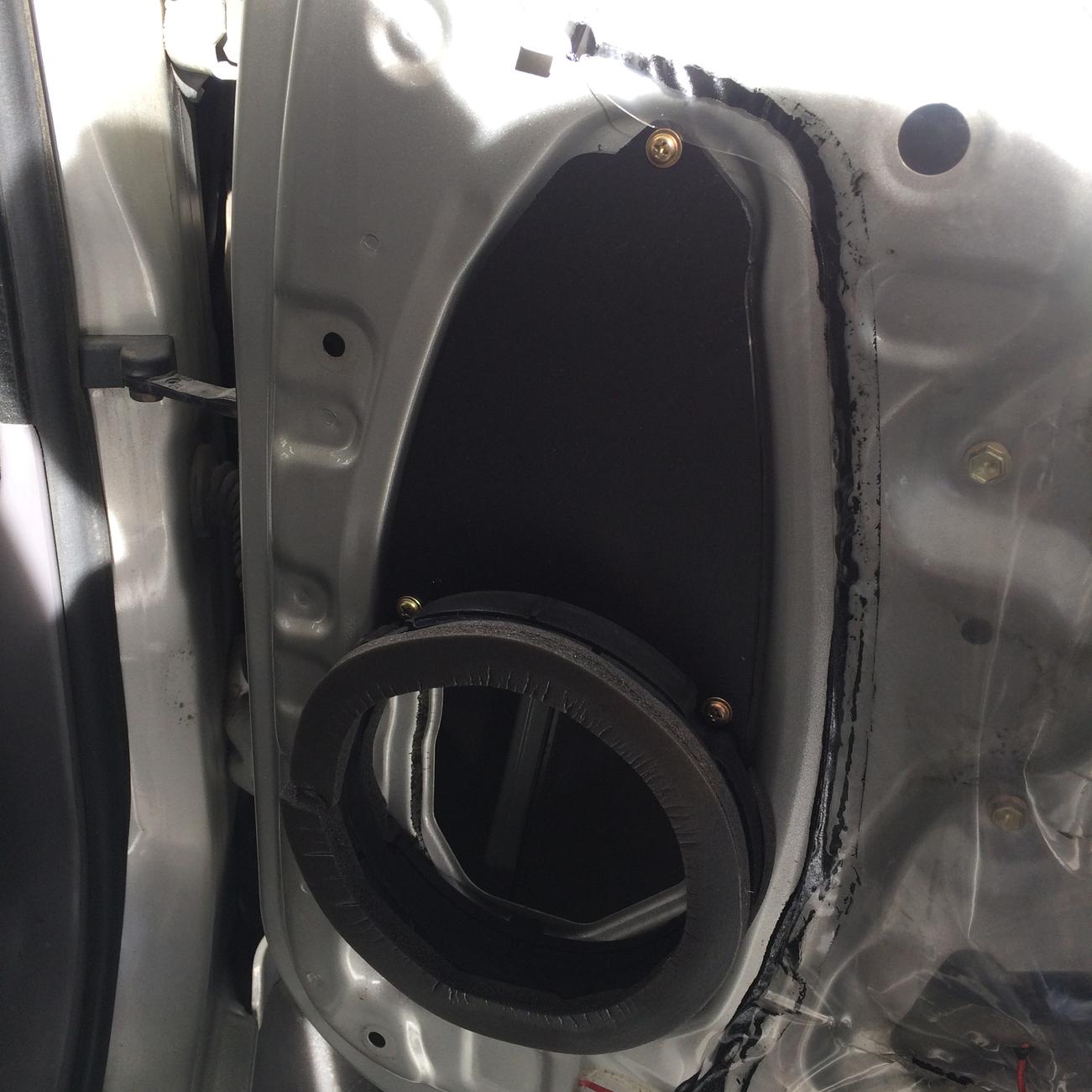

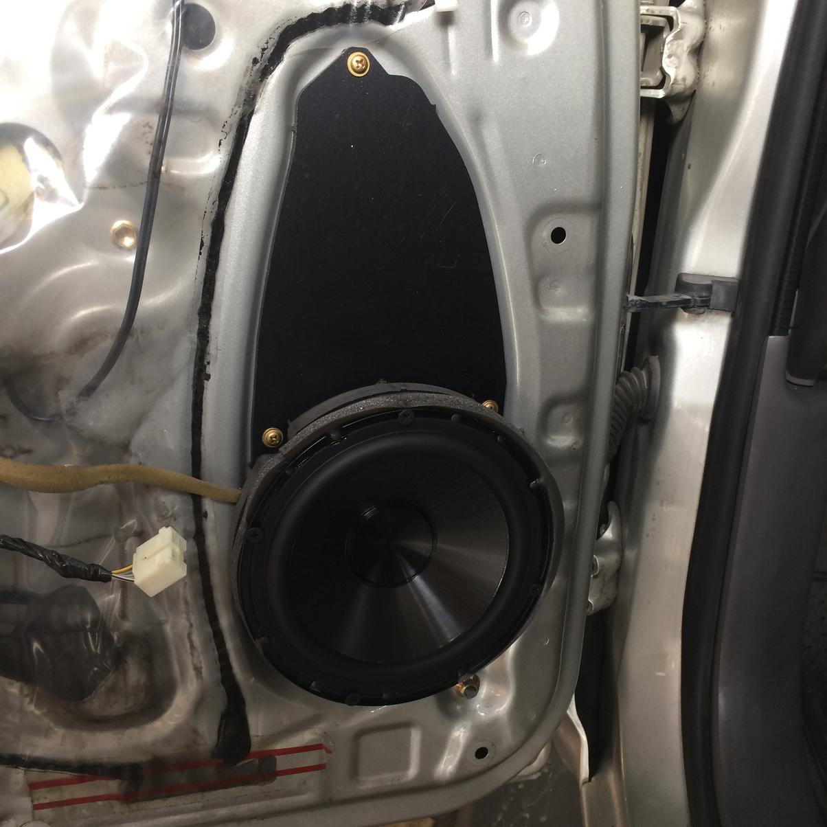

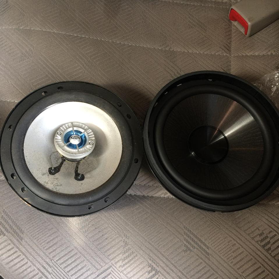

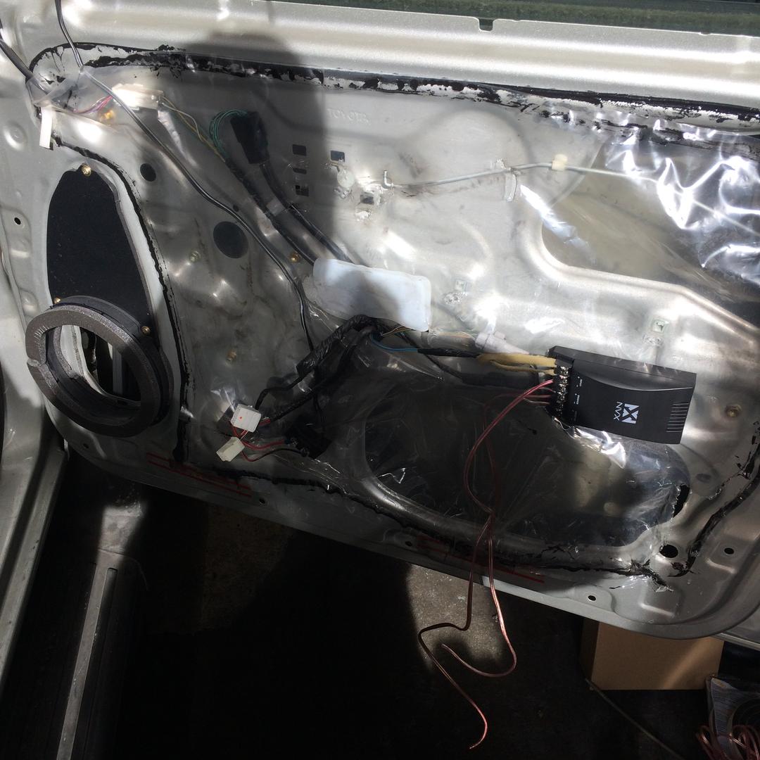

So here are some pics of the install of my new NVX component speakers.
After removing my door panel, I had Phoenix Gold Octane R 6" coaxial speakers w/ 1" Diamond Audio tweeters connected to a passive crossover in both front doors.
When my installer removed the speaker, we found out that the new speakers mounting depth was too big for the stock speaker housing and was hitting the windows. The previous installers just used my stock speaker housing and glued the new speakers on the old housing and made new holes to attach the screws and speakers in. So at this point I was kind of bummed that I couldn't install it last week. I was ready to throw in the towel and send these speakers back but decided to go contact car-speaker-adapters.com and purchase a set of speaker adapters specifically made for my 4runner. After talking to him, I purchased the speakers and w/in a week, my new adapters and spacers came in. I take it to my installer and after removing the speakers and old adapter, he attached the new adapter bracket. He put foam tape on the back side of the adapter that attaches to the metal door frame, then attaches the 1/4 spacer to the bracket using PVC cement. He then puts more foam tape on top of the spacer before attaching the speaker to the adapter. He drills a couple of holes in the metal door frame to attach the passive crossovers before installing the tweeters in the stock tweeter location. Last picture just shows my two speakers, the Phoenix Gold Octane R 6" coax and the NVX 6.5" mid.

It actually sounds way better than my old set up. The clarity is way better than my Phoenix Golds coax and Diamond Audio tweeters. Granted the bass on these speakers aren't as good compared to my old PG coaxials. I don't know if I have to break them in but I did read from the reviews that the bass on the mids wasn't all that great so I was expecting that. Besides I have a sub to handle the bass.
All in all, I am very impressed with these speakers especially for the price point. $90 before taxes and still less than a $100 after taxes, plus they threw in a free 25 ft OFC 12 gauge wire. Will definitely buy another set of NVX speakers when I decide to upgrade my rear speakers
