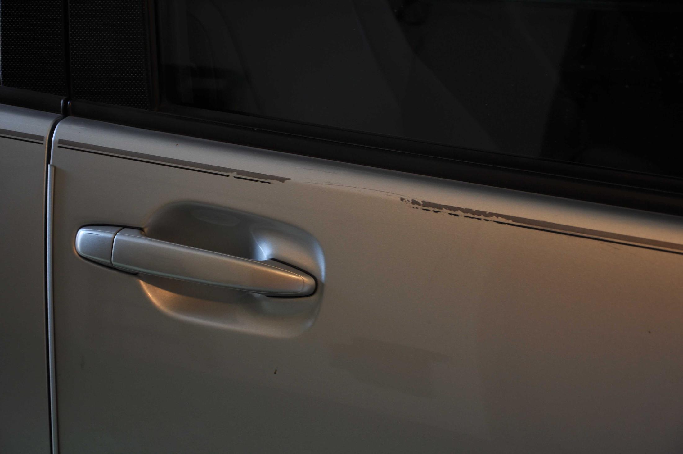

Hey guys, so this has been bugging me for awhile,
but somehow the pinstripe on my passenger door got
ruined. It's been like that for a couple years and now i
really want to fix it. Is there a place online where i
can order the pinstripe to match? How do i peel the pinstripe
off the door and replace it without ruining the paint? Thanks!

Oh, no my pinstripe was put there when the car was built. It's not aftermarket or anything.
I thought it would be an easy replacement. I don't even know how this happened and i dont
know why the picture is so huge (sorry bout that) but now i can see little scratches from this pic.
It looks like someone did this on purpose :(

all good advice so far guys... I should probably mention that i've had this 4runner since 2004 so i'm afraid that if i remove the pinstripe altogether it will leave a discolored stripe behind. Thats why i've been trying to figure out how to repair it instead.
Clean the area where the damaged portion of the pin stripe is thoroughly. Is there any noticeable fading?
I saw a white 2nd gen Tacoma with the TRD Sport package. It was very noticeable where the TRD Sport sticker use to be on the bedside. Hopefully, it's not bad on your 4Runner.
Easy fix. When I put "pin stripes" on estimates for work, we pay $15 plus about $15 to install...have you checked at Autozone? Some of those type store sell pin stripe rolls ready to peel and stick on. I promise you can find the same color online or at a local store.
How to: Peel the old on off or use an "eraser" type disc you can pick up a napa. Degrease and stick it on! Start on the edge of the door, line up w/ the old one on the next panel. Then with slight tension, peel the backing off. Hold out a feet and you can push towards the frt of the door and it will help keep everything straight...hope that makes sense.
Good luck!
just go to a local bodyshop. they can fix it while you wait easily. they can also match the color perfectly. 3m makes the stripes, please do not go and try to buy a roll. a bodyshop probably wont even charge you and if they do it would only be a few dollars. you have two different stripes on there the top one is 72363 and the lower one is 72002.

This is what I used when I worked in a shop.
Using the 3M Stripe Off Wheel (eraser wheel) 2007.5 Chevrolet 2500HD Silverado Lifted on Cognito - YouTube
Its called a 3M adhesive eraser. They run about 25-30 bucks but work very well.
When you remove the stripe the area under the stripe is typically shinier than the rest of the paint, so you may see a ghost image.
It will only be slightly noticeable on a silver finish.
You can easily polish the area and it will blend together.
As for re-striping with the tape-type striping, its not extremely difficult but it does take some attention to detail to get it straight along the body lines
and to make the cuts at each section. You also need to bring the stripes to a point at the leading edge of the fender. Id probably leave them off and call it good.
Stripe kits and the eraser can be purchased at a good auto parts store or a body shop supplier.
