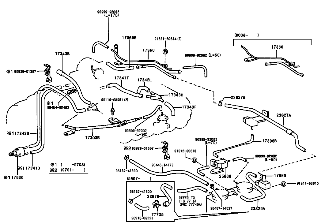

The driver's side of that tube should have a rubber 90 degree elbow on it that takes it's vacuum from a nipple on the back of the driver's side of the intake manifold right where it meets up with the lower intake manifold.
The passenger side of that tube should have about a 6.5" rubber hose on it that hits a diaphragm on the throttle body as mentioned above. In the parts diagram it's 90999-92002 L170 and L60 (where L=length in mm).

Also if you have access to a FSM ( http://docs.google.com/fileview?id=...Tk4NjUtYjk1Y2ZiNjMxMTFk&hl=en&invite=COG4vfsI ) check page 947 where it has an exploded view of the intake area of the engine. You'll see that little pipe, and see it's unlabeled / not connected to anything.
