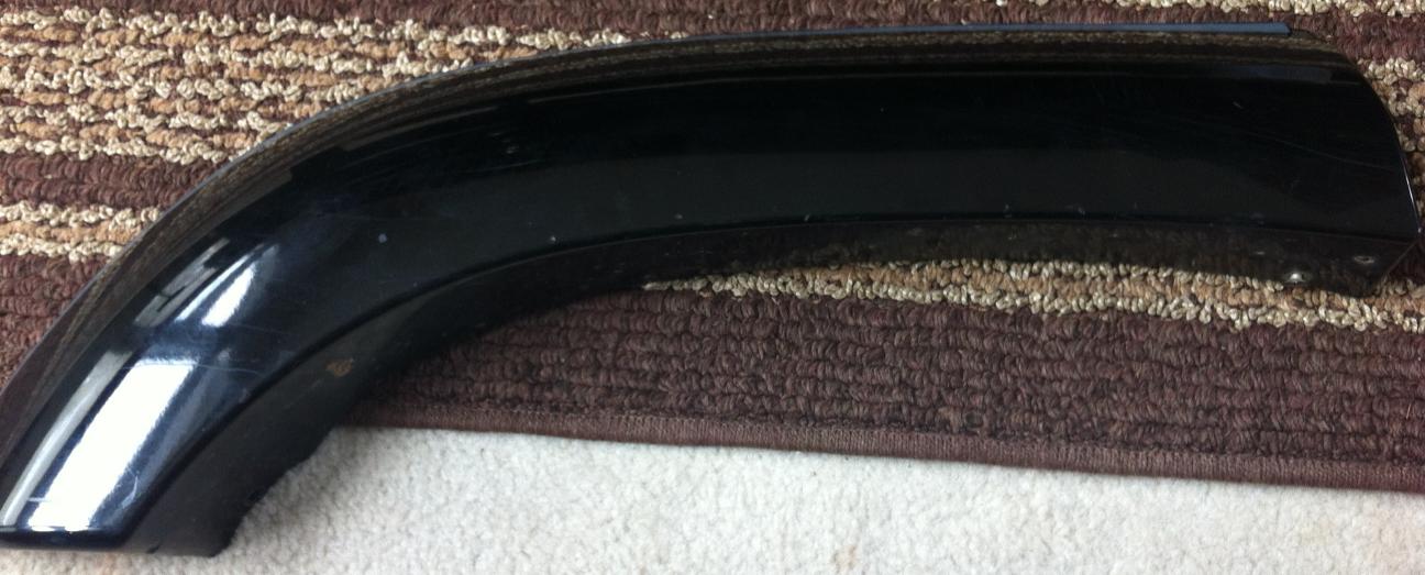

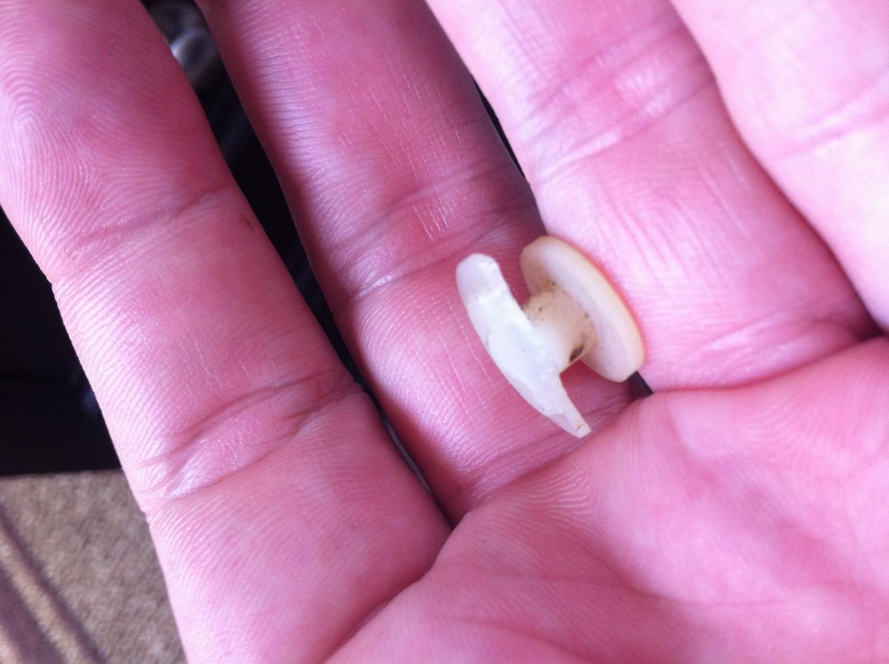

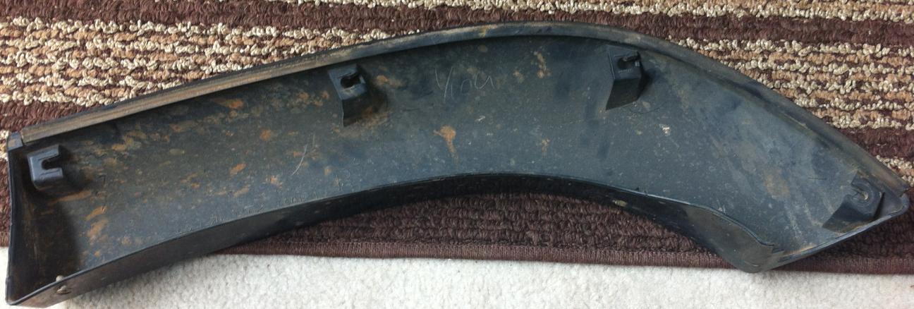

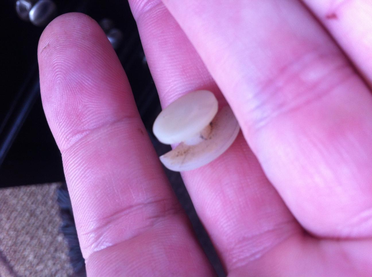

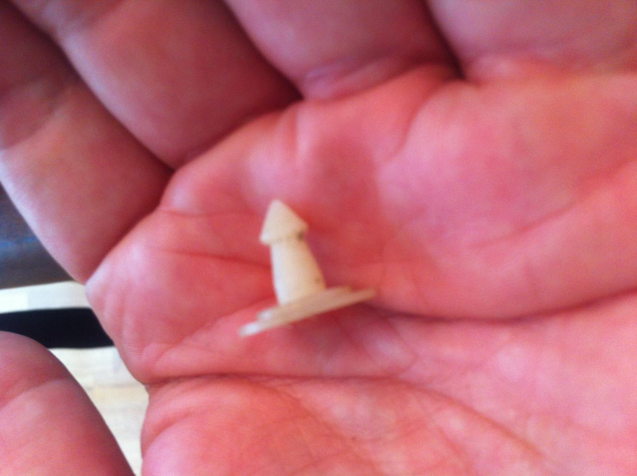

I am looking for the part #s for a couple of attachment pieces for the passenger side rear fender flare for a 2000 SR5 4Runner. The guy at the parts counter at my "usual" dealership couldn't find them...he said they were an option supplied by Bushwhacker? Not sure if he knew what he was talking about. I only had one piece of a broken one with me, and it didn't have the "point" on it, so he couldn't find one close, he said. Ugh...an hour of my life I'll never get back (driving over, waiting on him for a half hour or so...).
So, I did some more research online and could only find the fender flare clips for the front fenders (67771-28020). Are the ones on the back the same? The pics in the diagrams aren't nearly detailed enough for me to tell if they are the same.

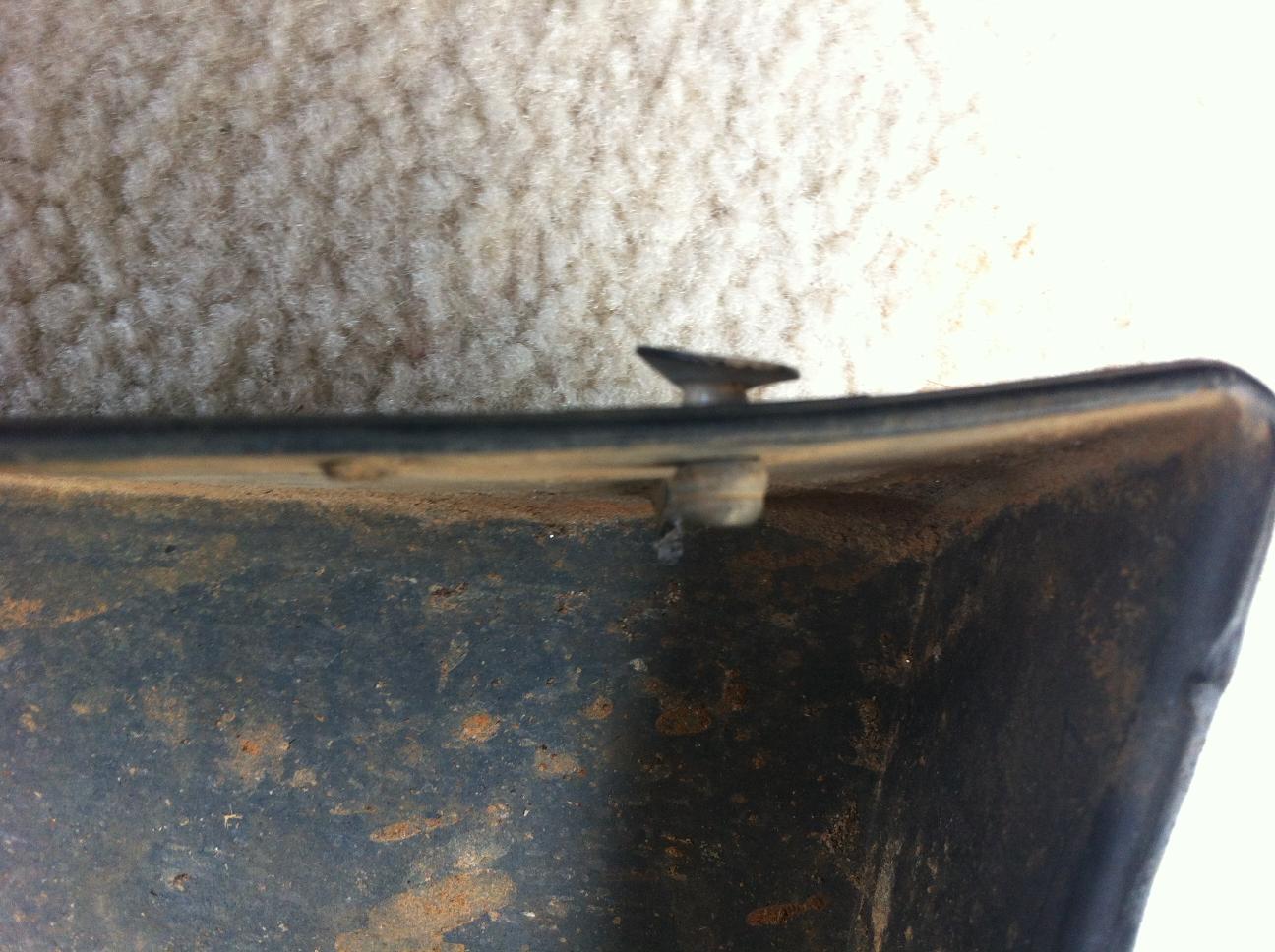

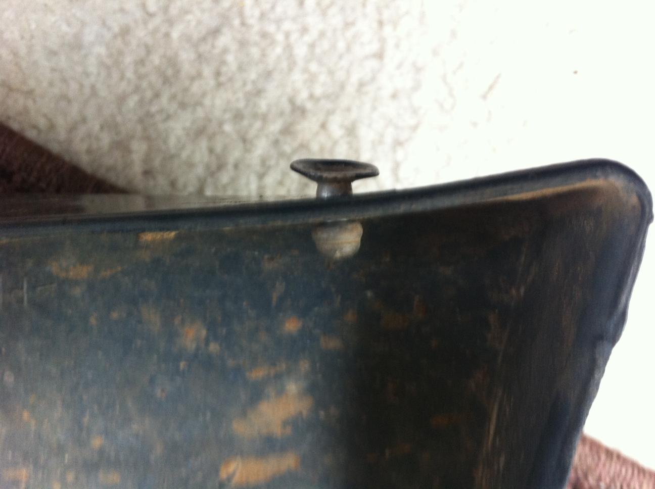

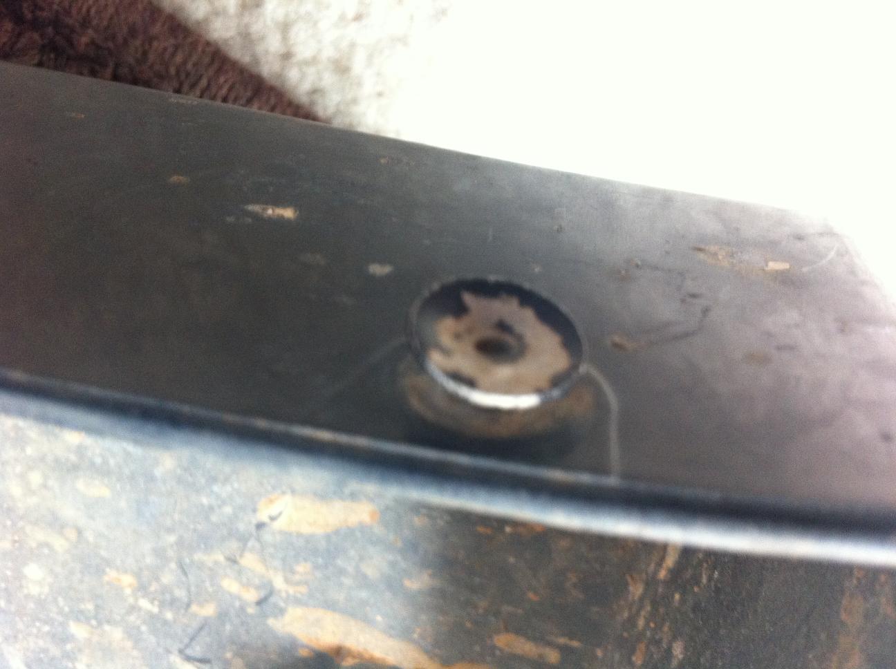

Also, there are what looks like rivets on the bottom side of the flare. I only have one remaining. Anyone know what part # this is?

I looked through all ~2000 or so clips and this is the closest thing...not a Toyota part. It might work...
Nissan, Cowl Vent Retainer, White Nylon. Top Head Diameter 13mm, Bottom Head Dia Auto Body Clips

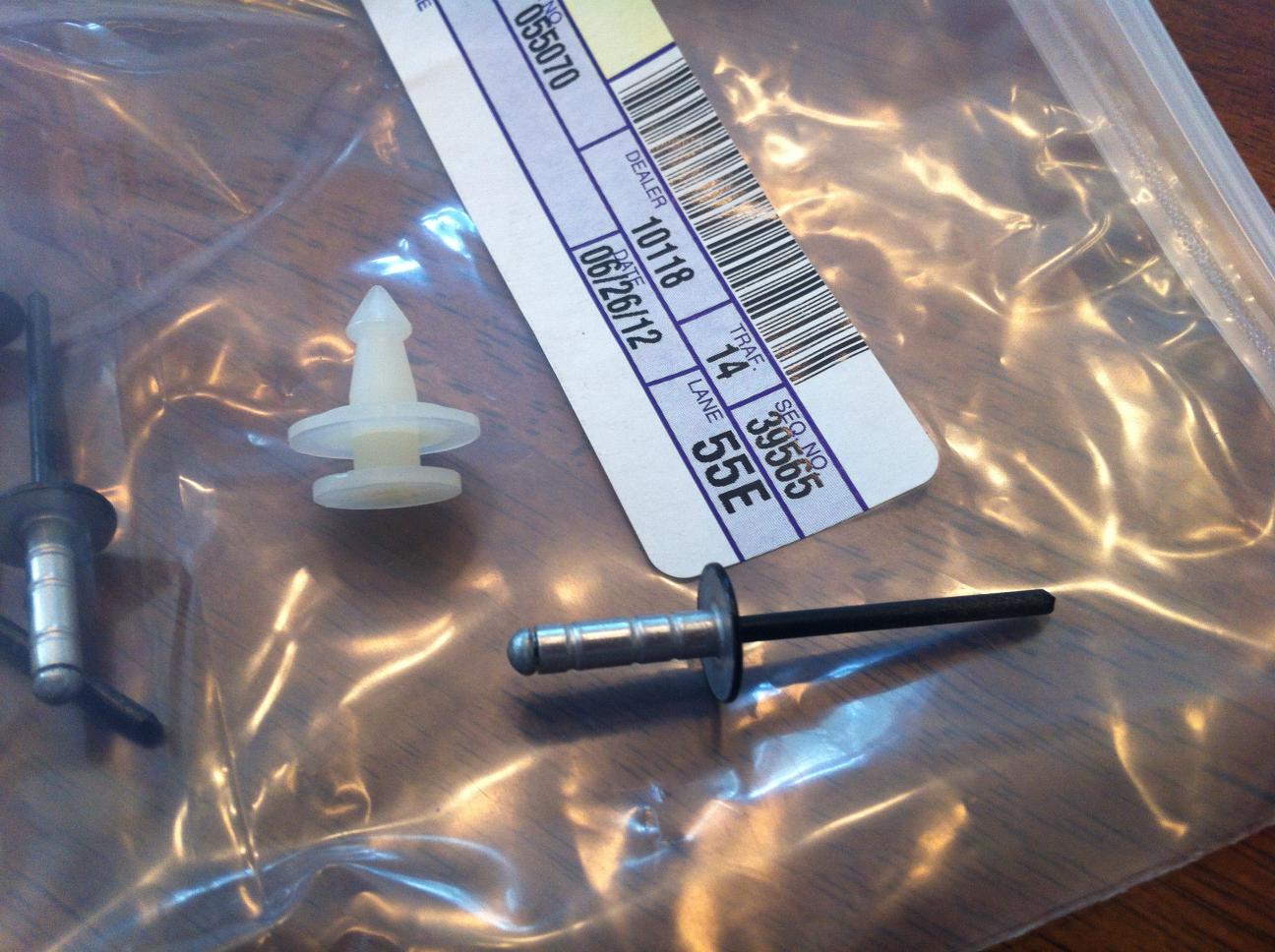

OK, well I went by the body shop I've used before today, and he got on the phone with a different Toyota dealer and found me the part #s. Huzzah!
Clip/pin (white one) - 90249-06132 $3.99 ea (!)
Rivet - 90269-04047 $0.83 ea
So, I then called my closer dealership (the one I went to the other day) and got a new parts person to look up these part #s and they had 'em in stock. The rivet doesn't look like I expected. I guess the long black part of the rivet gets cut off by the gun.
I was toldI need a pop rivet gun to attach the rivets...never used one...guess I will be borrowing or buying one soon (depending on how much it costs, of course!). The white pins are all that are really needed to hold it on, cuz the rivets are gone from my driver's side, too, with no noticeable difference. Thought I would be thorough, though and try and do the rivets.

Oh, and another thing...the parts guy was TOTALLY wrong about these not being Toyota parts. When I went to the body shop, he pointed out the Toyota marks and part # in the flare. Duh...not sure why I didn't start with that.
That part # is 75605-35900.
