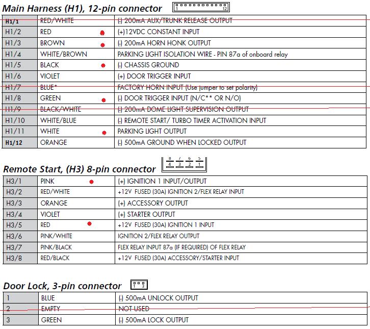

the red dots are what i have hooked up and are right. the crossed out ones i dont need. do i need any more hooked up from the H3 connector? thanks

yes it has power locks. and had a karr 2040a in it but i never had the remote.
when i hook up the lock/unlock where the old alarm was plugged into i am unable to use the unlock button on the drivers door and the remote still does not work to unlock/lock.
The horn and lights flash when i press the remote buttons like they should though.
clearly i have the lock/unlock wires in the wrong place but i have tried multiple places and still nothing, or theres a chance its not getting enough power ... ?
did u make sure u unplug the karr alarm harness from the box? maybe u might need a relay hook up to the lock and unlock wire,
yeah i took the karr alarm out completly. and yeah a relay sounds like what i might need, im going to try again in the morning making sure everything is right and ill post back here tommaro
