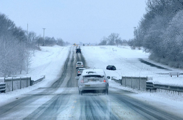

One thing that hasn't really been mentioned in this thread is that when people talk about "driving in snow" there are really two very different situations.
One is what I would call "winter conditions", which would be driving on paved roads with ice, packed snow, or a few inches of loose snow/slush. This is the kind of driving that you regularly have to do in the winter if you live in a cold climate:
These roads can be incredibly slippery and the primary problem is maintaining traction so that you can safely brake and steer.
Hands down, the best piece of equipment for slippery winter roads is a good set of *winter* tires. More important than 4x4, locking diff, etc. Winter tires are made of a softer rubber so they stay grippy at cold temperatures, and the tread pattern is designed for ice and snow. Big fat wide A/T tires are not that good in conditions like this. (In fact some tire manufacturer recommend *narrower* tires for winter conditions to increase the contact pressure and let you cut through snow better to maintain contact with the road.)
As [MENTION=113611]m85476585[/MENTION] said above, a locked diff can actually hurt you in these situations because they force some of the wheels to slip when turning. I would only lock a center (or rear) diff if you were truly stuck.
