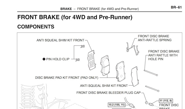

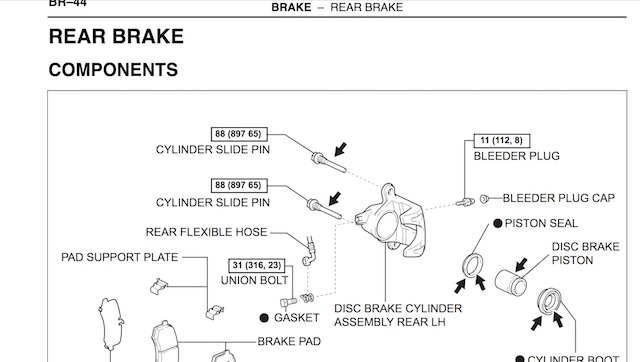

Not sure about your use of "slider pin" terminology, which is why I asked. The front calipers don't slide during brake actuation, they are monoblock design and therefore do not have slider pins. The rear calipers do slide.
See shop manual pics below. The front pins are "anti rattle" because, again, the front calipers do not move during actuation. The rears are "slide pins".
I call it a slider pin b/c EVERYONE (dealer/CarPartStores/etc) calls it that. Now that you cleared things up, I'm intrigued.
Thanks for the clarification.
