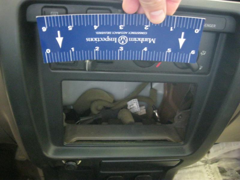

I just got 99 4runner from a local auction that has a radio ripped off (or stolen).
Should I just get a regular Toyota factory radio or something new perhaps even with Navigation or something?
Please, let me know what you think, here is the attached photo.
Thank you,
IL
You need the factory radio brackets and the aftermarket harness that plugs into the toyota harness. Buy whatever radio you want, it will mount to the factory brackets. If it is single din you need the metra toyota pocket to go under the radio. If it is double din no pocket is needed.
Do some searching, easy install, been covered on here many times.
Good luck.
