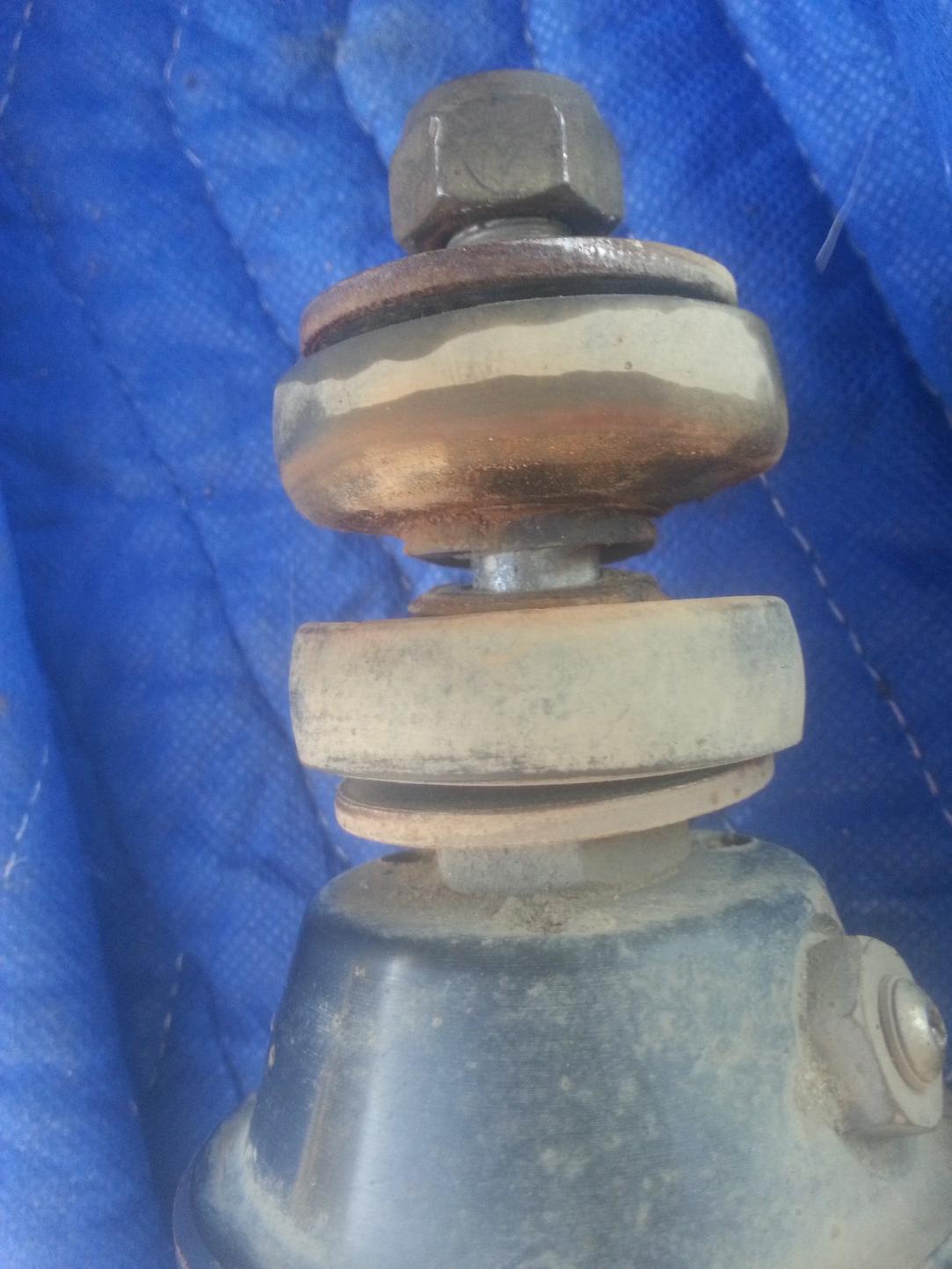

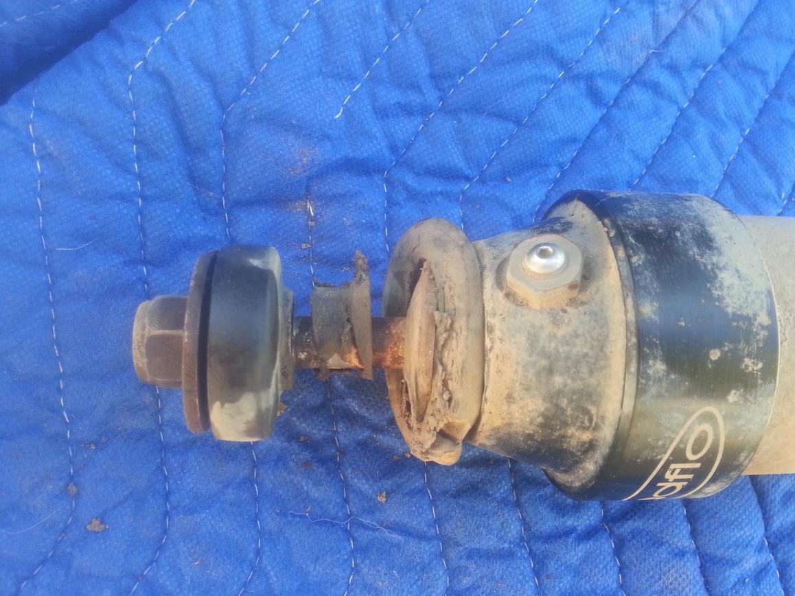

How many of you have removed rear shocks to find damaged bushings (upper)? I removed mine yesterday and found that the bushings on my radflo shocks were completely destroyed. I took a look at the stock bushings and they look a lot more durable because they have a metal 'plate' between the upper and lower rubber bushing. Have you just gone back to the manufacturer for replacement parts or did you come up with a better solution? The stock ones won't work since the 'pin' on the radflo is shorter and smaller diameter.

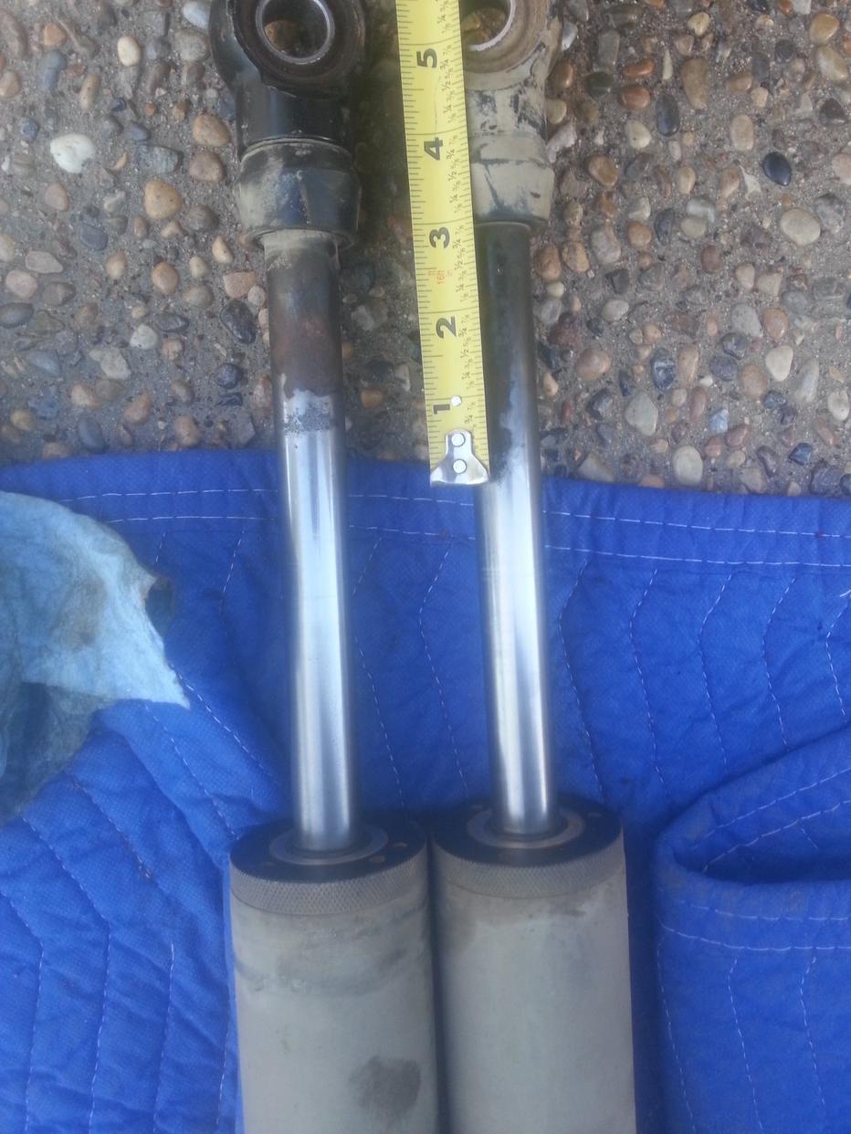

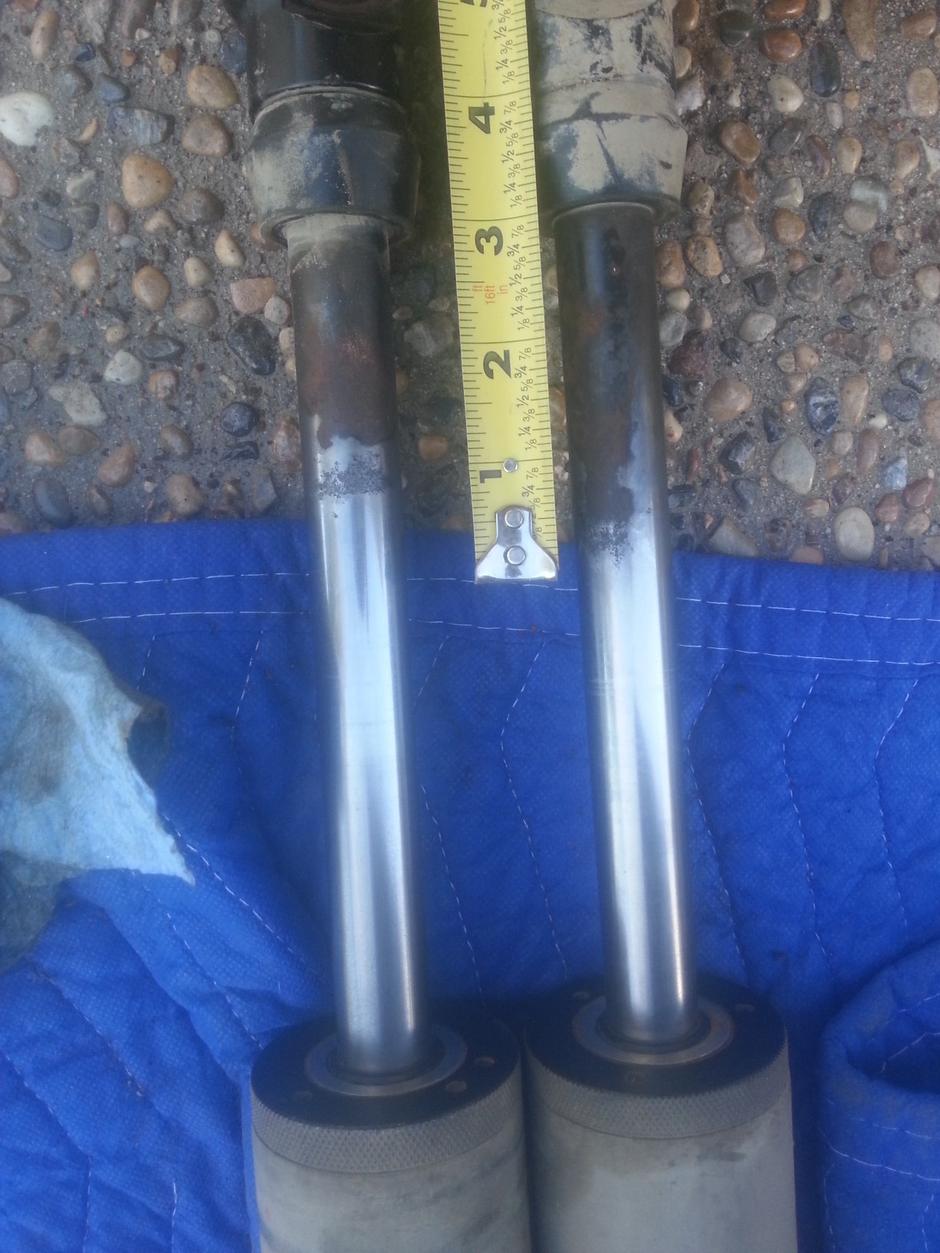

I forgot to mention, my other question is: how long up the stem is corrosion acceptable? The corrosion on mine extends 3" from the bumper.
Those look like they've had plenty of wear. How old are they? I'd contact Radflo for some addtional bushings. I'm sure they're inexpensive and they'll be correct.
Yea, they sell them. Just wondering if there is something better. I feel like these failed prematurely.
did you have them torqued correctly? I've had my radflos on for 30,000km or so, my bushings look perfect still. the top nut should be tightened to the point where the bushings just start to bulge. as for the shaft "corrosion", from what I have read this is fairly normal for Radflo unfortunately. perhaps one our resident engineers can comment, but from what I know of it, this kind of surface discolouration is inconsequential

Hard to know, I didnt install them. It's more then just discoloration, there is some pitting. Maybe I'll use some jb weld or something to smooth it out. I took the shocks completely apart last night, and like the front, there was fluid in the nitrogen chamber - which means the fluid bypassed the ifp seals. I guess I'm disappointed that I haven't gotten much life out of these. I'll rebuild them and use synthetic fluid instead of the stock stuff. I have a suspicion that when it gets to -40 degrees Celsius here the stock fluid is like peanut butter consistency. When that stuff gets forced through the valve, I'm guessing the pressure builds up too much causing it to blow past the seals.

Your shocks are trashed!
Buy new shafts, seal heads, and retainers with the allen set screw in it, and new spherical bearings for the lower rod ends.
DO not try and JB weld the pitting on the shaft, you will not get it fixed and cause way more damage to the seals when the shocks fully compresses.

DO NOT try and fill and fix the shafts. The reason they pitted is they never go inside the shocks for the wiper seals to clean off the shaft so the road grime/mud/dirt stays and starts rust.
I've rebuilt 100's of shocks and IMO you need new shocks shafts at least, They aren't that expensive.

Try very fine emery cloth and a lathe to knock down the rust that you have. But it will return with out the coating there. It will keep the shaft seals from getting cut as soon.
