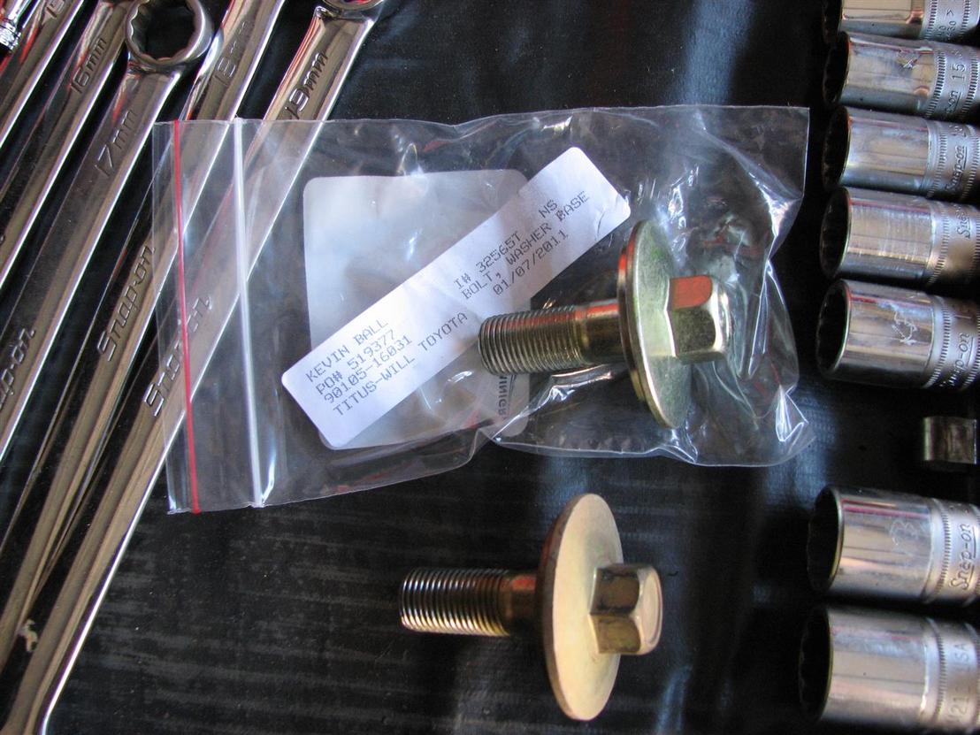

The bolt in my hand ordered by vin for the 99 (4/99) 4Runner is as The Durk said, 90119-16006.
A while ago when doing the timing belt on the 96 the parts guy got me the torque spec out of their shop 'puter- 217 ft lbs. Is it for trues? I don't have anything to say it is or isn't.
For the new bolt, 217 is correct. I have no idea if that much torque is a good idea with the old bolt which started out with an optimum torque of 184 ft lbs.
I did my timing belt back in 2011. I have a 96 and I ordered some parts from 1sttoyotaparts.com which is Titus Will Toyota in Washington. I got a bolt from them based on my VIN. This is what they sent me, a 16031, which is the earlier style bolt with built in washer. I torqued it to around 190+ and used blue Loctite and haven't had any issues.
