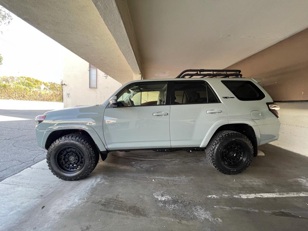

Wow! Thank you so much for your input. I love the financial aspect (I’m a personal finance nerd lol). Another reason why I’ve decided to go with the E load is because my rig currently has LT265/70/17 E BFG KO2s installed from the dealer with after market wheels. I didn’t want the wheels (crazy markup up) so the dealership is going to install the stock Terra Grapplers and TRD wheels as soon as they come in. I also realized that I didn’t mind the ride quality of the current setup. The E load aren’t that bad.
To your point, I won’t be rock crawling or doing extreme off roading at all. I will definitely go on easy to moderate off road trails though. I’m a photographer also so I enjoy going to remote locations. I guess going E load gives me more peace of mind. Don’t get me wrong, I’m still a little torn but I’m leaning towards E.
Here’s a picture of the wheels that are currently installed.
