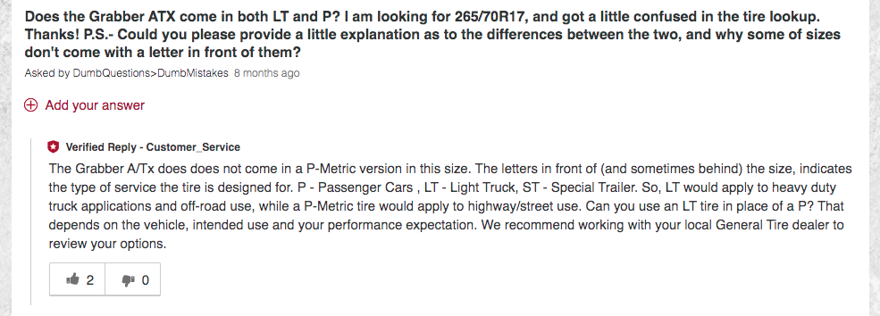

generaltire.com (ATX page) says that they don't offer a P rated... unless perhaps the answer has changed since that Q&A 8 months ago?

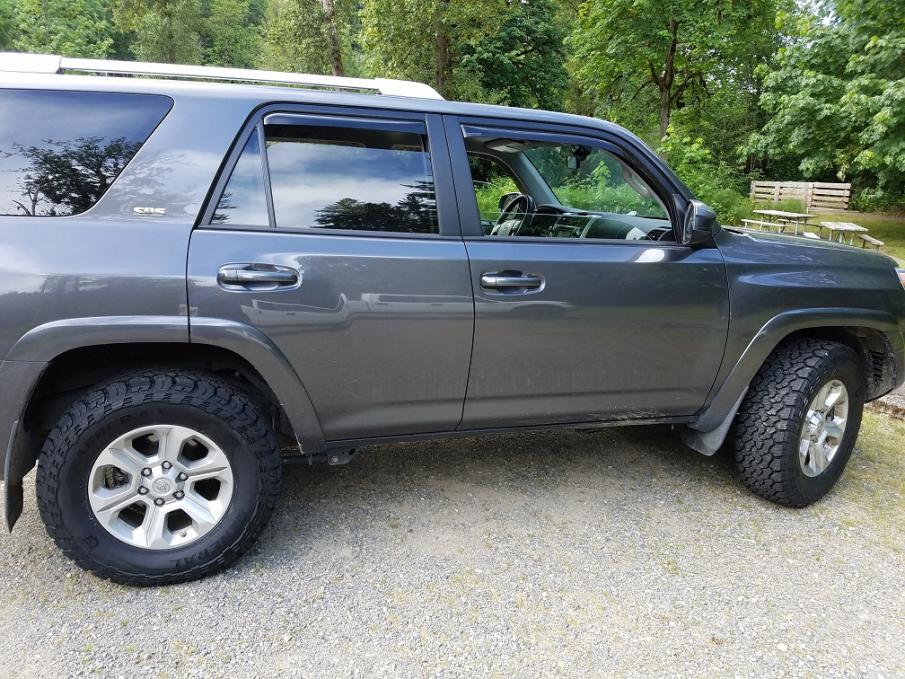

I have been running the General Grabber ATx for the past 3500 miles in stock size (265/70R17 - SL load rating) on my 12 TE. I replaced my stock tires with the Cooper AT3 very soon after purchasing it. The Coopers lasted almost 60k miles. The ATx is a much more aggressive AT tire and the traction that they have is impressive to say the least. The snow traction is phenomenal. We have had a lot of serious storms here in PA and I recently had them up in the Green Mountains of VT. The Atx bites very hard in deep stow and has great traction.
The ATx also looks fantastic. I don't think you need E rated tires unless you are carrying heavy loads or really destroying them off road (rocks and such). The weight of the T4R is more suited to the P or SL rated tire.

I got this response from General Tire:
SL stands for Standard Load and is what your vehicle came with from Toyota. Our non LT tires, unless they are OEM, come based on the ETRTO standard which means the Load Rating is higher. Ie your OEM tires were P265/70R17 113S SL, the 113 is the load carrying capacity, were the Grabber ATx is a (Hard Metric) 265/70R17 115T being able to carry more weight at the same pressure as you OEM tire.

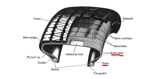

I asked General Tire: "When you say stiffer sidewalls on the E vs SL, is that primary simply to carry more weight or would it also impact sidewall resistance to puncture? My 4Runner is not (yet?) overweight... I haven't added a bunch of overlanding gear everywhere... but I do want reasonable resistance to tire damage. How much difference is there in resistance to tire damage between the SL and the E? Are the treads different or the same? Are the sidewalls different or the same? Different in what way? Other than bad luck, are the SL's generally sturdy enough for considerable off road use--in terms of avoiding damange/puncture? Thanks!"
They didn't answer about whether the treads were the same between the SL and E, but did answer in detail and with a drawing for the sidewalls:
"The Load range E tire will have more resistance to Puncture of sidewall damage than the SL tire. it is a benefit of having the higher load capacity. Stronger ply material and full 2 plys of material in the sidewall, as well as a taller bead filler (Apex) for added support below is an example of the SL tire. The SL ply only wraps the bead and comes ½ to ¾ up the sidewall. A LR E that ply is 2 full layers thick which helps deflect objects In the tread and sidewall. The LR E is overall a heavier duty tire and while not indestructible is heavier and more resistant to tears, scuffs and punctures. Downside is stiffer ride and heavy weight. But don’t get me wrong, the SL version is a capable tire and durable. If the question is “will the SL tire work with your vehicle and be a durable product?” yes, if your goal is Best possible durability, LR E is the answer."
