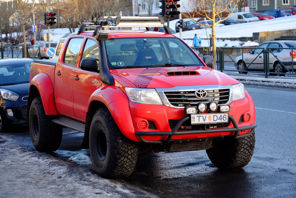

Unless you own something like this you're not going to be "floating" on snow:

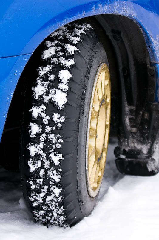

Traction is proportional to pressure (weight per unit area). A given weight will put more pressure on a smaller contact patch. Skinnies will always do better on any kind of firm soil, including snow and ice. They also steer better.
One example of this is why people put additional weight directly over a truck's rear axle to gain traction on a rear wheel drive truck. The contact patch doesn't change, but adding additional weight increases the pressure applied by the tires.
