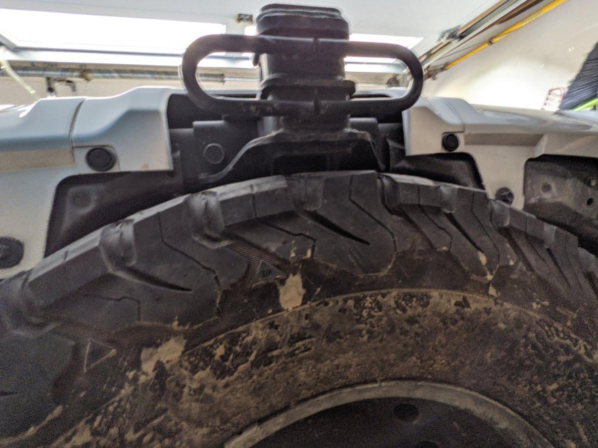

OP, the 285/70/17 fits just fine in the spare area. I have my KO2s in that size mounted up with no issues. It's a wider tire than stock so it hangs down a little lower, but it's not evident nor a hinderance, IMO.

And as previously mentioned, 285(at least K02) fit fine in spare tire spot.
OP, the extra clearance is nice in Anza Borrego with 285 but I understand not wanting to lug around the extra weight/lower MPG.

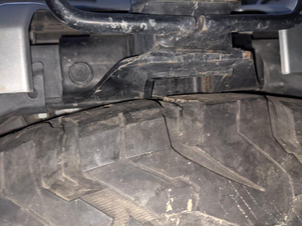

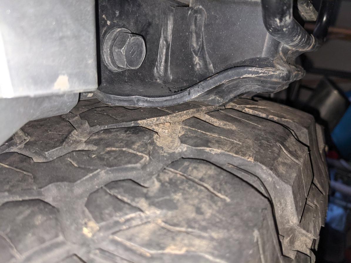

wow, it is a lot tighter then I expected.It is flush against the trailer hitch. Maybe the chain pulley pulls it flush to it?
These are actually used 285 KO2 and K02 supposedly run small for 285.

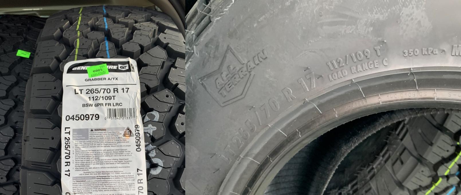

I’ll be damned, I just found the C rated tire on TR. It must be brand new. Just bought SL in stock size 2 months ago, son of a *****!
You're right, General Tire does not list a C load on their website. If this is real, it'd be great. Guess I'll send another inquiry to General Tire.

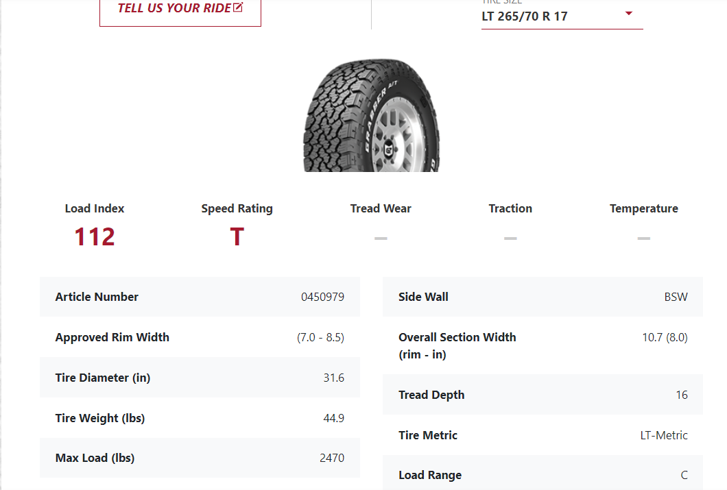

General Tire confirms that the 265/70R17 A/Tx does exist in a C load:
"We offer the Grabber A/Tx in an LT265/70R17 112/109T LRC, under part number 04509790000. We are currently experiencing a delay in site updates."
That said...
- The OEM tires are a 113S
- The A/Tx SL are 115T
- The A/Tx C are 112T
So the C are UNDER the original load rating for the vehicle (which I assume isn't good) and UNDER the load rating of the SL... which just flat out confuses me! I sent another question back to General Tire about that.

Got this back from General Tire:
"P-Metric tires are rated with a 10% overage in load capability when used on SUV's, Light Trucks, and Vans because of the difference in load handling. However, there is no 10% overage for LT tires. An SL tire has an equivalent 4 ply sidewall, while a C has a 6 ply sidewall, offering slightly more durability than the SL.
Part#: 04509790000
Pattern_Name: GRABBER A/TX
Description: LT265/70R17 112/109T FR GRABBER A/TX
Load Range: C
Load Index: 112 - 2469 lbs
Season: AS
UPC: 51342213313
Width: 10.43"
Rim Width: 17"
Secvtion Width: 10.7"
Overall Diameter: 31.61"
I asked a couple follow up questions and got this:
"The tire is 46 lbs. As for the load range E tires, they have an equivalent 10 ply rating."
That makes me particularly pissed that after ~30 days of hemming and hawing I bought SL-rated ATX's 3 months ago LOL.

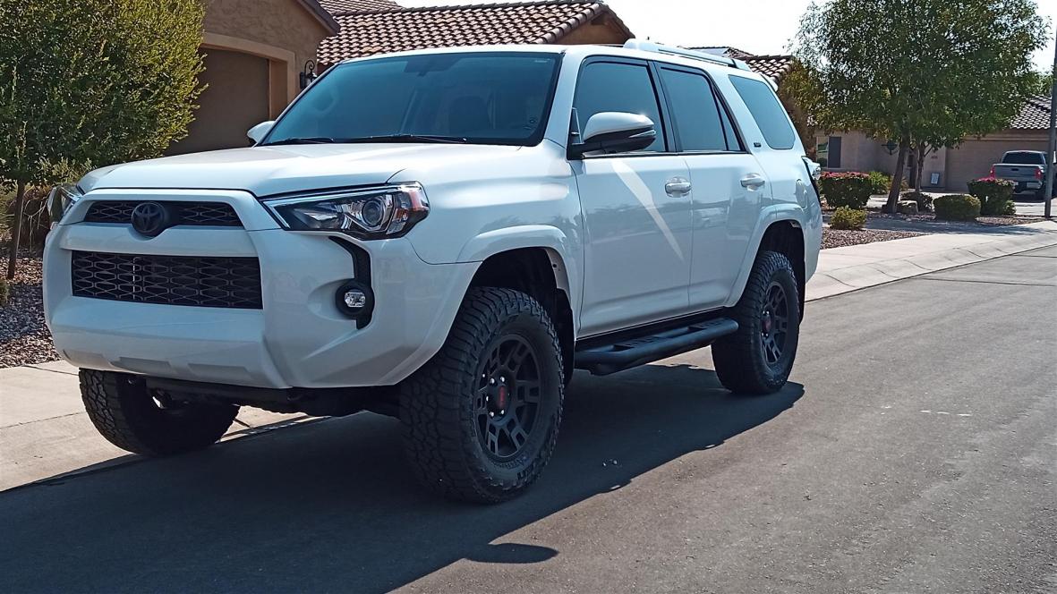

I used stock size wildpeaks on my 2018. They have been great on and off road (though the off road stuff is pretty mild).
