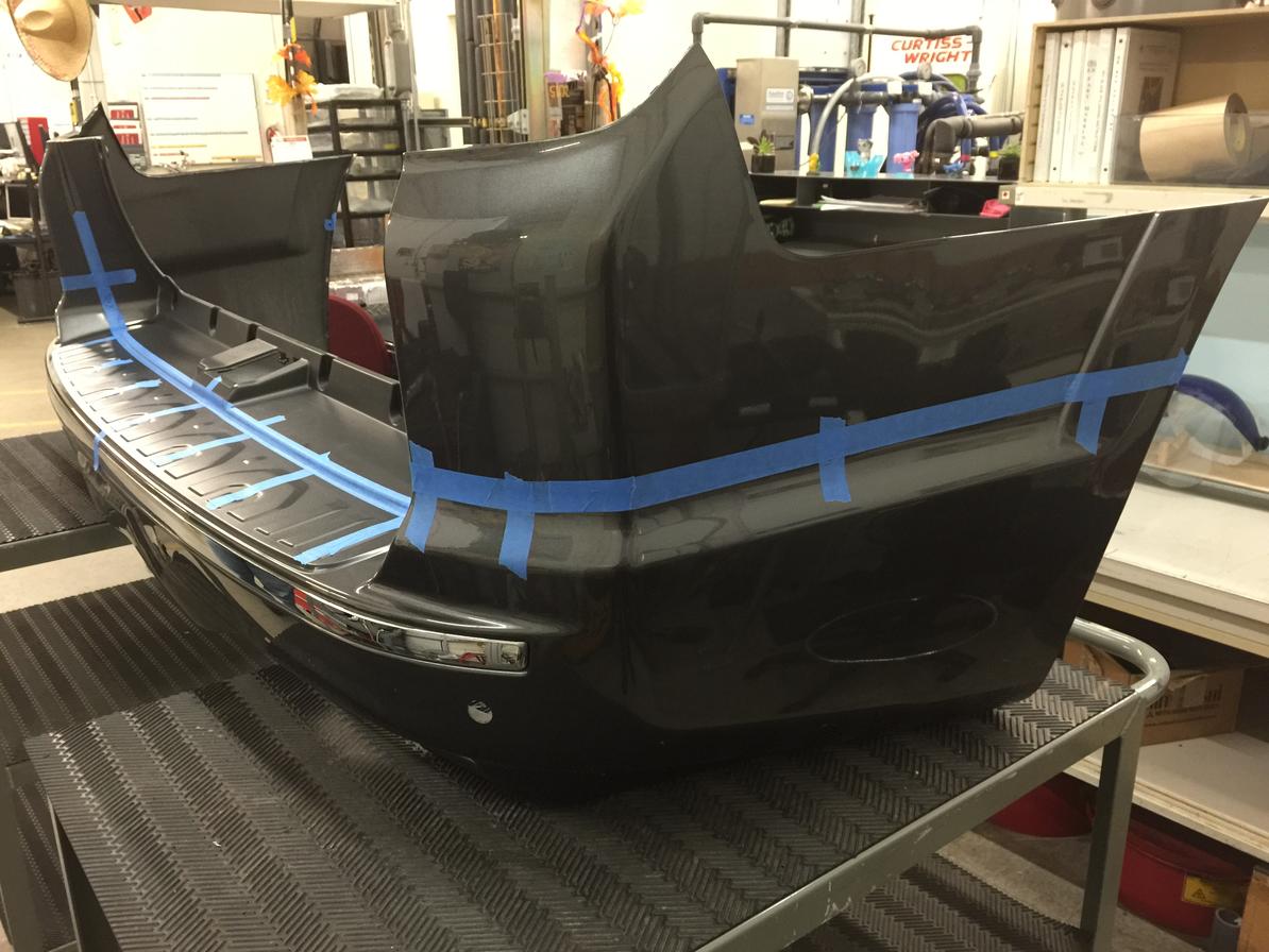

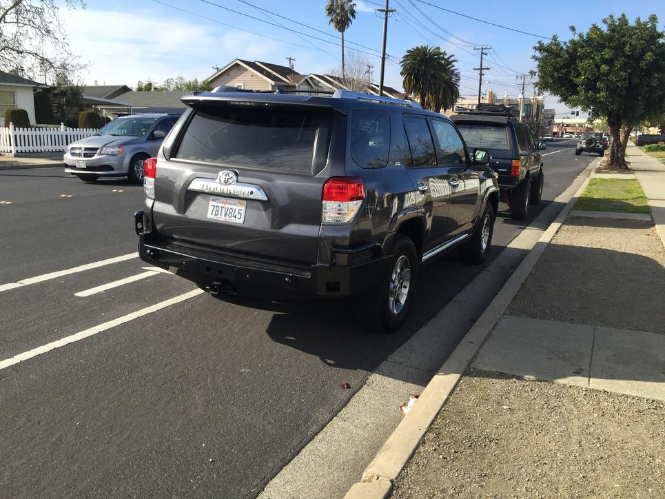

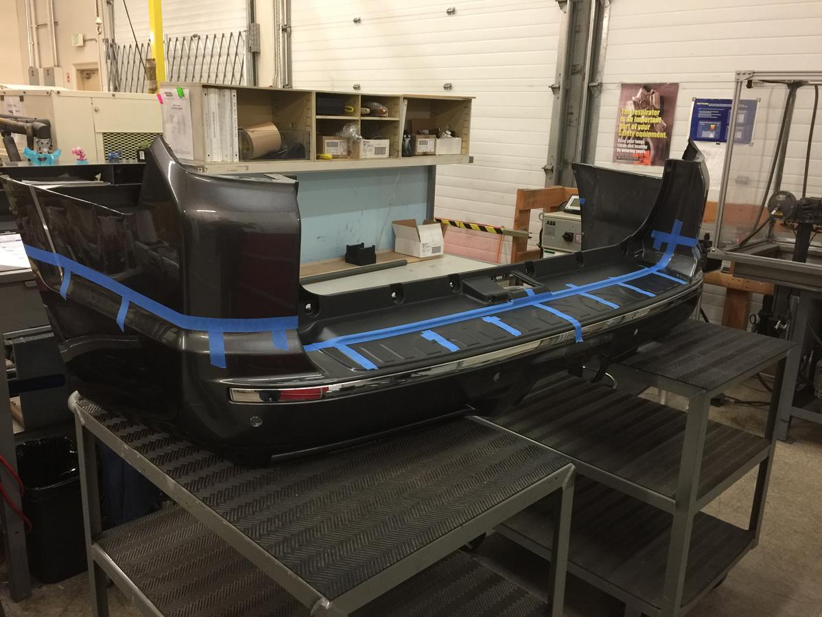

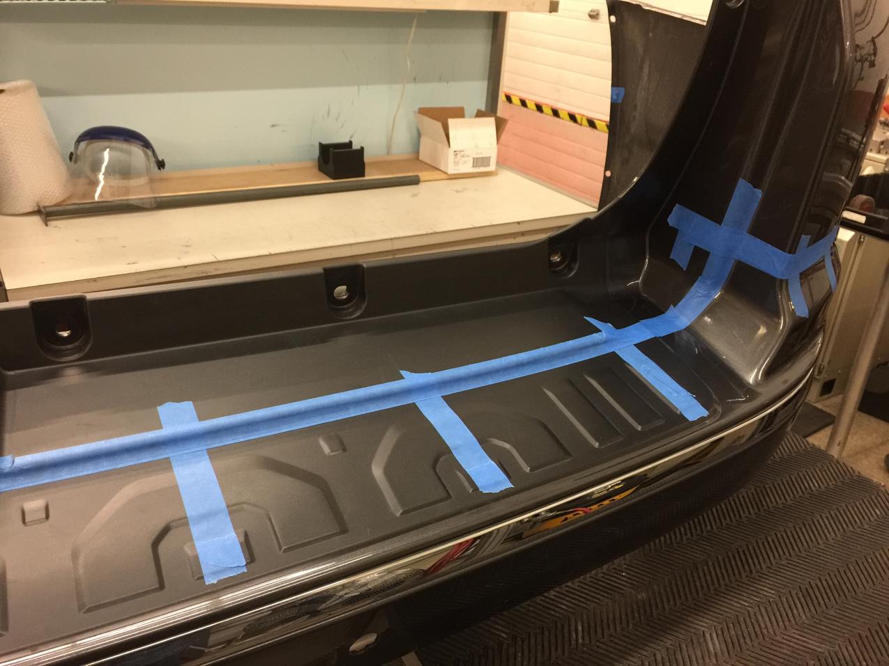

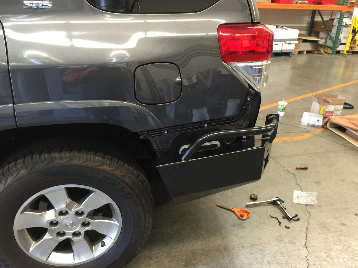

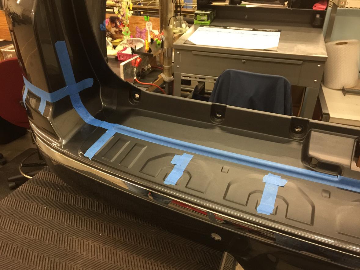

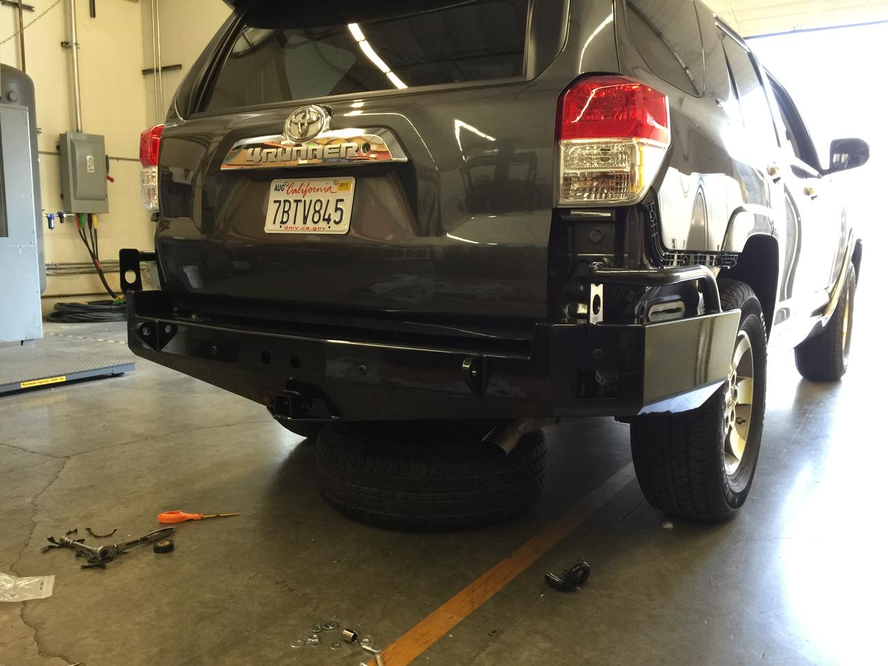

Had the same thing happen last year. Wife got rear ended in the 4runner and I did a cash out. She was at a red light and the a person 2 cars back said screw it and convinced themselves that the light turned green and just took off, not sure how they didn't see the car several feet in front of them. They caused a domino affect and the car directly behind my wife smash into the back of the 4runner. The bolts holding the receiver hitch cookie cuttered out the plastic bumper and a backup sensor got smashed. Insurance quoted the damage a little less then $1500, I got a second quote for $1600 and took a cash out at the higher price.
The cash out was enough to get a new CBI rear bumper (without the swing out tire carrier). The bumper is well built but they could have gone through a few more revisions to make it even more user friendly when doing the install. I call it lazy on there part and I know they could do better. That's the biggest negative I have about it and will explain the issues below but besides that everything else was great.
I popped off the plastic skin, misc. brackets, and mud flaps to do a test fit. First fitment issues is the exhaust, I ended up cutting the tip off. The second fitment issue was the body bolts coming in contact with the side support tubes. Both of these issues could have been addressed if they re-did the location of these side support tubes (this is the part that pissed me off the most). Once that was addressed the bumper mounted up fine. The cutting instructions for the OEM plastic cover was not very clear but I found enough pictures online to help me figure it out. This step probably took the longest and I probably ended up taking the bumper on and off about a dozen times for some fine adjustments. I got it pretty damn good though where I didn't have to use their trim channel to cover up my cut line. One last thing was the spare tire mount under the bumper, my SR5 factory spare tire fits but I'm not sure if I can squeeze a 285 under there, I have heard you could but haven't tried it or seen pictures of it done.
Once I got it installed I was pretty happy with the end result. There was one more issue that I found out about several weeks later, when driving the upper section of the plastic bumper flaps at highway speeds. I think this is a pretty big no no and another thing CBI missed and did not address. I might be able to modify my mud flaps and remount them and in-doing so add support to the plastic upper section and minimize this flapping. Wife also actually mentioned it when she was washing the 4runner "I don't like how this area flops around when I put pressure on it".
So some feedback to CBI, fix the clearance issue with the body bolts, and the exhaust, address the floppy side panel, and get better illustrations for the instruction section of how to cut the existing plastic bumper cover and your product will go from a B to an A. Now if they want to go the distance they would have an A ++ product if they can figure out how to make the cutting job of the existing plastic bumper easier but that might be very challenging.

Ohh and to add, if you were to ask me would I do it again then the answer is yes. I think its a good product and I really like the look of it.

Actually saw her driving around a while ago. Couldn't get her attention. Why no tire carrier?
Yah same thing happens to me, I've driven by her and was waving like a moron and she just drives on by. I haven't seen yours around, I usually see a blue Trail that drive around town.
I decided not to go with the tire carrier cause the 4runner is my wifes daily driver and figured it might be a bigger pain for her to deal with. It also would have forced me to relocated the backup camera and backup sensors, and finally I read that a 285 would still fit under the back so why let good storage space go to waste (hopefully it will fit cause my stocks spare doesn't have much more room under there).
