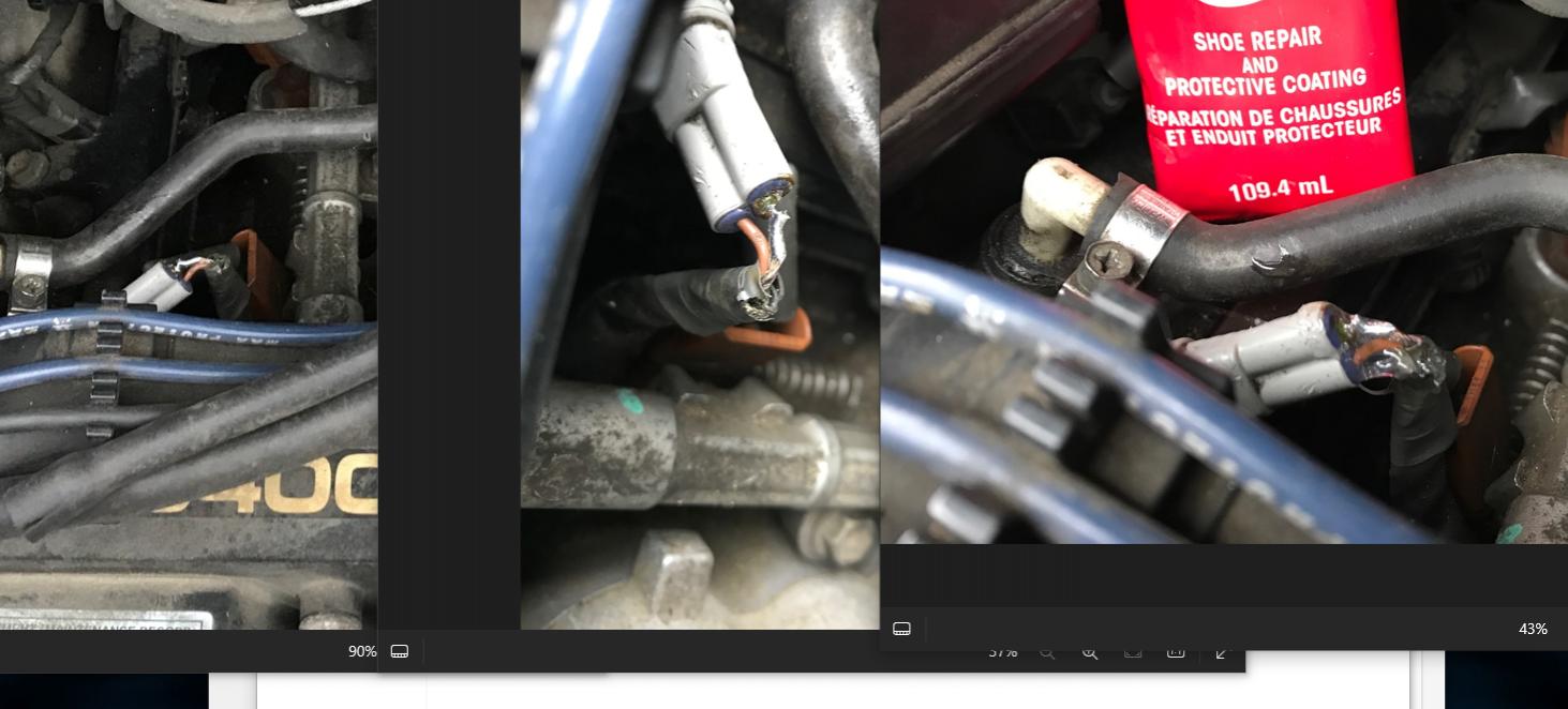

Just fixed my P0115 error. My truck was very hard to start this morning; but basically a no-start situation. Starter and electricity seemed strong, tho, but wouldn't fire up. CEL was P0115. Did some searching and found this thread. When I went to find and examine the ECT sensor, low and behold one of the wires was broke.
The pigtail on my ECT sensor at the front, top of the engine had a broken wire at the harness connector. I was able to halfassedly solder the wire back together and then I used some Shoe-Goo to seal and reinforce it. I'm not expecting it to last too long, but I was quite happy to have less than 24hrs downtime and should be able to drive to work tomorrow.
Aiming to do a better fix/replace sooner than later. Looks like the sensor might be perfectly fine and this might last longer than it should, but should be good for now. Hopefully this helps others in a pinch. Sorry, I didn't get a photo of the before situation, but you can imagine that soldering wire being broken at the connector with about 1mm of questionable wire accessible. I wasn't expecting to be able to get any solder to stick but I lucked out. Then lucked out even further being able to get the loose wire to stick to it.
