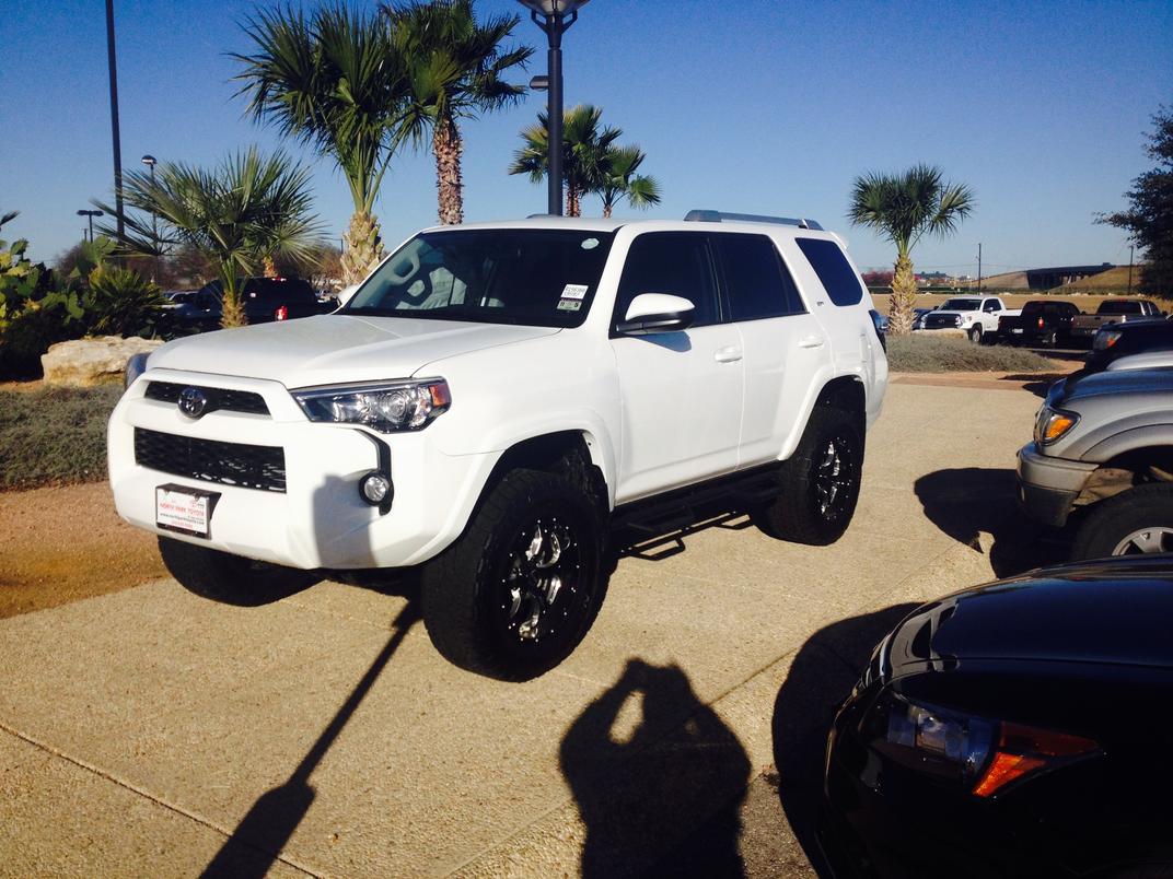

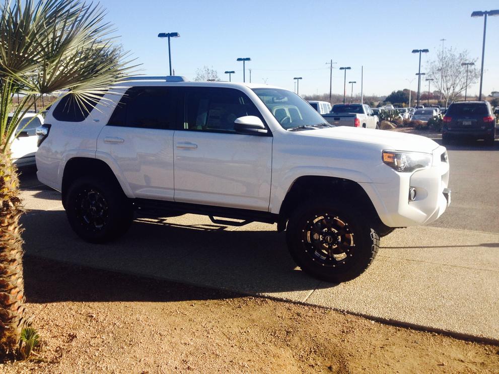

2013's will fit. The only real changes have been to the nose and lights. I ordered a set of Nfab's because I liked the way they looked on an SR5 at the dealer. Here is a picture of said SR5, which also happened to have a 3" lift on it. Easy to install. Just ignore the instructions that say the short stub goes forward. The bowed stub goes forward. They are available in any color you want as long as it's black.

Any running board, rock sliders or nerf bars for a 2010+ trail edition will work on a 2014 sr5. Don't get ones made for a 2010-2013 sr5 or limited or you will have a 4" gap.

Anyway, these are the same as in 3wbdriver's post above and I can recommend them for getting in and out of the truck. Just follow his advice and take the installation instructions with a grain of salt.
