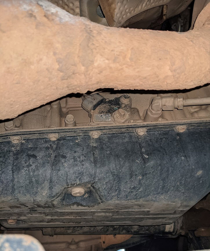

Have a 2016 4R with 53,000 mile and the SNS went . All the check engine, TRAC light, and 4LO flashing were showing. Hard to put into gear, once into D nothing, engine merely revved, and took several minutes to ultimately engage. Finally, on way to dealer, at 45 miles an hour, I was getting 3000 rpms, as would not kick into a higher gear. On the advice of dealer, I called corporate. Gave them all the details, was put on hold for 35 minutes, so they could kick it to a supervisor, but with no decision. To call me back. I see it as faulty engineering, as the reason for the problems is excessive corrosion. I find that hard to stomach, particularly when the dealer told that with an excessive corroded part, the removal could damage the transmission and thus cost thousands. I do not intend to let this go, particularly when I read that others have had satisfaction in getting this reimbursed.

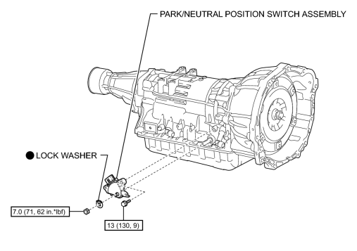

So last month my 4Runner had hard shifting using the gear selector over a period of time. It was barely noticeable. While my wife was driving, she said it was hard to use the pedals and her check engine and TRAC light came on. She drove straight to Toyota who later confirmed it was the transmission switch. The advisor said he has seen about 12 of these issues the past year and considering how many 4Runners are out there, it's pretty rare for it to happen. I guess we just got lucky. :tsk: Out the door price was $626. Everything feels smooth now and runs well.
That part is $150 MSRP and should take less than 15 minutes to replace. It has 1 wire harness, 1 bolt, and 1 clip, all easily reached on the side of the transmission.
