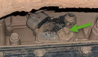

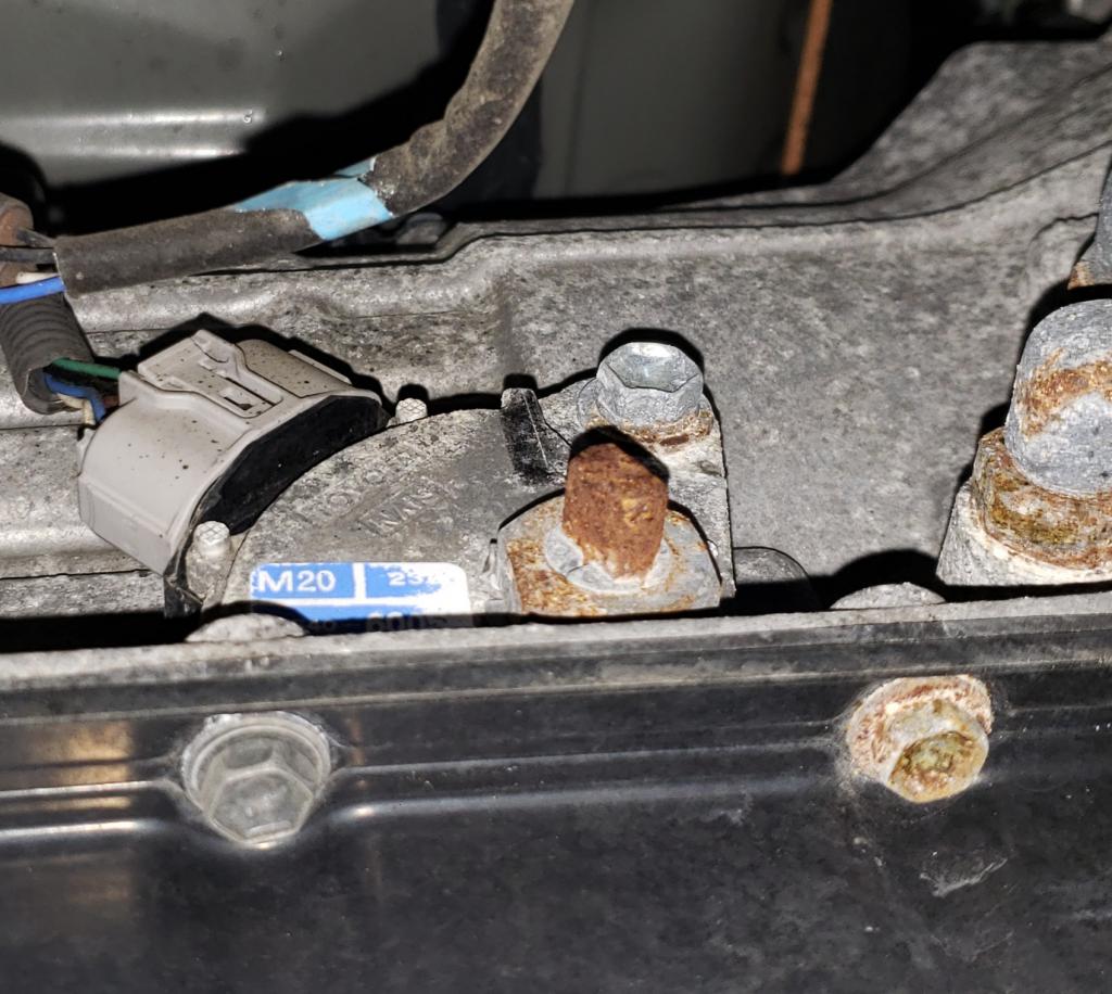

Are you talking about this? Pretty sure that is part of the trans and is not supposed to come off.
That square piece I known isn’t suppose to come off it’s that metal ring that’s on the switch that compresses onto the square part that’s stuck on there so we’ll that it completely popped out of the sensor when prying
See the metal ring that’s seize on the square piece it broke out of the sensor housing. So it’s becoming a challenge getting it off since there isn’t much room to work and get a good angle

Ah, that sucks, must be same reason KenWilliams's 6 hour job. I would probably go with a flex shaft on a die grinder with a carbide burr. Seems like a cutting wheel might be problematic in that small area. Might be worthwhile to remove the exhaust, but that may also have rust problems and likely need new gaskets.
What a pain in the ass
My question is with the new sensor does a replacement rubber oring come with it the one behind this nut didn’t fair well lol

Best, fast way is just cut the damn thing with Dremel or Oscillating Tool, just do not cut into center shaft, then insert flat slot screw driver to open it and remove it. clean rust on shaft, apply some grease and slide new in.

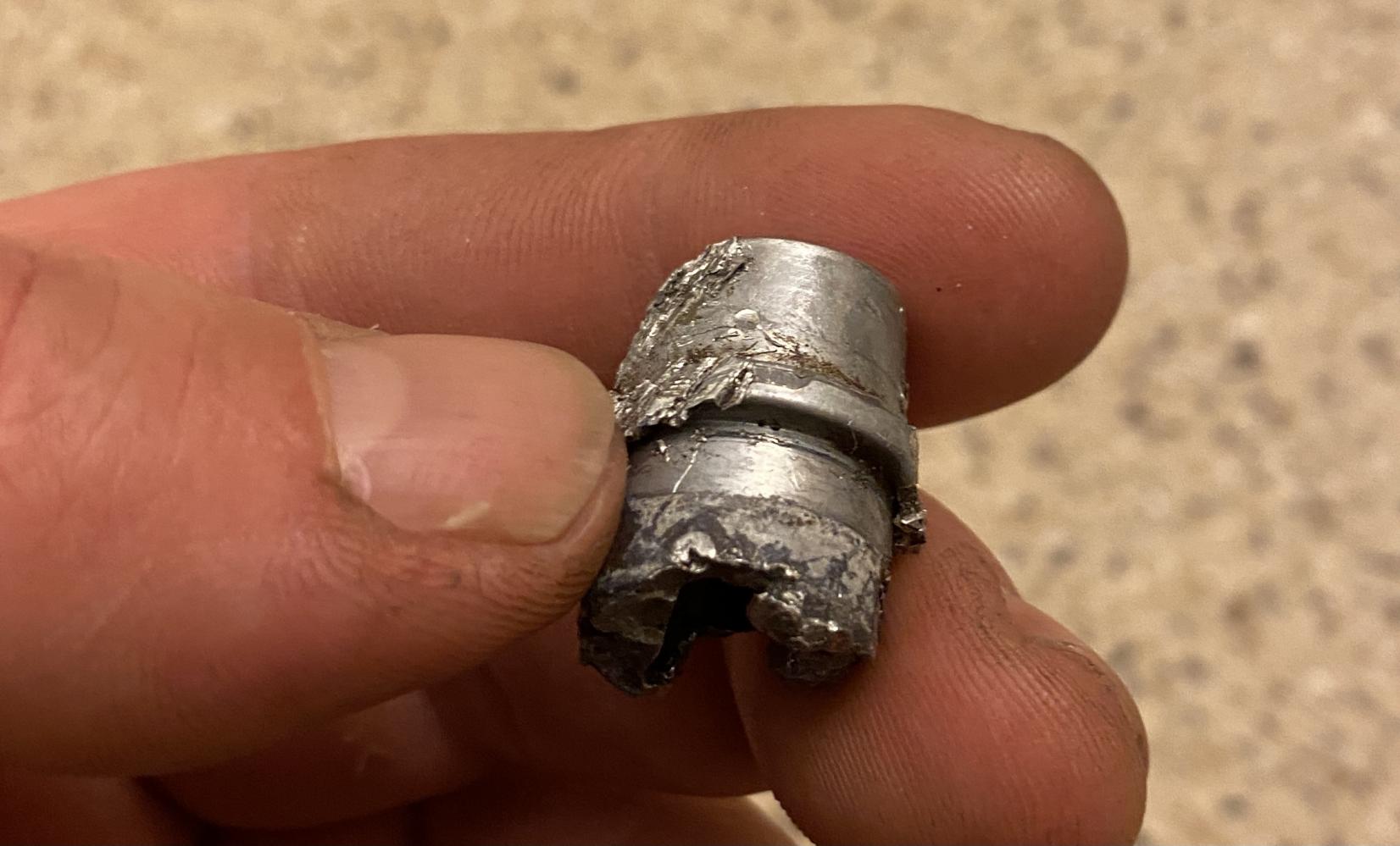

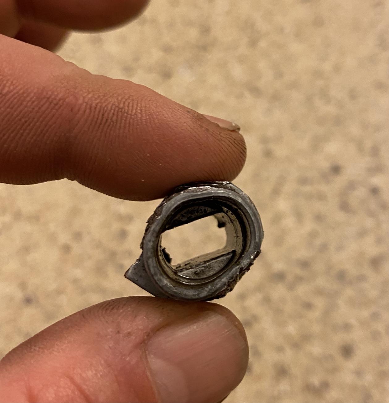

If this helps in the sensor breaks away from the compression collar what I did was take a dremal ever so gently and tried putting a seam on the top hoping a screw driving would finish the rest by splitting it open. After several f bombs i sprayed the hell out of it left it for the night. My hands took a beating they are to big to fit in the area.
The next night I took the good old trusting last ditch tool a small locking vicegrip locked it on the nut straight with the nut and the used a screw driver between the nut and teeth and pried back on the vice away from trans it moved a bit so I adjusted the wrench again repeating it over and over till it popped off.

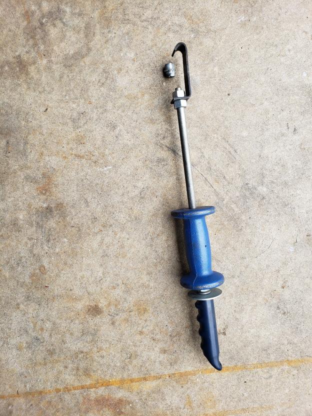

I got to this point and the visegrips wouldn't work for me. My secret weapon was a slide hammer. 4 or 5 taps and it slid right down the shaft. The dremel did no good at all. Couldn't get the right angle for a good cut. Clean the exposed shaft with some emery cloth and spray liberally with pb blaster. Applied some anti seize to shaft and dielectric grease around the collar when installing the new one.

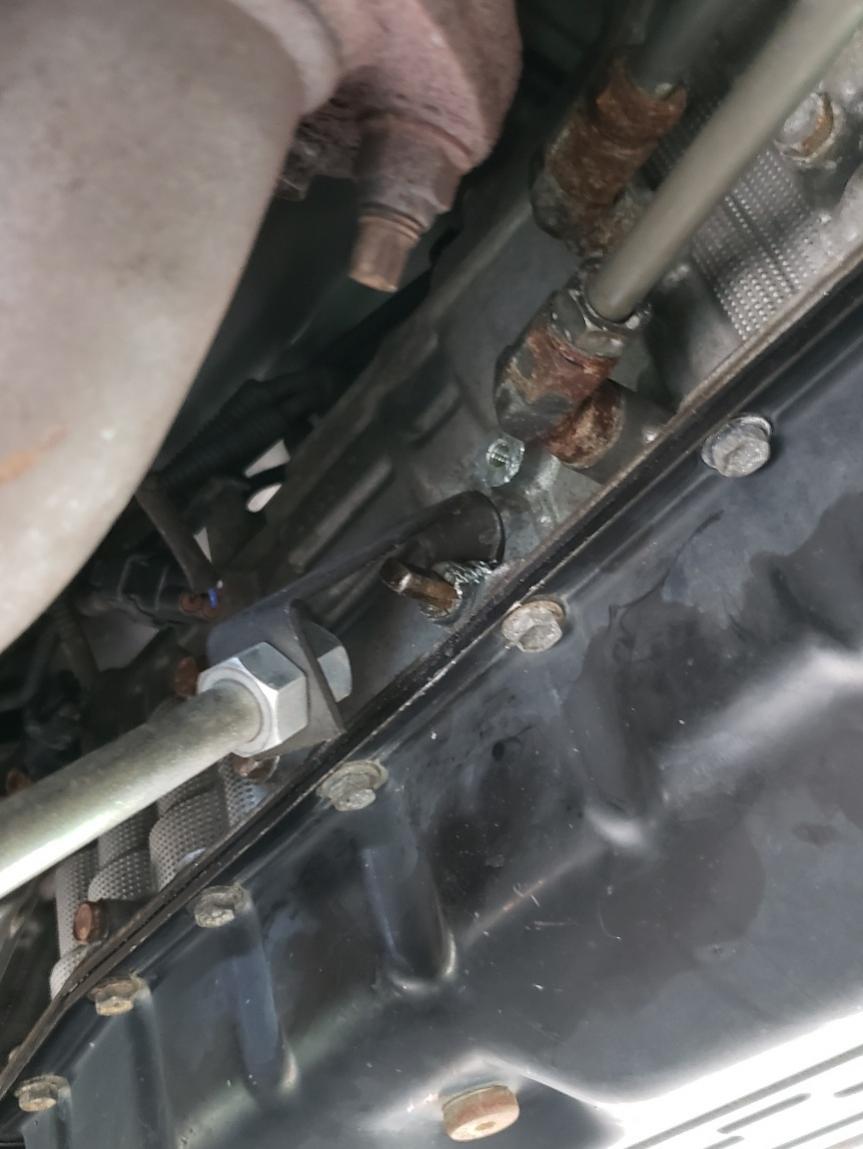

I too have this same stiff shifter and randomly it'll work fine, other days (especially after a rain) it malfunctions. I gearing up to try to purchase a replacement and have a go at it as well. been soaking it with penetrating oil on and Off in preparation, hoping I can get the part , i havent yet tried to find one, will begin this weekend, fingers crossed.
SO is there a retaining clip on that SHAFT protruding thru the NSS? or just that single bolt up above, and it will allegedly slide off towards me (if I'm lucky lol)?

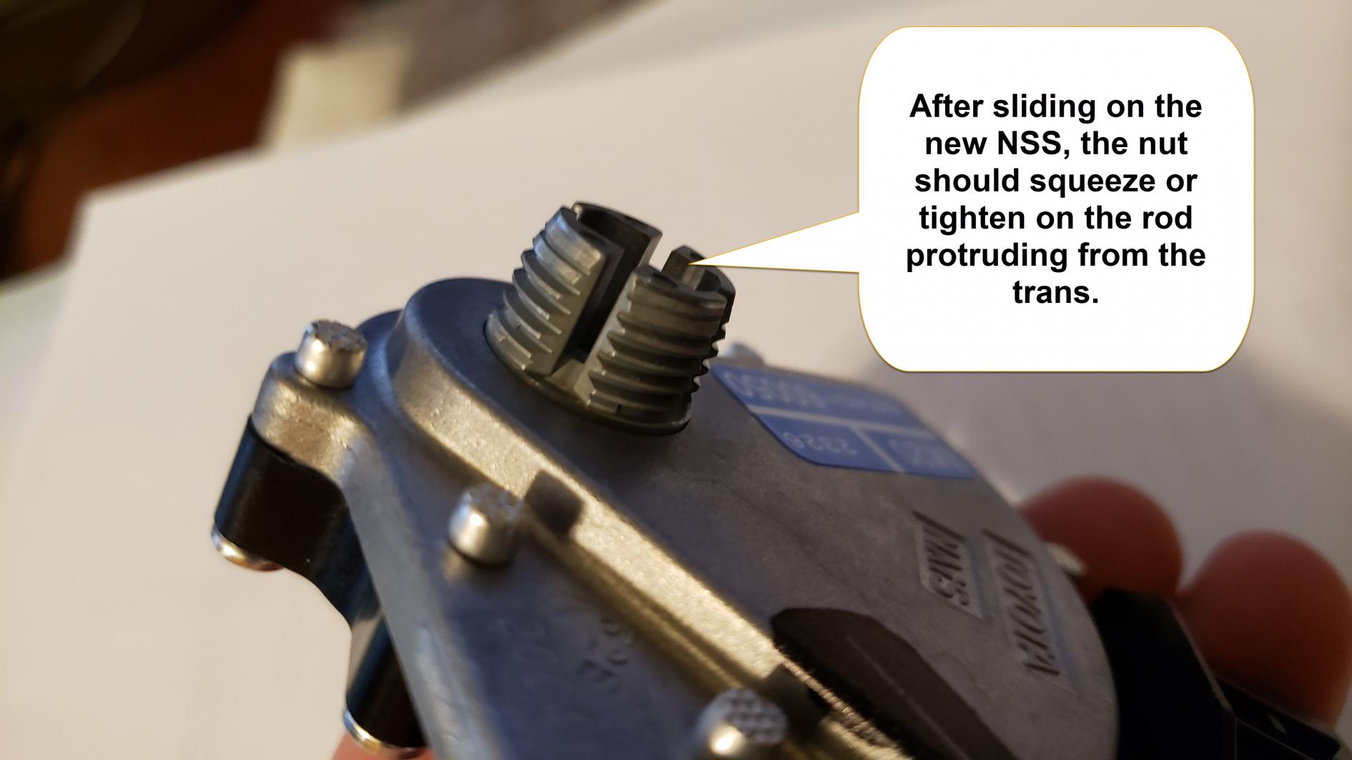

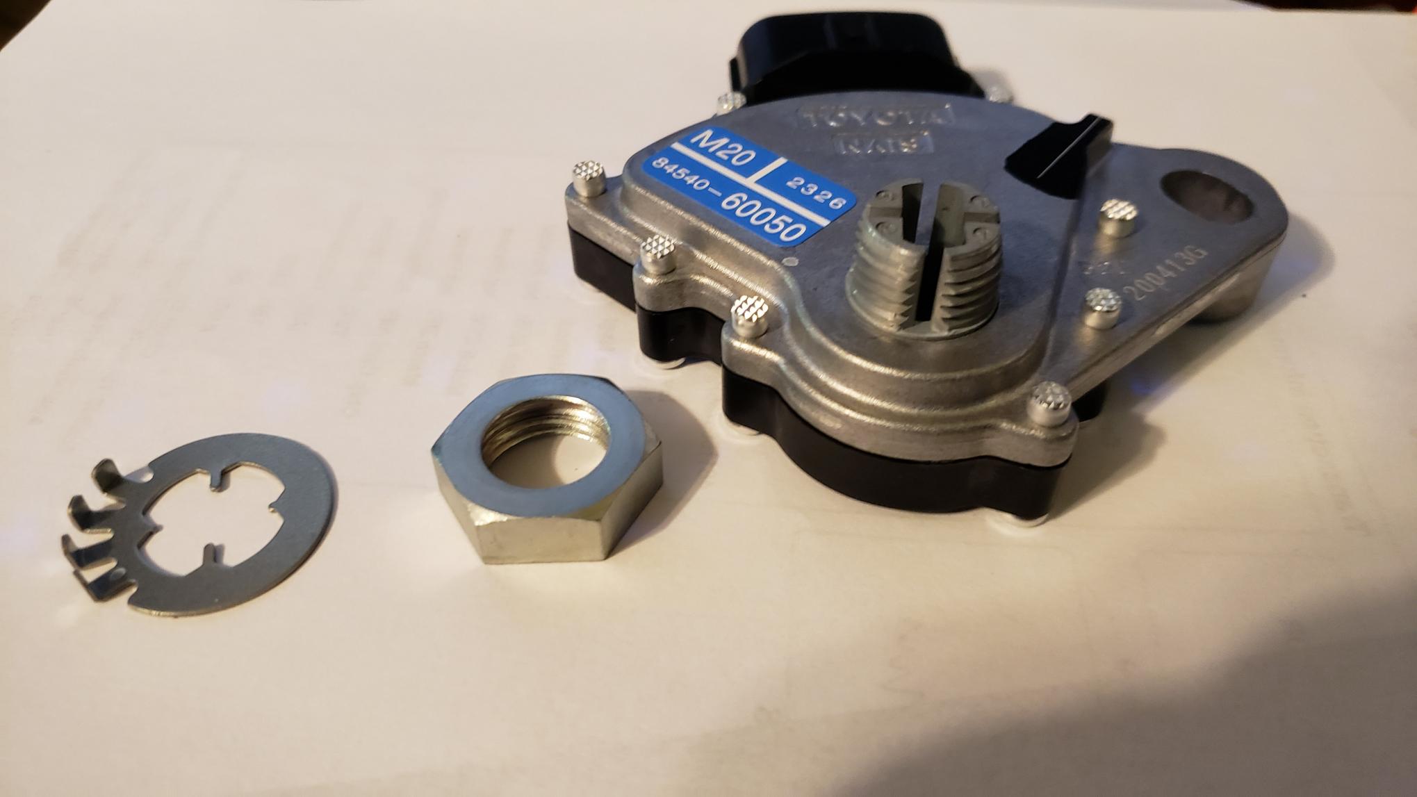

Update:
I was able to obtain a new NSS, I see now what folks are talking about where the unit might be corrosion or rust fused to the transmission rod. I see now this bolt with locking ring when tightened squeeze's the protruding shaft.
I'll try to post my experience removing the old one and fitting the replacement.
