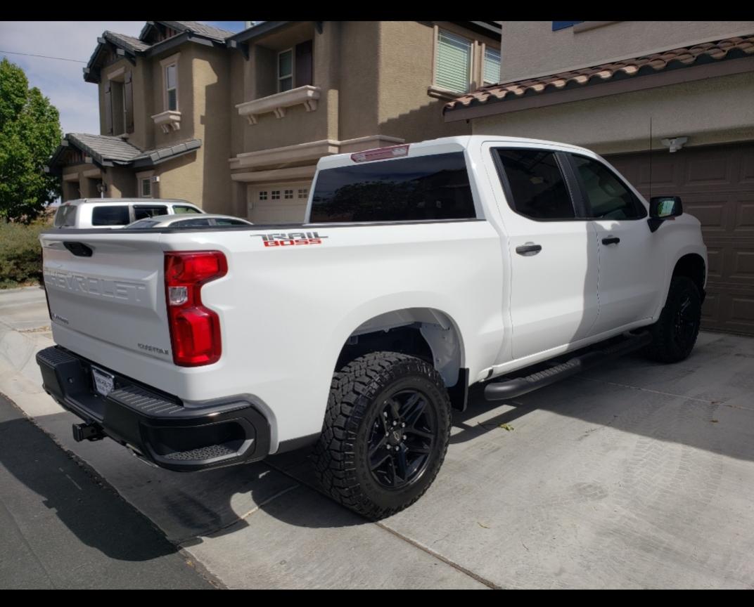

:( glad you came out on top tho. 1k isn't too bad. What did you end up getting?
2019 Silverado 1500 Trail Boss.
Got an offer I couldn't refuse. 10K of MSRP and 36K for my 4runner.
Wow yeah that's not too shabby at all. Super nice trucks. Love how roomy they are inside.
Enjoy that truck man.
Thanks bro! Hope she's reliable. I ain't buying another car for a long freaking time.
I did some reliability research and these seem to be doing good. We'll see.
For having such beefy tires, and off road shocks, it rides incredibly nice. I actually get less feedback on the steering wheel on this, than I did on the 4runner lol
$1K loss? That's awesome.
I lost $16K after driving my jeep srt for 2 years lol So take the $1K loss and celebrate!
Yup, plus what I spent on getting tint and new tires on the 4runner. So I'm out maybe $2,500 at the end.
Worth it to me to keep my sanity. #firstworldproblems
Glad your liking it. You will prob find off road at speed it's better than a 4runner. Generally my consensus on pickups is they ride significantly better than 4runners out of the box.
