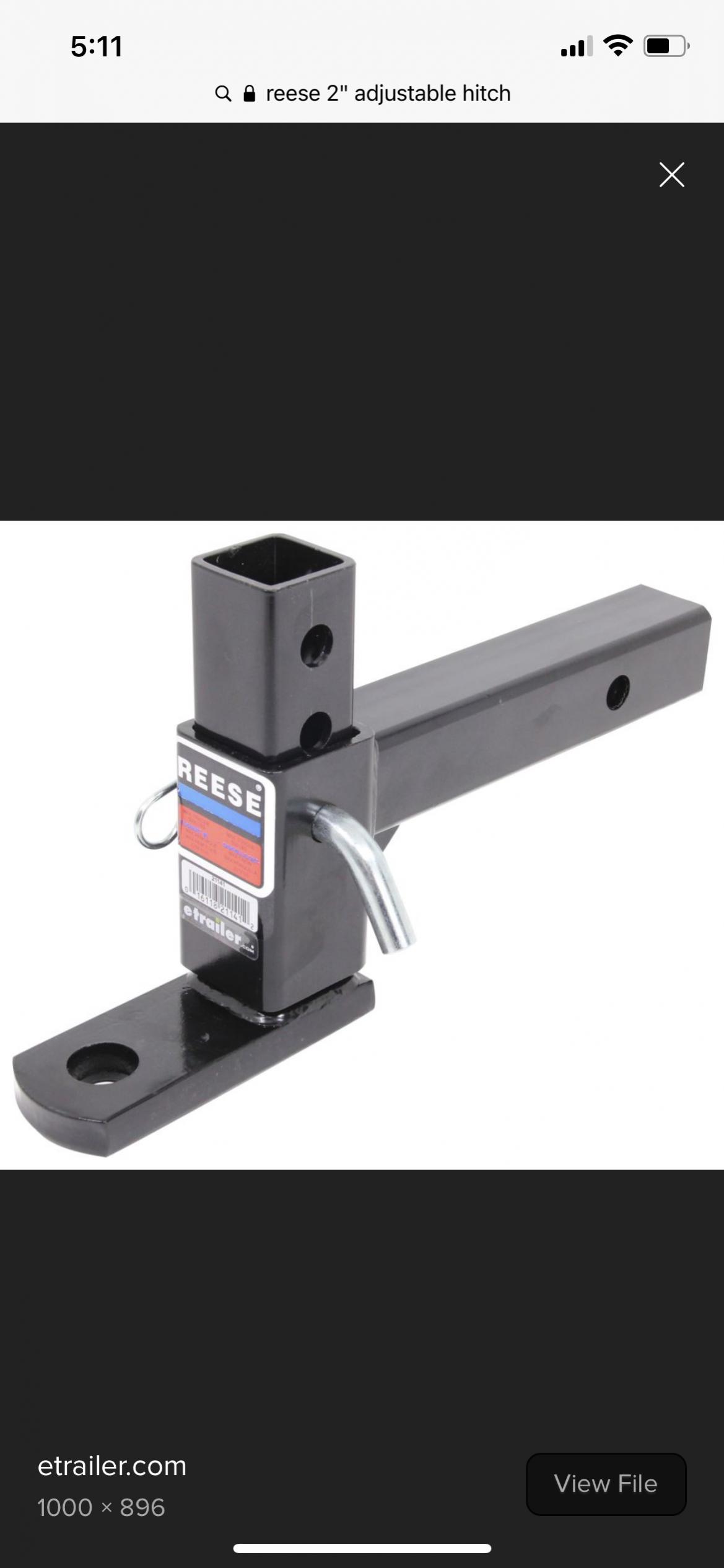

For casual use adjustable hitches easily align your receiver height (off the ground) with a trailer ball socket height off the ground.
My 5th gen has the simple factory 2"receiver so I added a 2" hitch (found on Offer Up for $15).
