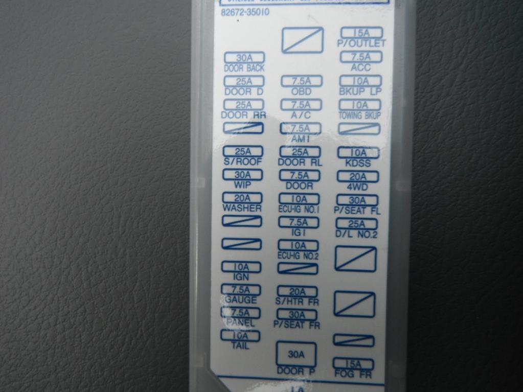

What fuse do use if you want to hardwire a radar detector?
I have the hardware cable and add-a-fuse.

You can use that mini-tap in the P/OUTLET fuse in the driver's footwell fusebox. This will give you power whenever the ignition is "on" only. It's the upper right fuse...
