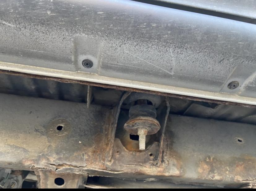

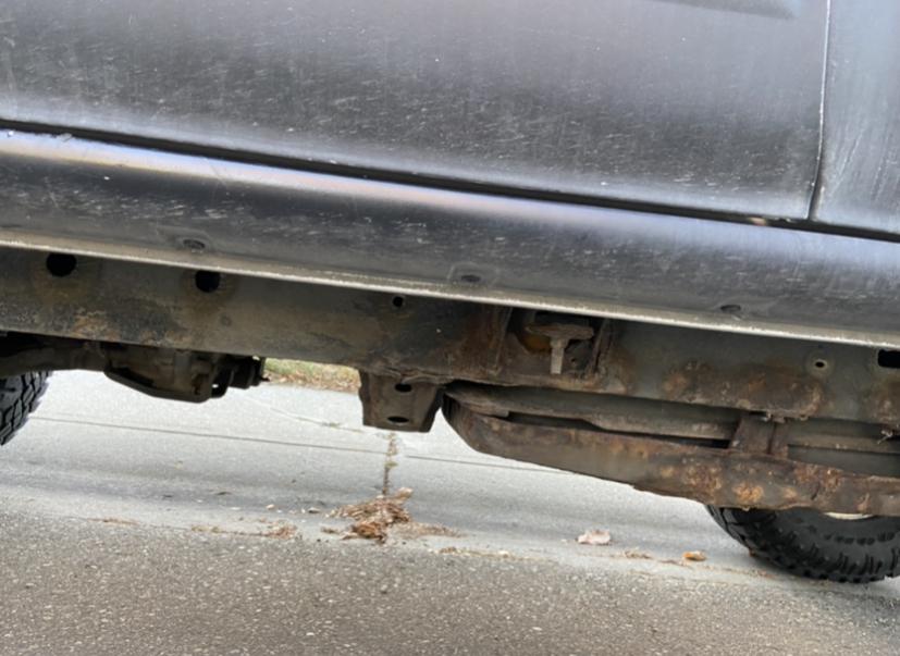

1) A little surface rust underneath, what is a easy/best under coat option? I’ll try to add a photo

There’s tons of undercoating stuff out there. Literally tons. I myself have not done any of that so I can’t give you any advice:

If you don't have any severe rust I would take a wire wheel+brush to it, maybe sand it if needed and paint it again, and be sure to use a rust converting/reforming primer. Best to nip it in the bud outright. If you're lazy you could look into stuff like POR15 (literally stands for paint over rust) but I've never used it personally. If you guys use salt like most out that direction I've seen great things about Surface Shield from Blaster

They don't call rust "cancer" for no reason.... if you don't actually Address the rust, as in either convert it with a chemical or remove it with physical means (sanding, wire wheel, blasting) ~ it was simply grow. Whatever you do, avoid the heavy rubber undercoatings as they only serve to seal the rust in place and give it a nice protected environment in which to continue eating away the frame (body panels, etc...) Plus it makes it Really annoying/hard to work on your vehicle later if you coat fasteners.
I like to use a rust converter, this is my personal weapon of choice: Amazon.com: Corroseal Water-Based Rust Converter Metal Primer, Rust Converter - 1 Gal,82331 : Automotive
And then hose everything down with a more liquid based undercoat such as Fluid Film (though PB Blaster brand has something new that looks to be an evolution in a rather static market, called Surface Shield).

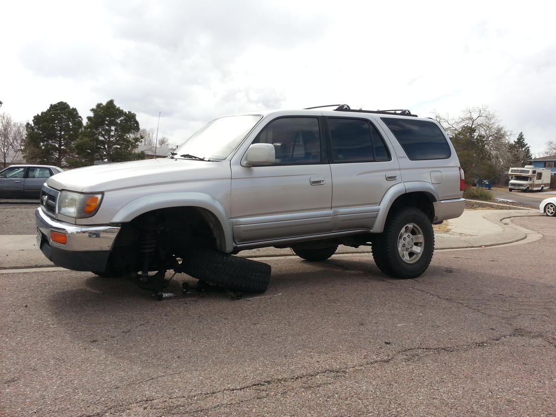

As for the rest? Maintenance. #1, replace the lower ball joints. They have a fairly high failure rate (bad design). and when they fail the wheel falls off. Buy nothing but OEM here, both the balljoint AND the fasteners. #2 is the radiator. It handles both engine and transmission cooling and the separation between the 2 passages tends to fail unless the coolant is flushed regularly and replaced with only the proper coolant, when that does happen the 2 fluids mix and the transmission fails. These are the top 2 killers that can be prevented for very little money and time.

Great info here, print out Brian's post and run it like a check list. I'm going to underscore his points about Lower Ball Joints and the radiator. Failure on either can be downright catastrophic to 3rd Gens.
The LBJ design was poor, and with enough wear the joint will actually separate and possibly pop out of socket and fold your wheel up into the wheel well. Just google "3rd gen 4runner lower ball joint." You'll see the part in question and some nifty results of failure. Replace with OEM only, no Moog or Rock Auto substitutes.
If the radiator looks to be OEM original issue, highly consider replacing it. As mentioned, there is the potential when the core corrodes and fails, coolant can mix with transmission fluid and kill the trans.
I do the exact same thing except I spray all the bolts and harder to reach spots with wd-40. After spending who knows how many hours under this 20+ year old truck I never want to deal with rusted bolts again. It will save you hours of time and quarts of blood in future repairs lol.
