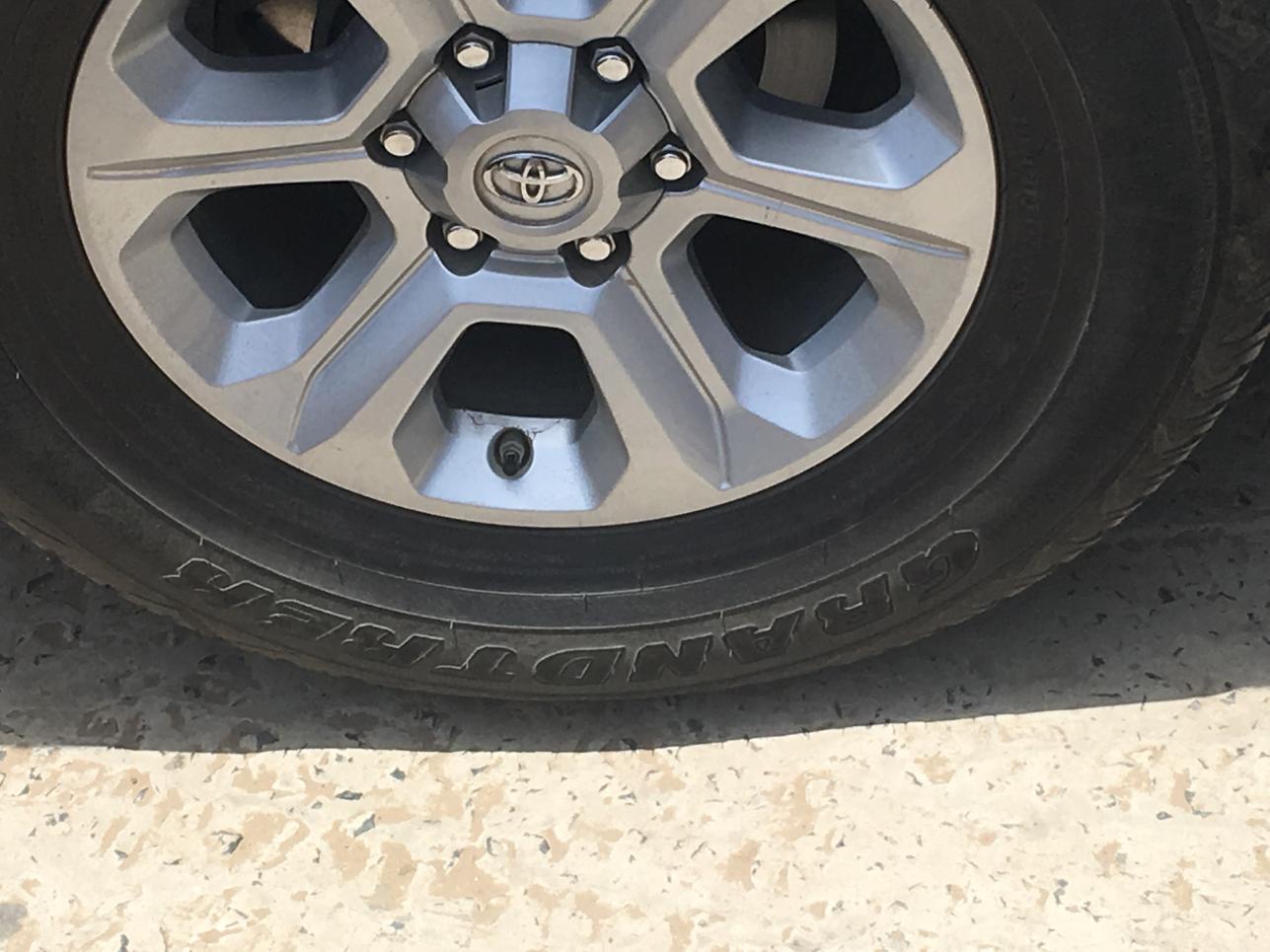

Are the tires really supposed to be like this?
Mine (stock) 2019 SR5 came at 49 PSI?!
Today I took it down to 39 and the tire looks flat'ish. Have a look at picture. Not sure I want to take further down to 32psi - which toyota recommends (and I certainly am not trying to second guess their engineers..) So i wonder if I am doing something wrong?

It is impossible to determine if a tire is low (or high, for that matter) by looking at it unless it is virtually flat.
Old school bias ply tires would look low when they were low.
