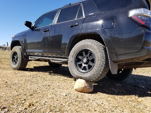

I used to roadrace motorcycles and we used a 10% guide. PSI 10% higher when the tire was at operating temperature over cold. I still loosely follow this. A lower psi heats up faster and more than a higher psi.
Where I live we have a 100° temp swing between summer and winter. Plus we live many miles down dirt/mud roads.
So I personally run 35 psi summer (up to 120°) which warms to 38 psi.
Winter (down in the 20°'s) I drop to 30 psi to warm the tires more for better traction. Also helps when driving through muddy washes.
Offroad I go as low as 15 psi, like in the photo.
