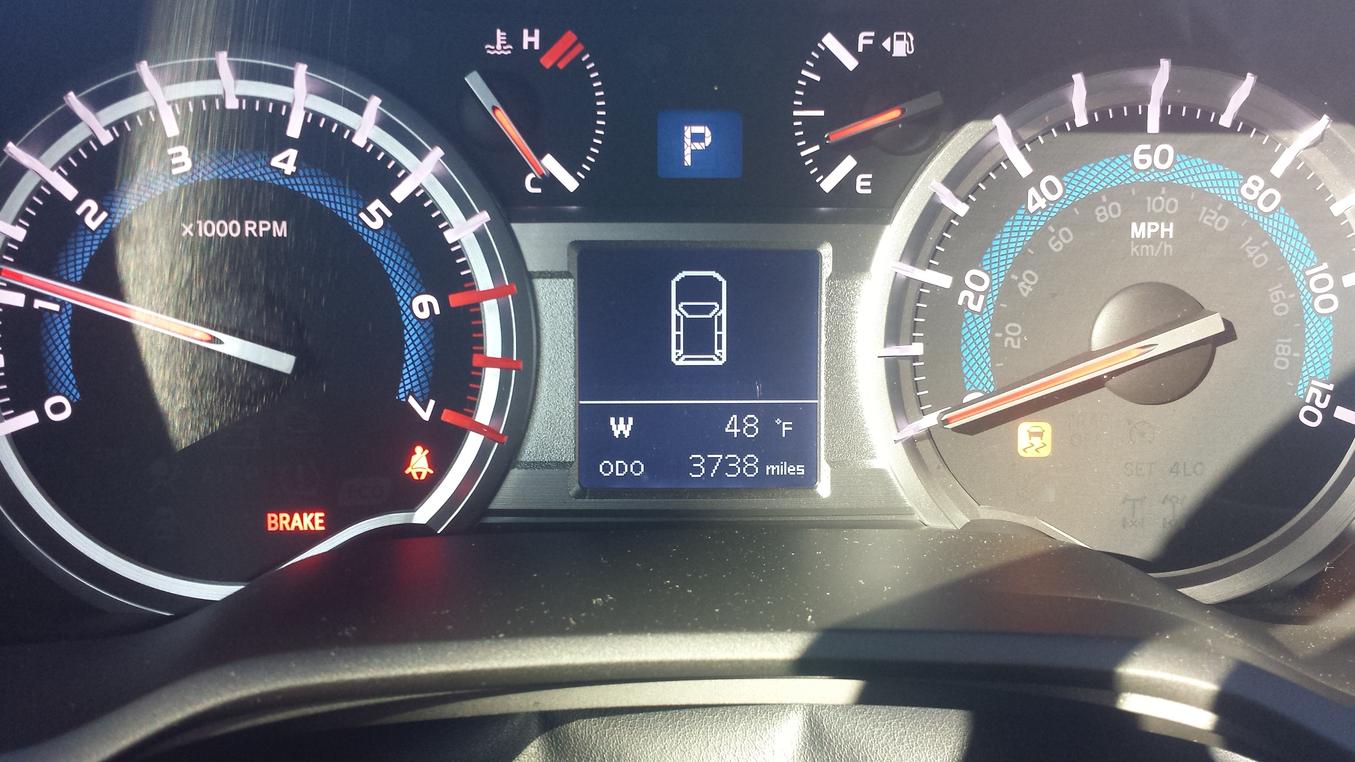

Story: Moved my 5100s up to 2.5", broke Left-ABS Harness due to over stretching/pulling. Dash threw: ABS/SLIP LIGHT/4WD-BLINKING/CENTER DASH DISPLAY DOES NOT PICK UP TWO FRONT WHEELS(SAME MODE WHICH SHOWS WHICH DOORS ARE OPEN).
1. Took multimeter set on continuity and tested both ABS harnesses. Right side is fine. Left side did not pick up anything. Spliced ABS harness, soldered and wrapped new wires. The following lights went off: ABS/4WD BLINK. Following lights stayed on: SLIP/DASH STILL DOES NOT SENSE FRONT WHEELS.
2. Performed Yaw Zero-Point-Calibration word-by-word several times. Does not remedy this. We performed the Yaw ZPC on two 2011 Tacoma's which we lifted the same day, and it worked for those trucks.
3. Purchased brand new OEM Left-Side ABS Harness. Installed. SLIP LIGHT is still on and wheels are not picked up. Performed Yaw ZPC several times. Does not clear any of this.
4. What is next? Should I purchase a brand new Yaw sensor? Truck has 3700K miles on it. I replaced the only thing that broke during during the installation of the shock assembly, the ABS harness. I'm really stumped. Feels like the truck is on a limp knowing I cannot use ATRAC or any of those option.

This whole time I was just doing the YAW ZPC but wasn't following up with the DAC calibration. Funny, my buds Slip Light came up after their lifts but just did the YAW ZPC and it cleared the light without doing the DAC calibration. Maybe this applies to 4Runners only?
Now that the Slip Light if off, still need to find out why isnt one of the dash modes isn't picking up the wheels. :snacker:
