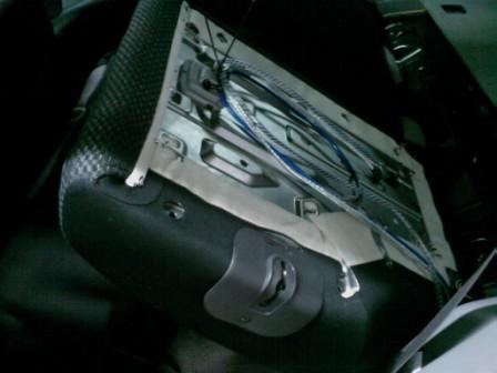

1 st, I am placing my amp on the driver side rear seat back. I took everything off and you can see the power cable and the patches.

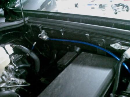

I then ran the amp power cable OVERHEAD and then down the a Pillar into the grommet thatgoes through the firewall and then to my fusing for to the battery.

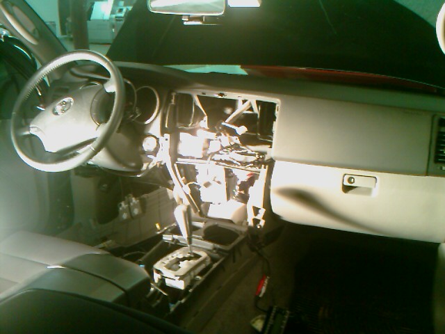

Here is the dash all pulled out. I learned a couple things:
1)My spotlight is super hot and Wet Okoles can burn, fortunately, the jsut seemed to smoke, no marks!
2) All the extra BS they sent me fo rthe mounting kit was crap. I took the mounting brackets off the stock HU, screwed them to the new HU, then cut the trim plate that goes on the face of the HU to match teh opening and voila, it was freakin awesome. I didn't need any of that other BS they sent. The wiring harness was the shiznit though.

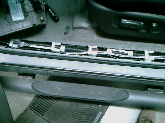

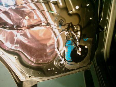

OK.... Dynamat in around the speaker holes. I figured this would provide a nice surface for the adapters, both front and back. I will take what I have left over and strategically place it where it goes best. It is weird riding around in a vehicle with no panels in the front. You hear everything.

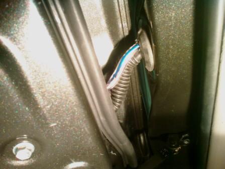

This picture is the wire fed through the grommet for teh driver side rear speakers. I could not get it through the actual tubing already there, so I cut holes in bothe grommets and fed the wire through. Once it is all together, I will shronkfit tubing around it and make it look factory.

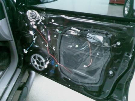

Netx pic is rear door with dynamat as well as teh speaker wire coming through. I am not leaving it there. I am just done for the day.

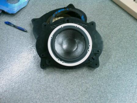

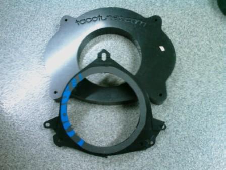

Next pic. I made washers out of dynamat for contact with teh speakers and teh adapters. I am using Tacotunes 6x9 to 6.5 adapters on the front. Nice! I put dynamat on teh rear of teh speaker adapter as well, where teh contact point is the speaker to teh adapter to teh tacotune. Here:

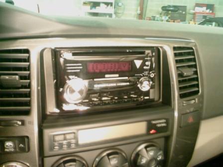

Not the best pit here, but you can see the HU install. It looks like there is a gap on teh far side but that is a shadow. comments?

Lookin good. Is there a speaker adaptor for the tweeters? How are you going to mount the tweeters for the rear?

OK... The speaker adapters that both Crutchfield sent as well as he adapters that came with teh Polk SPeakers were too much for teh front, so I directly mounted them to the tacotunes adapters. You will see this in the picture, sorta, and note that I made my tweeter adapters out of THICK MDF. Wasn't too bad, but mounting the flush mount cups in that was tough.
