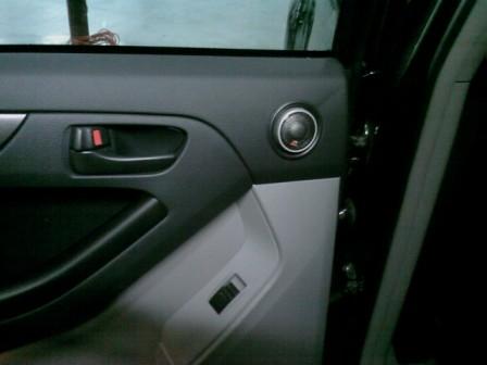

Front door went in nicely, so no need to post a piocture to see what you already know. I did flushmount the tweeters in the rear. That was pretty easy and looks a whole lot better than surface mount.

Looks great - especially those rear tweets.
