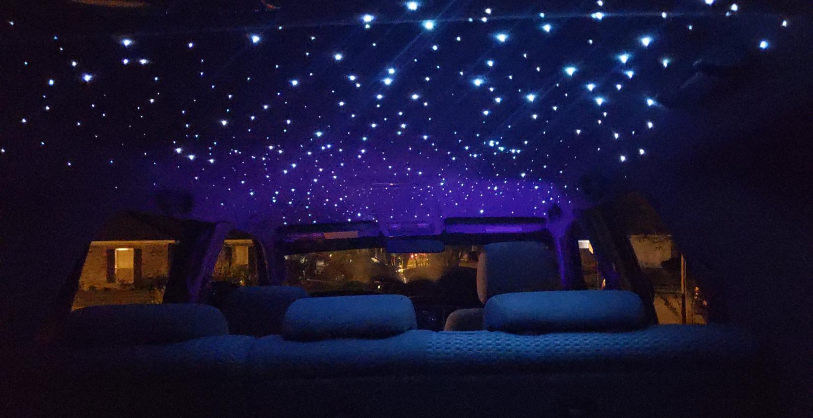

Which arms would you recommend? And thanks for replying, I’m really excited to start with this, I’ve aready tinted the windows and I finished my headliner a couple weeks ago!
