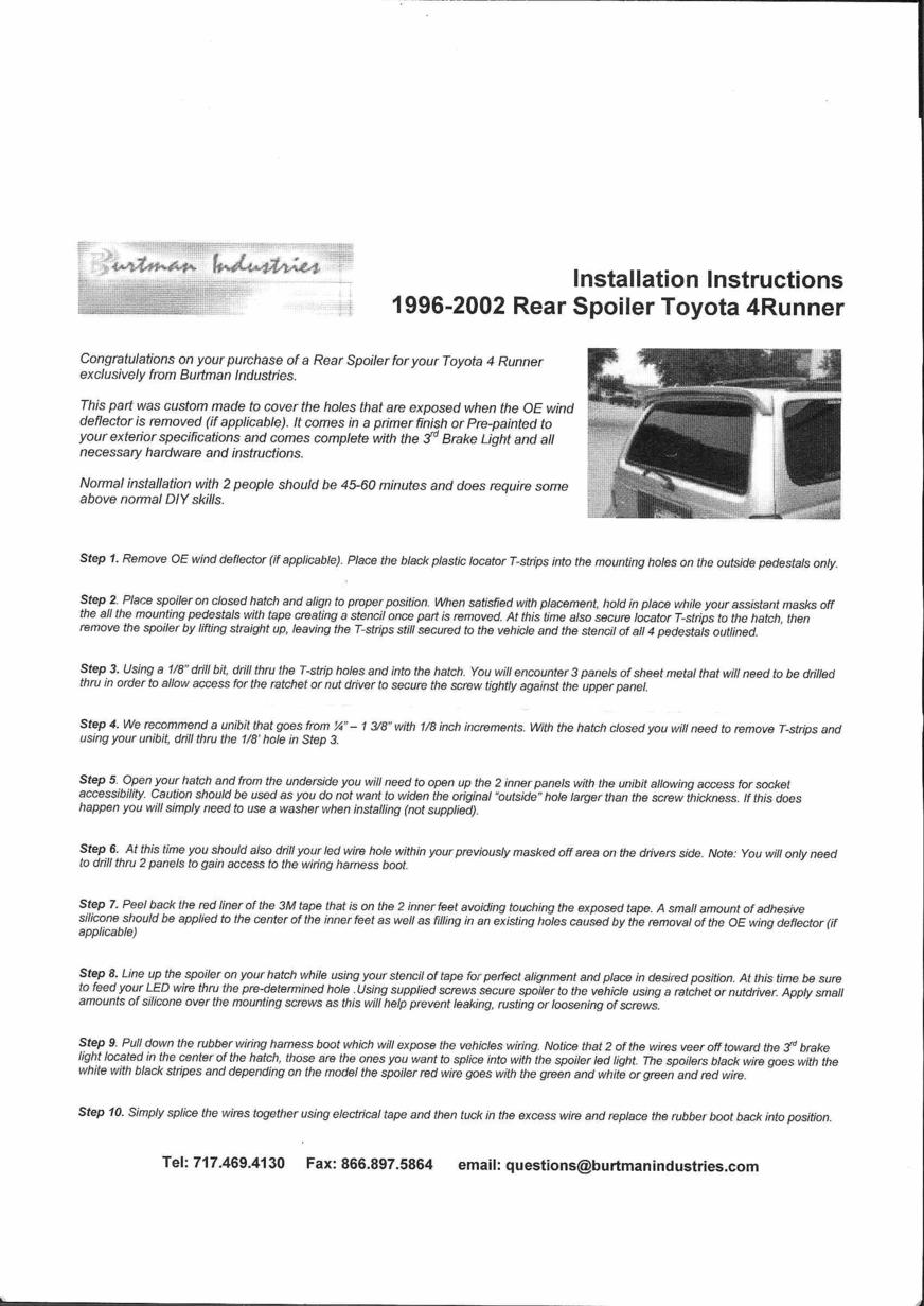

So are you using self tapping screws to drill from the backside of your hatch into the metal plate molded into the spoiler???
98piranha
the answer to your question is yes - also the below are basically the instructions that came w/ the spoiler:
I am very happy w/ it and it really does it give the truck a new sporty kick ass look.
Rob
There are 10 steps in the instructions - Sohere is a summary and you can call jason or e-mail him at 717-469-4130 or [email protected] or [email protected]
put spoiler on closed hatch and use t-stips to stencil the 4 pedestals outlines, use 1/8 " drill bit to drill through t-stipand into hatch (recommended to use unibit that goes from 1/4" to 1 3/8 w/ 1/8 inch increments, open hatch and open 2 inner panels for socket accessibility, drill your led wire hole within your previously masked off area on drivers side (this is where the shop i took it to didn't follow the instructions), peel back red lined 3 m tape, small amt of silicone should be applied to the corner of the inner feet as well as existing holes caused by removing toyota oem rear deflector, line up spoiler and feed led wire thru predetermined hole, using suppiled screws secure spoiler to vehicle using a rachet , pull down rubber wiring harness boot which exposes vehicle wiring - splice the 2 wires that veer off toward 3rd breake light - the spoiler balck wire goes w/ the white & black stripes (or depending on model - the spoiler red wire goes w/ green and white or green and red wire) - splice wires together, use electrical tape and tuck in the excess wire and replace rubber boot back into poistion.
Like I said - I didn't install it I had the body shop do it because I needed to have my truck fixed in 2 other spots so any questions on install; please call or e-mail Jason or check out the burtman industries website - I think he has pictures/ details on install on his site.
Burtman Industries
instructions to install spoiler
instructions
